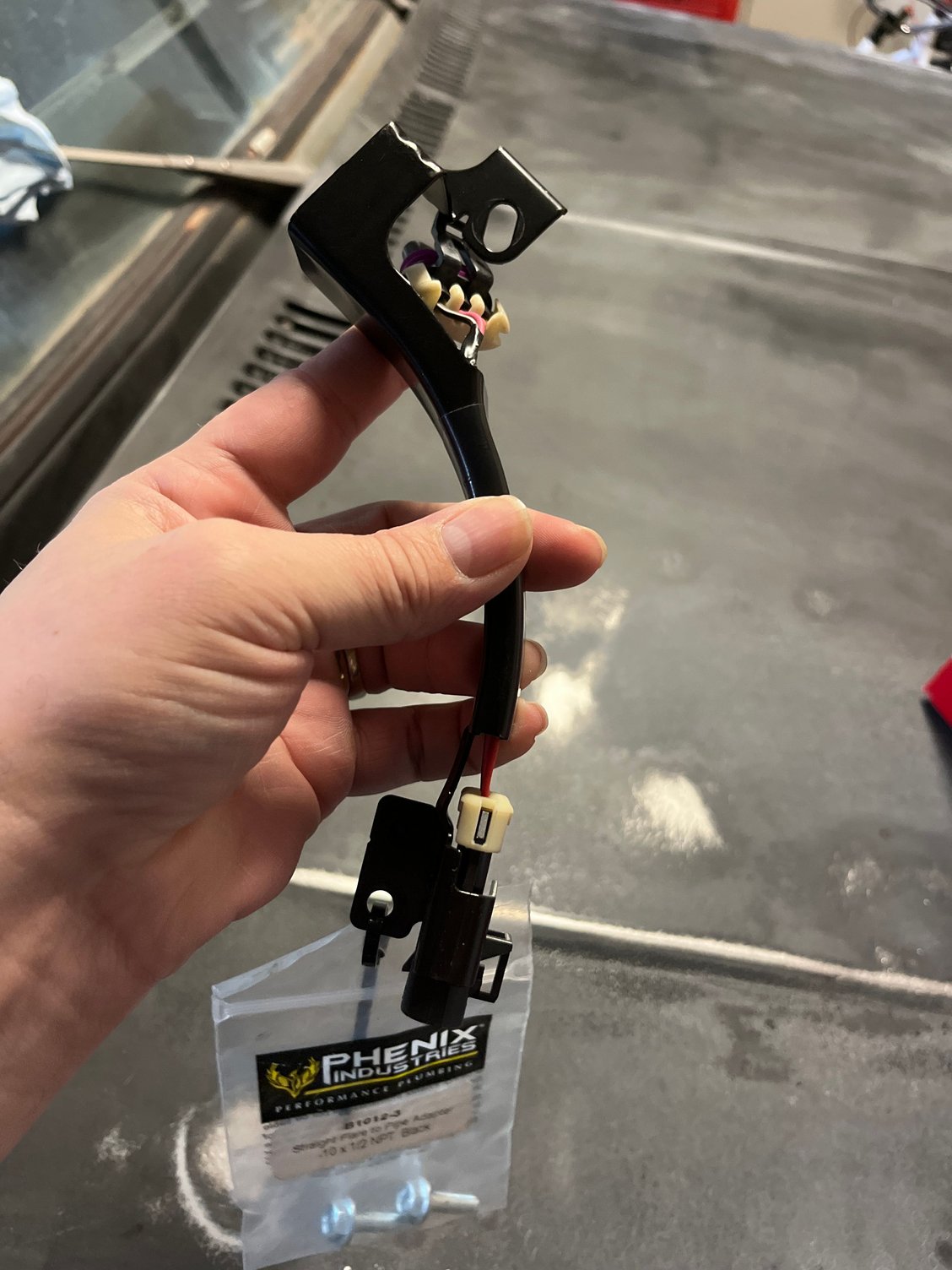

does that extentsion with the cam sensor wires swapped plug dierectly into the cam sensor or did it go into the bracket sub harness on timing cover??
Do i want to disregard this piece and just plug straight into the cam sensor……im only asking cause i have a fresh built L96 for when my 370” LSA lq9 goes kaput!!!…….or the lm7 in the c10 in this pic gives up the smoke……thanks in advance
You want to plug straight into the cam sensor.
