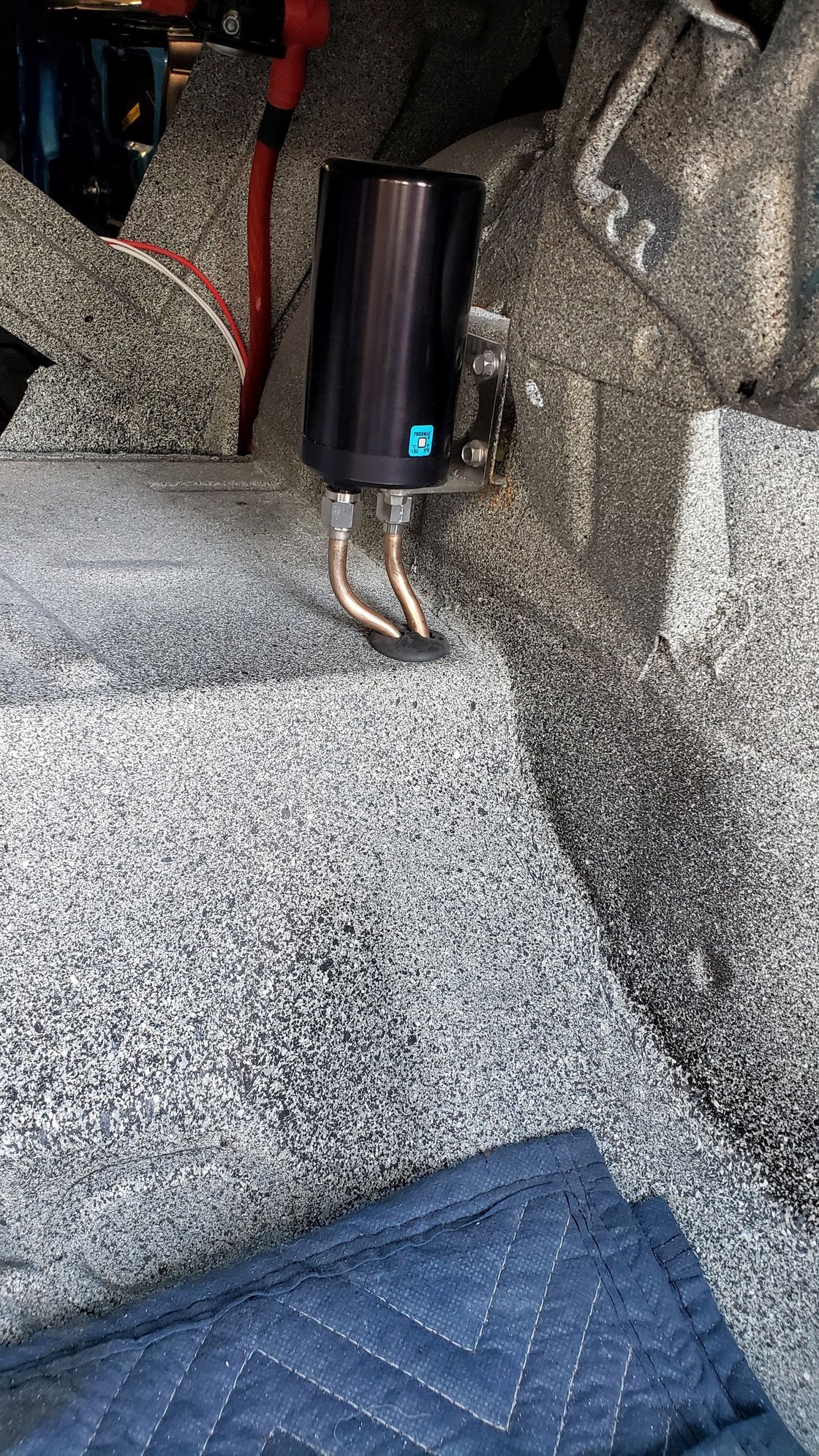

With the Tanks inc tank you also will want to run a extended hose on the vent up into the rear spring perch’s. A vented cap can leak during acceleration. When you fill that tank full it’ll leak out the vent.
I'm actually running the vent up to bulkheads through the trunk floor into a II MUCH (https://www.iimuch.com/collections/f...ts/fuelvent2dm) vent, then back out through a bulkhead to a sintered bronze filter.
Mine is done this way and is working great, no fuel smell in the garage at all.
