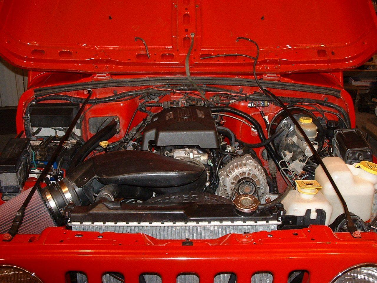

My LS6/4L60E swapped 98 Wrangler intake looks like this. It's a 2002 LS6. First pic is the LS6.

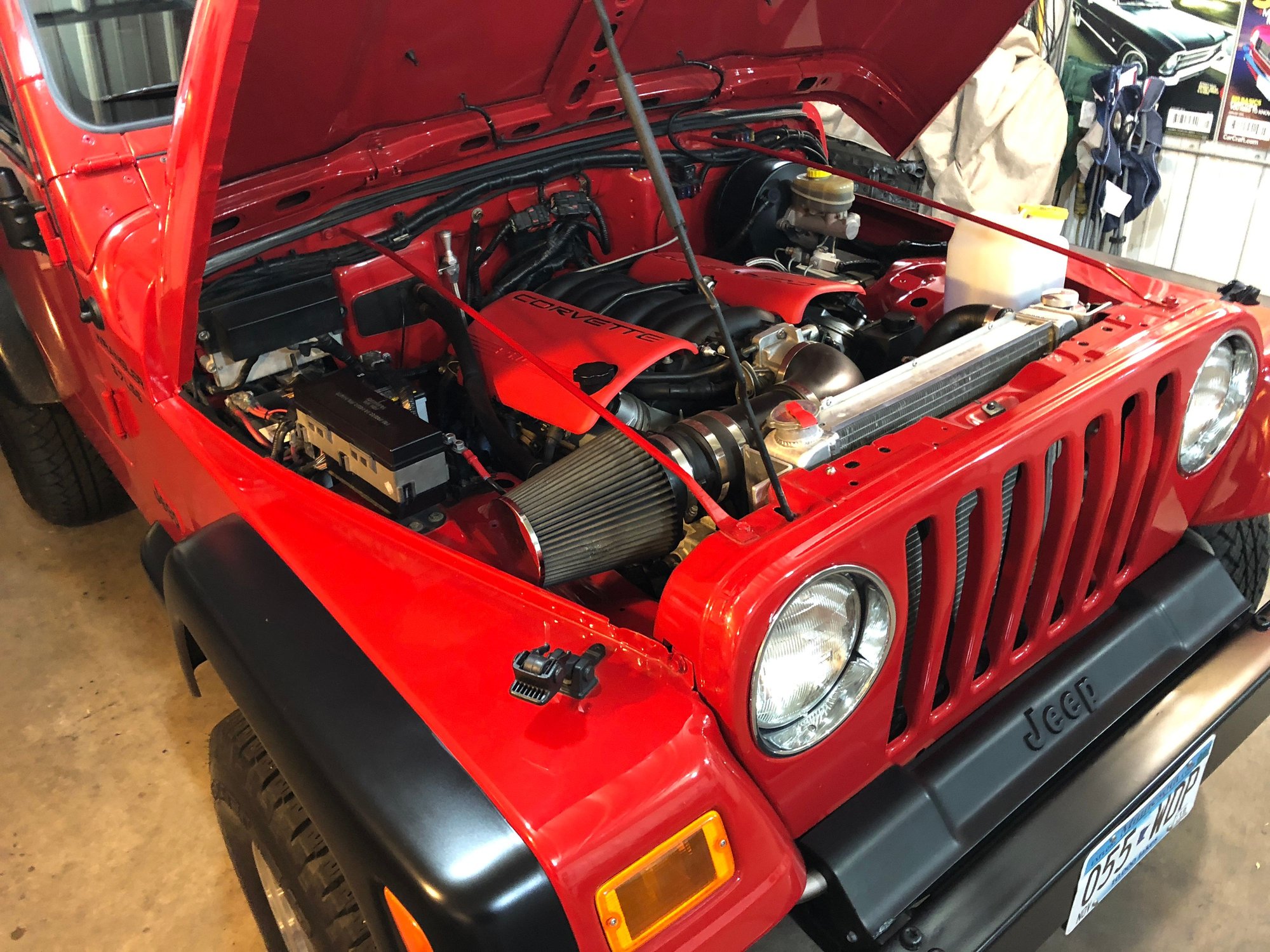

Second pic is when I had the 4.8 in the Wrangler using stock GM truck stuff.
Both worked well.
Old Oct 16, 2022 | 04:08 PM
RandyDN's Avatar
Joined: Jan 2021
Posts: 12
Thanks for the Pictures. I am going to move my MAF further away as it is currently about 3" from the butterfly.
