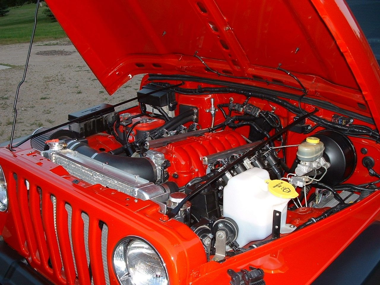

My .02.
My first 98 Wrangler LS swap was a 4.8/AX15 swap (16 years ago). Completely stock 4.8. I used a 255 Walbro and a C5 FFR. Ran great. I didn't even tune it. Pic below. Stock GM truck intake with the K&N air filter right in front of the mass air sensor.
Couple years later I changed it to a LS6/4L60E combo. Air filter right in front of the mass air sensor. 14 years no issues. I did have it tuned since I had a small cam in the LS6.
One thing about the oil type air filters when they are new they sometimes have a bit oil comes off the filter and coats the wires of the mass air filter. The oil coating messes up the mass air flow sensor reading. Maybe clean the mass air wires?
What I have read that the mass air should be more than 6" from the throttle body.

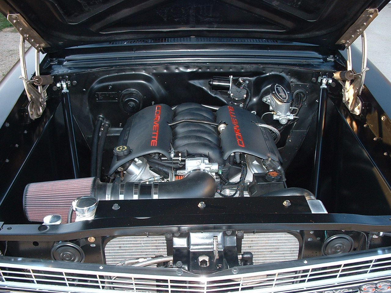

The black Nova was a 427 LS with the air filter right in front of the mass air. It did require a tune and it ran great.
