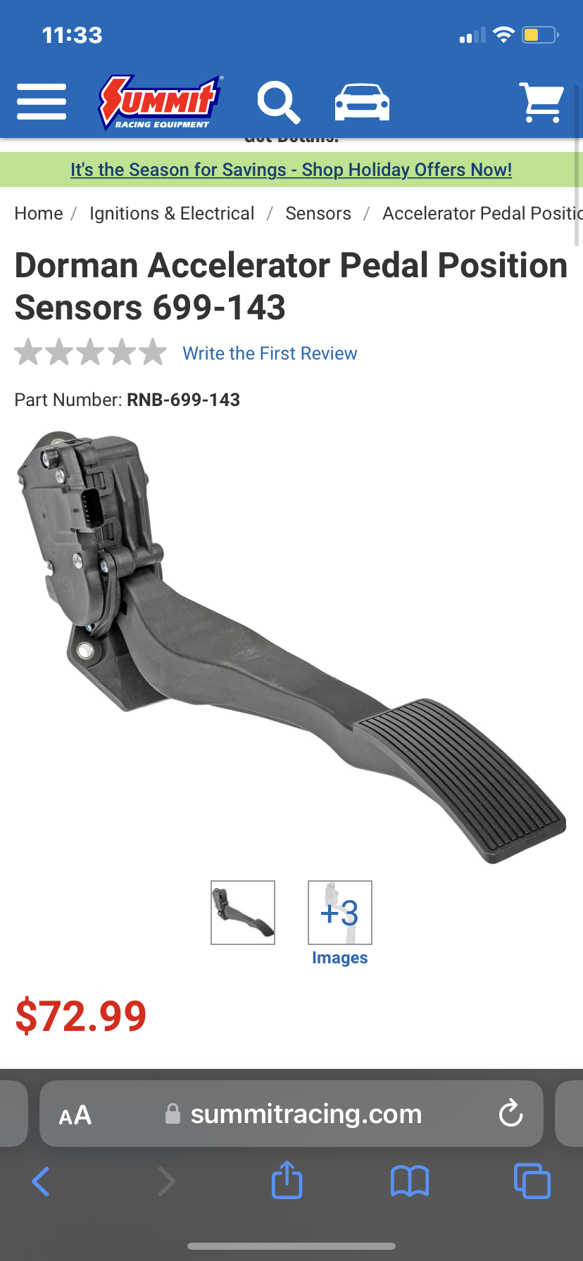

this is my 1st post here and my 1st LS swap. I’ve gotten to wiring and I’m having trouble with my gas pedal. I have a Gen 3 2006 5.3 with tac module and wiring. I saw that the Gen 4 could use the impala pedal after being repined. Does anyone have any experience with this or know how to get this tac to work with the impala pedal?

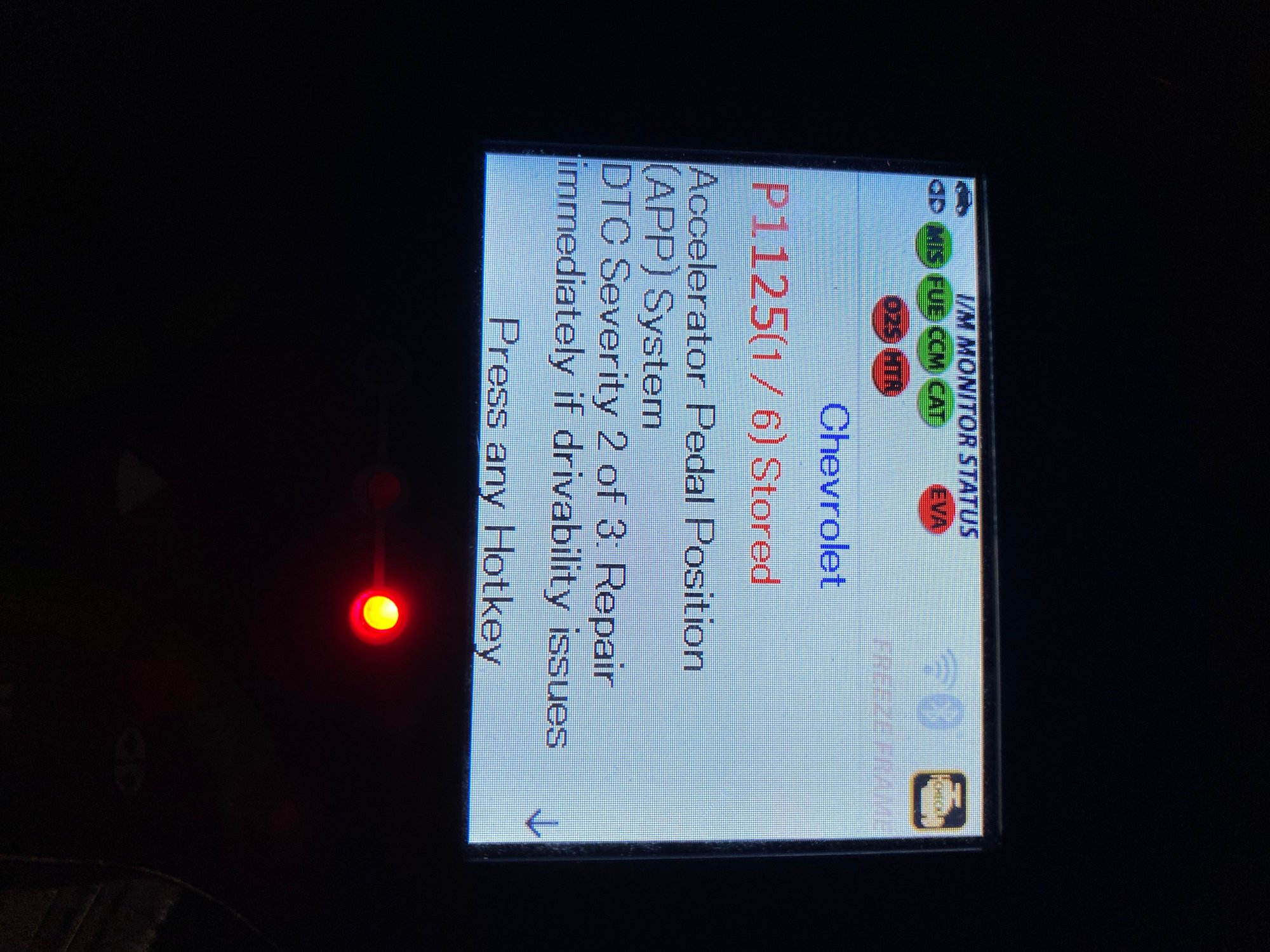

I’ve tried 2 different TAC models and 3 different Impala pedals. I keep getting the same permanent and pending codes: p2138, p1125.
I tried moving the pins around on the pedal harness and still get the codes. When I’ve tried to start the car, it will fire and idle I just don’t have any pedal response.

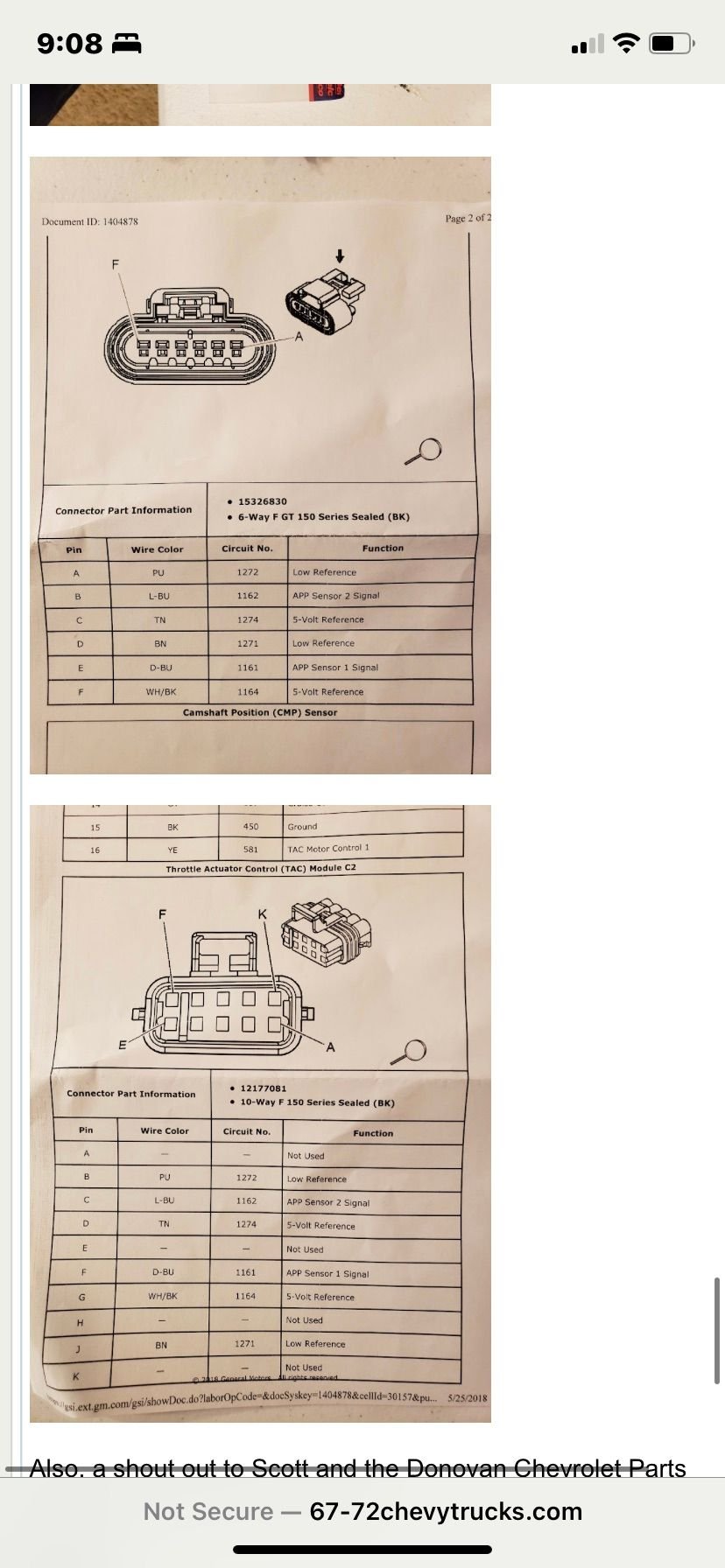

I’ve added photos of the schematic I used to wire my pin. Hopefully someone else has run into this(and I explained it correctly).

Have you tried a truck pedal? GenIII's are more picky on having matching parts, so the GenIV Impala pedal may not work.
The truck pedal worked but created a new issue… How do I mount this pedal with the crazy offset? Has anyone mounted this pedal in their g body?

You would have to find a spot under the dash and build a bracket for it. It won't be where the factory pedal mounted, but closer to the column. You could make a plate that bolts into the stock location, then put a couple bends in it, towards the firewall, then bend back to the left, again nearer to the column, then mount the pedal to it. It would have to be pretty thick metal to keep it from flexing though. As an alternative, you may be able to get an older pedal that is metal and cut and weld it, but if you don't have access to a welder that's not going to help you.
