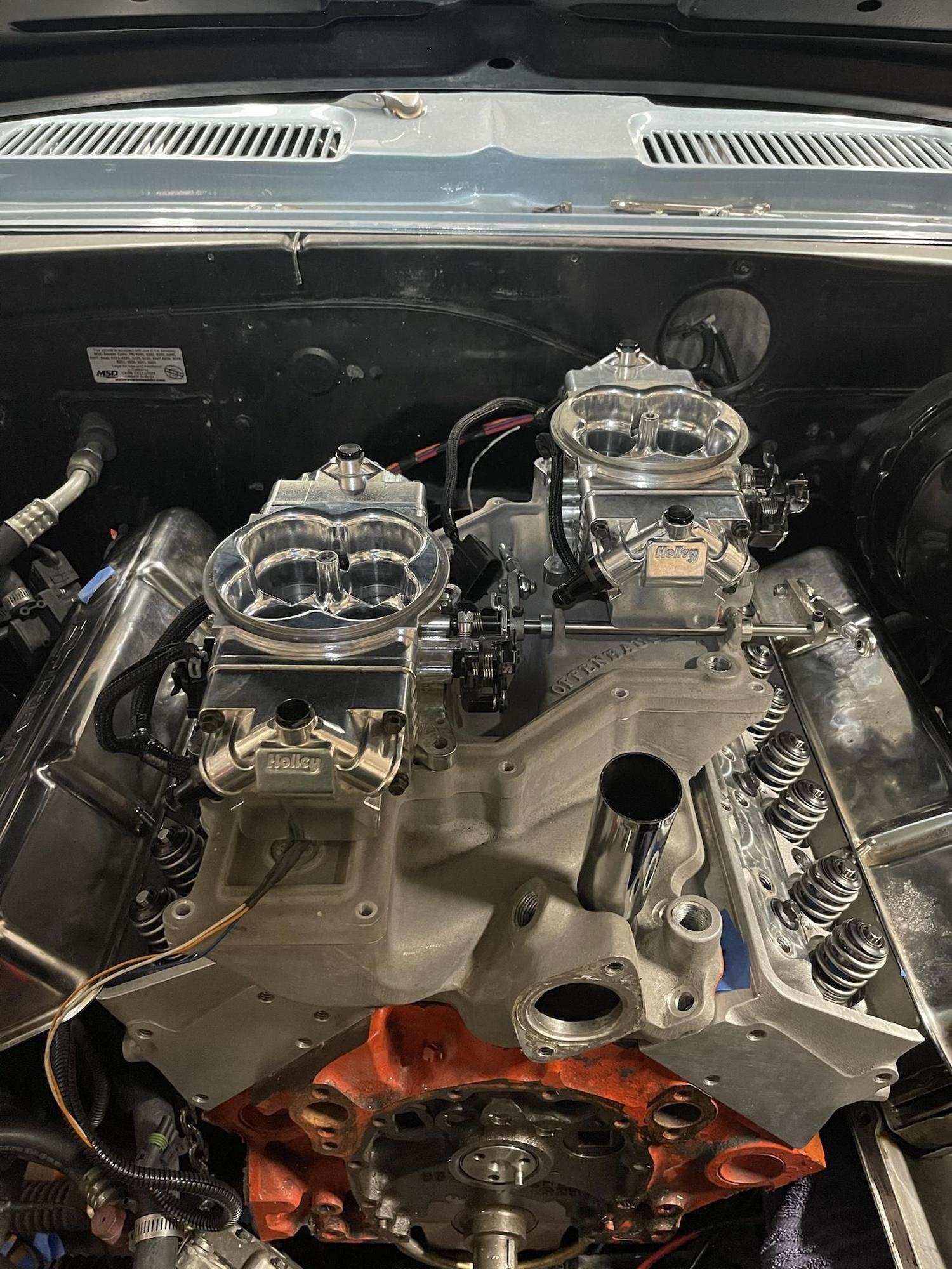

Originally Posted by YAAPP
Thanks BT. Did you swap a Gen 1 Camaro by chance?
yes, but I’m not ls. Just fuel injected my sbc.
Old Dec 30, 2022 | 07:51 PM
YAAPP's Avatar
Joined: Dec 2022
Posts: 26
Ver nice!
