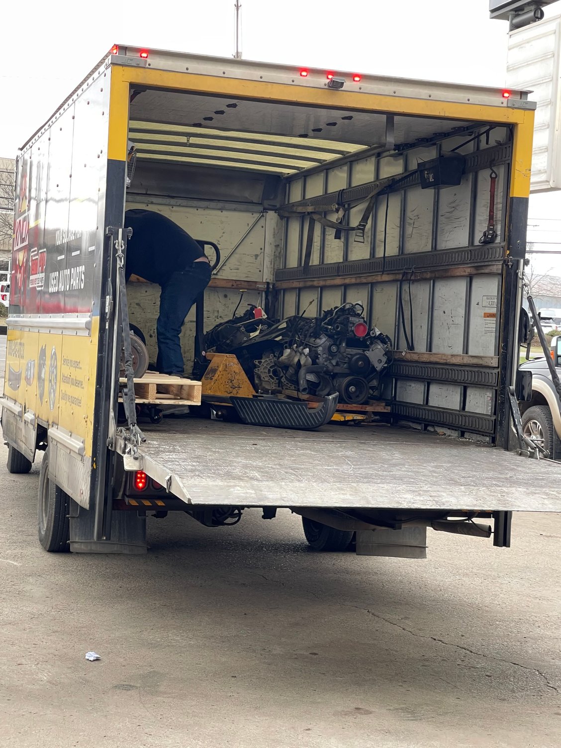

Hey guys. I have a 1967 Impala SS with the original 327 and 3 speed transmission in it. I’m putting a 6.0 LQ9 engine in with a 4L80E behind it.
so far, I have sourced the engine
ordered kwhizz adapaters
a BTR truck Norris cam
Holley terminator x max kit
a Holley dbw pedal
A tanks Inc 67 impala efi tank
a weld in pump mount panel for the tank from Rick’s tanks (this will allow me to use a factory GM pump)
and a vaporworx pwm system as recommended by the ls swap god kwhizz himself.
I’m still working on sourcing a transmission. I might just buy a new (reman) from advanced for 2k
still need a torque converter (BTR recommended 2400-2600 stall)
still need to figure out which mounts to use
still need to sort out the accessories plan. Car came with factory ac but the system looks rough.
do I use the factory compressor and system and retrofit it for 134a? Do I get a classic air kit?
Do I use the original power steering pump?
which accessory drive relocation kit should I use?
do I use the original radiator and add an electric fan? New system?
so many questions about all the little details.
there’s not many ls swap kits for 65-70 B body cars. I’m really excited about the swap. And definitely open to suggestions.

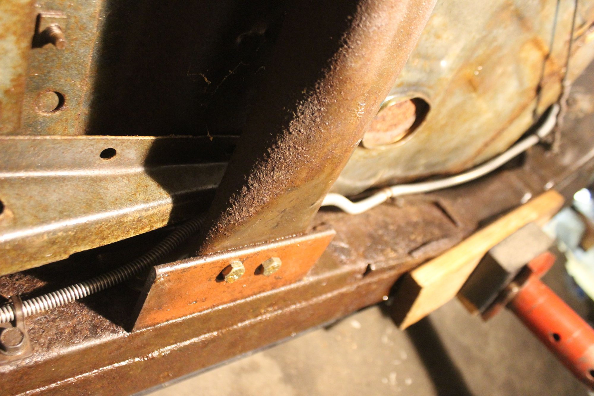

I'm using holley's terminator for my ecm and trans computer. Yeah I don't want to notch or damage the frame if I don't absolutely have to. Do you happen to have pictures of the trans cross member move?

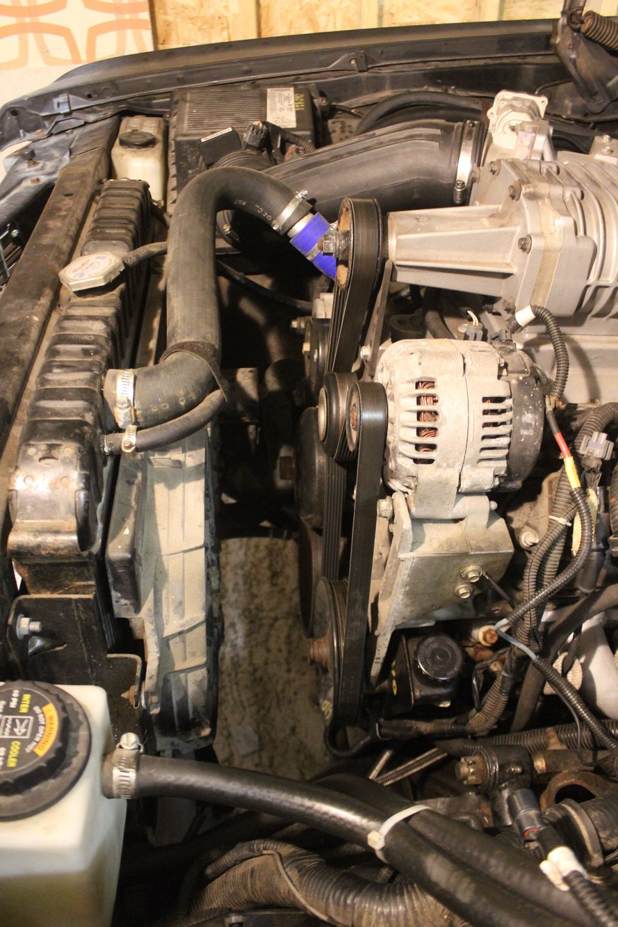

As for accessories, I have used the stock LQ9 accessory drive, without the A/C compressor. So nothing fancy, just simple and cheap (the accessory drive came complete with my engine). It was also easy for me to install the Magnacharger kit with OEM accessories. Since the LQ9 did not come with an engine-driven fan, I used a pair of electric fans. You can see on the engine pic the distance between the engine and the stock '70 rad, with the electric fans from a '95 Chrysler Intrepid (3,3l V6). For engine mounts, I have used Trans Dapt adapters.
As for my trans crossmember, it is really simple: I have removed the factory angles from the chassis, and welded 2 new pieces of angle iron a few inches back to mount the crossmember: why give some aftermarket company a few hundred dollars when your own crossmember is perfect for the job? On the pic, you can see the remains of the original angle bracket a couple of inches forward. The 4L80E bolts directly to the crossmember, with its bushing.

In the middle of a 68 impala swap 4l80. Term x max as well. Tanks inc with the aeromotive phantom mod. If you ever plan on running AC on the bottom don't shift the motor back. Drive shaft will need work. I had mine at 61" and it was too long. I'm waiting for the trans to get back from rebuild to have it shortened. exhaust is another story. Headers from Ultimate and dimpled to clear the steering box.

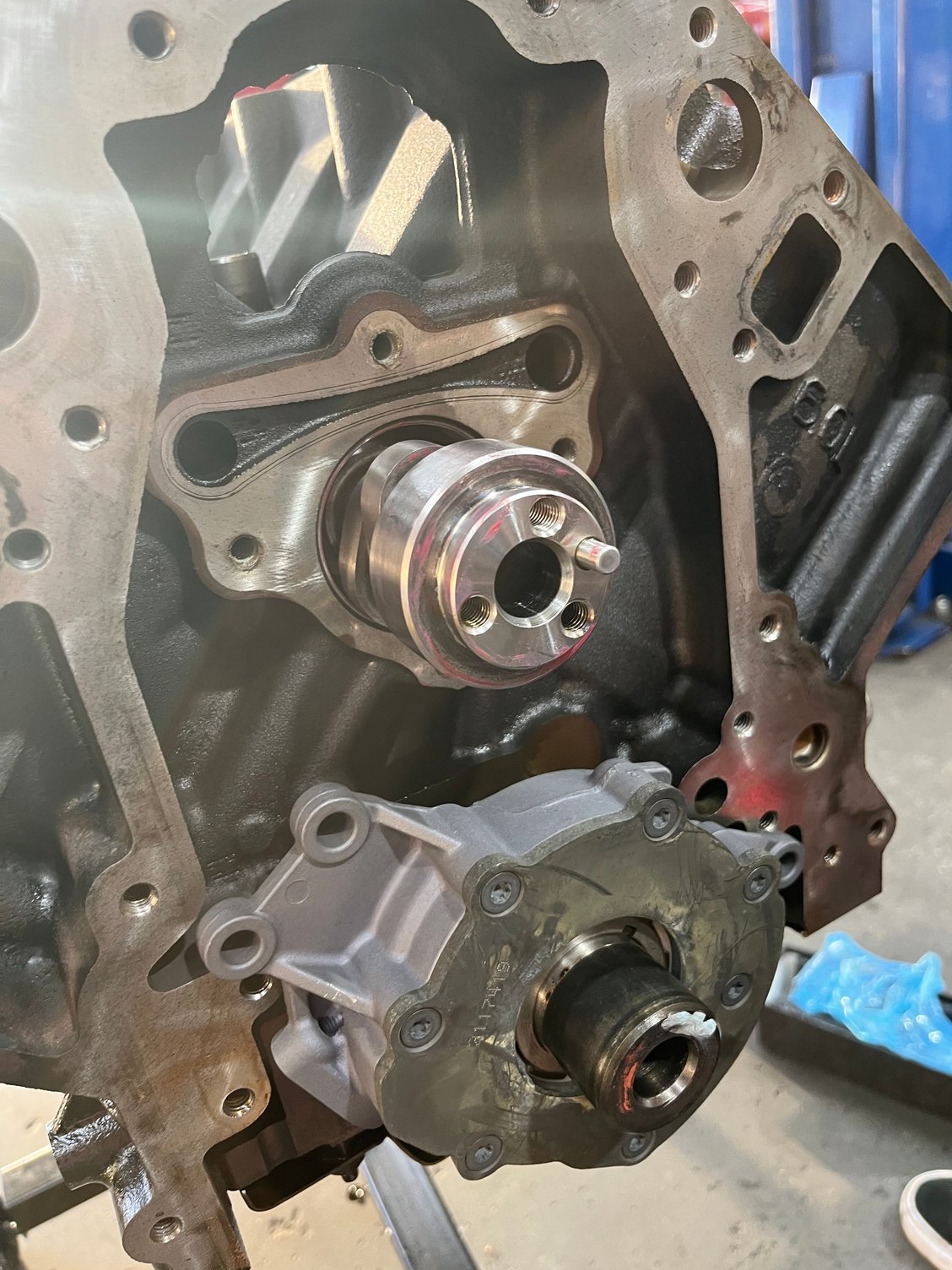

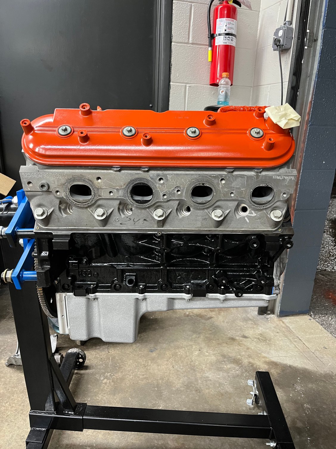

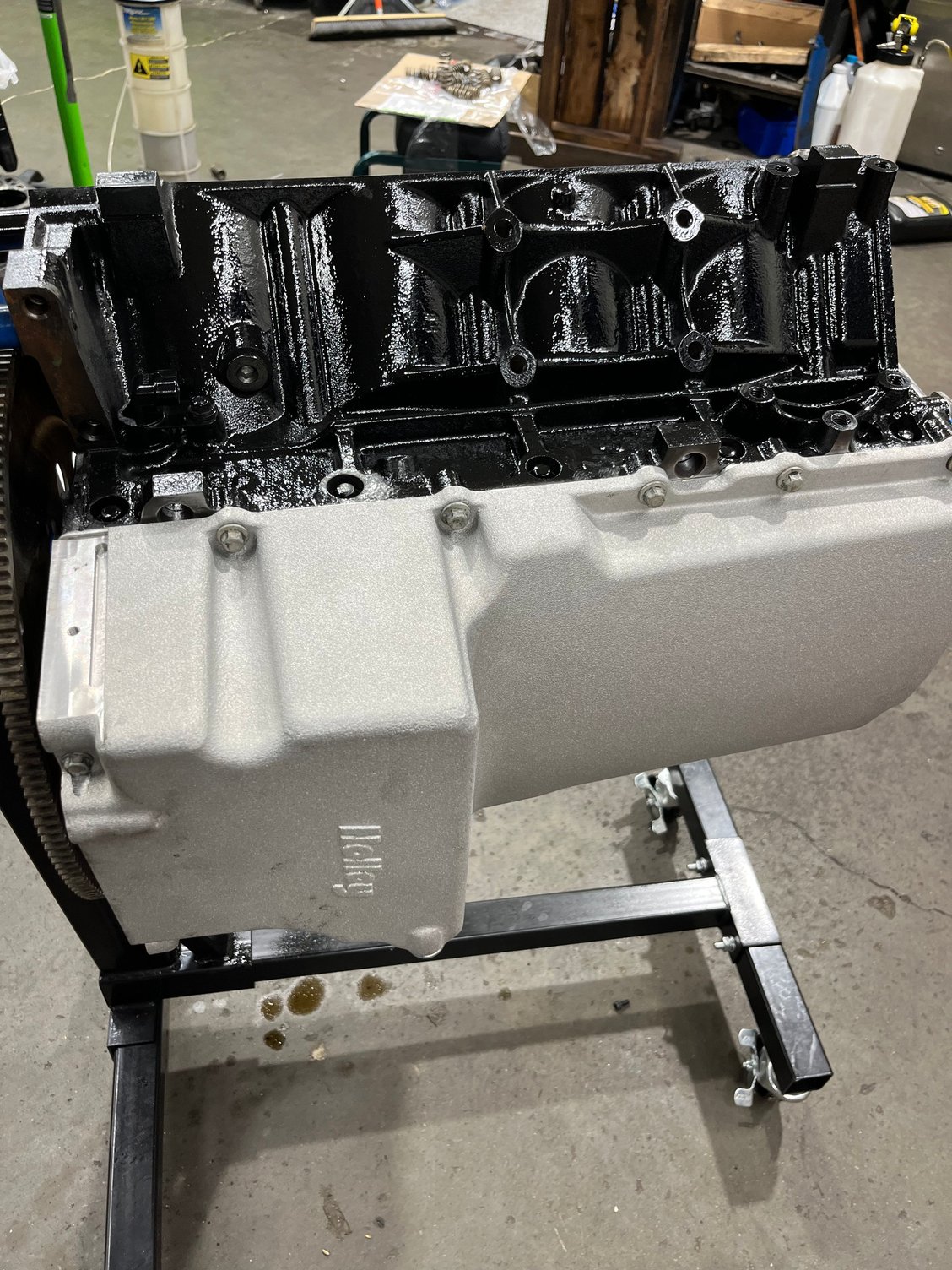

I see. Thanks for the info and the picture. Yeah I started thinking I could use stock accessories and now I know I can.
I plan on running the ac compressor on the passenger side like the stock one on the 327. I’m still working on piecing a system together with the vintage air catalog.
So I ended up ordering a radiator with dual fan set up that bolts right in to a 67 impala from summit.

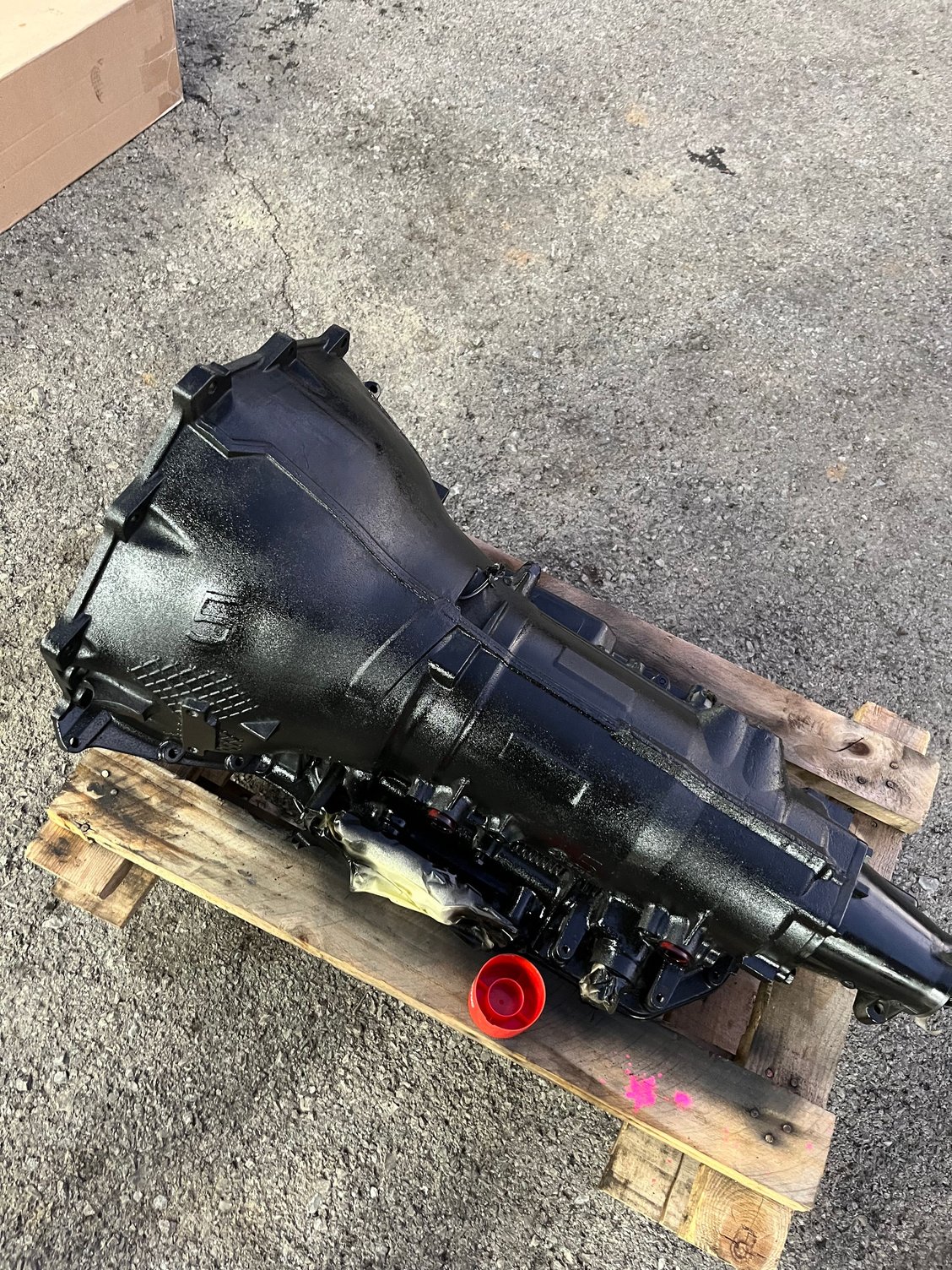

I had our local Mr. Transmissions guy rebuild me a stock 4l80e and he got me a 2400-2600 converter to go with it.
I ordered long tube headers from summit. Hope they go in nice and easy…
dakota digital instrument panel with module for Holley is on the way.
and I have a 4 wheel disc conversion kit also ordered.
My fuel system arrived. I need to order a pump from GM.

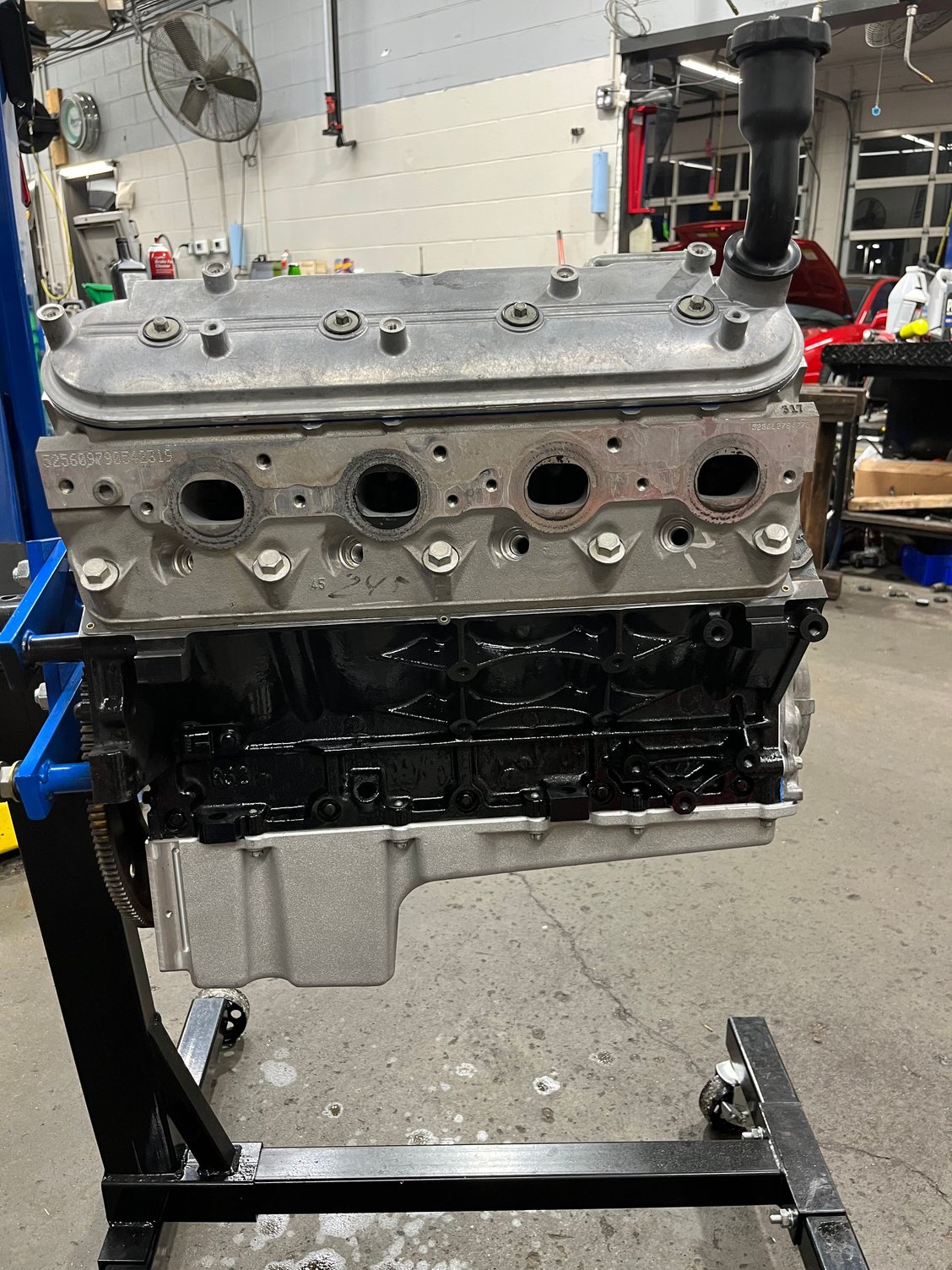

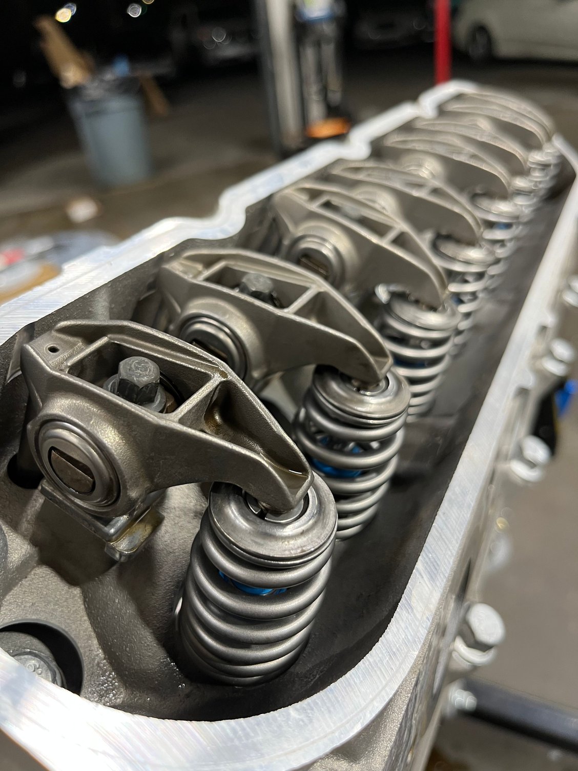

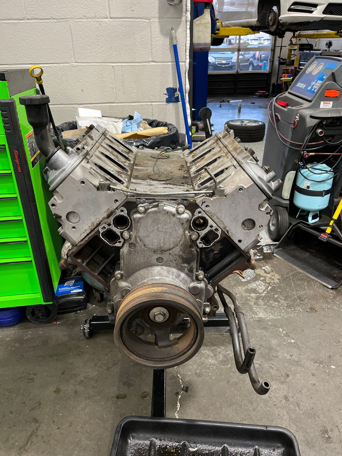

engine is pretty much back together.
BTR truck Norris cam. Also did a timing set.
Holley 302-1 oil pan.
New BTR springs
Little block paint just cuz.

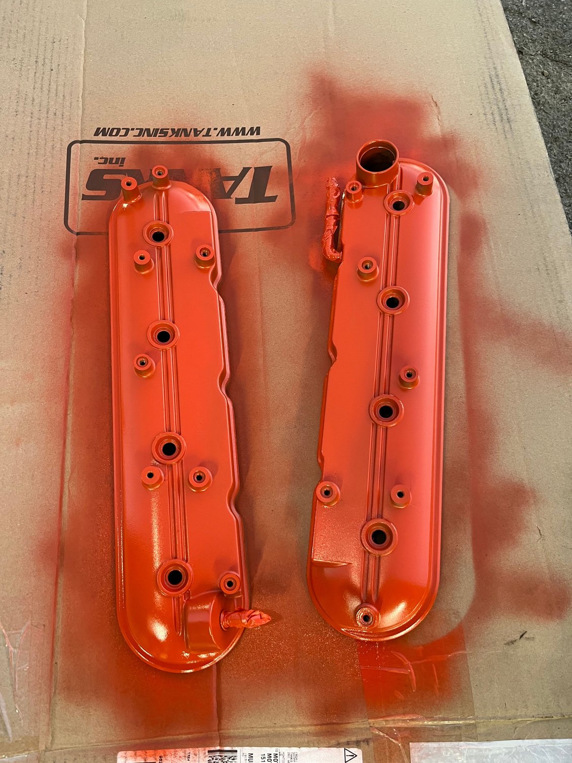

Didn’t get anything done today really. Just painted valve covers and transmission. I think I’m going to try to use stock 6.0 accessories with stock 6.0 set up. Long tubes should be getting delivered this week.
