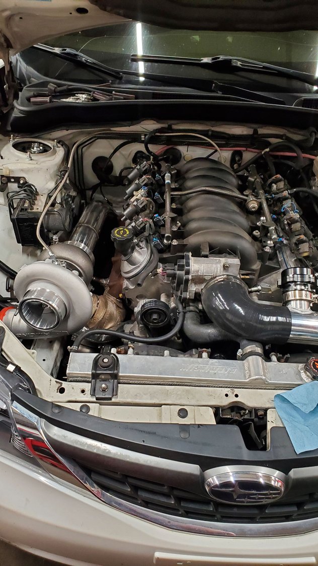

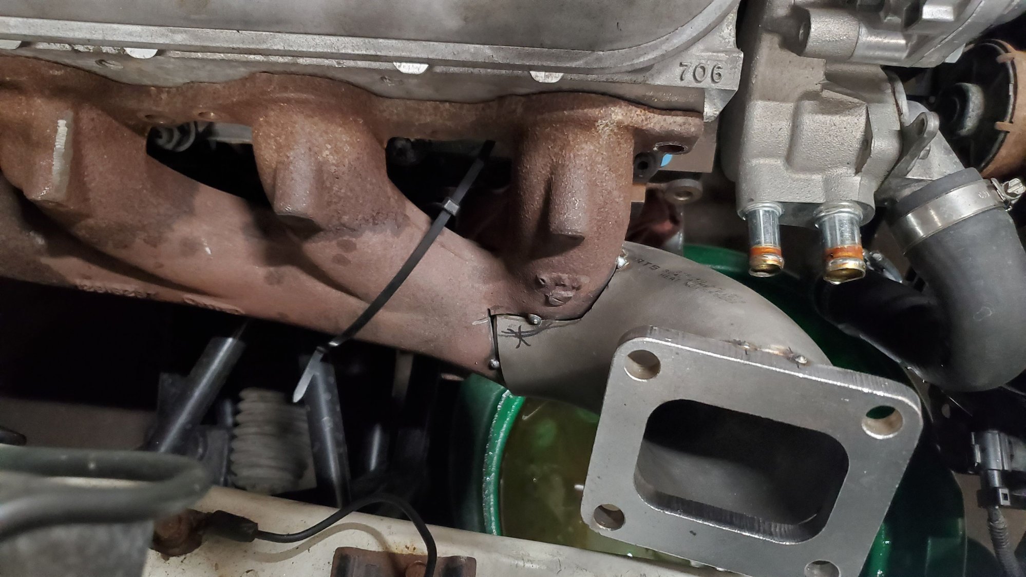

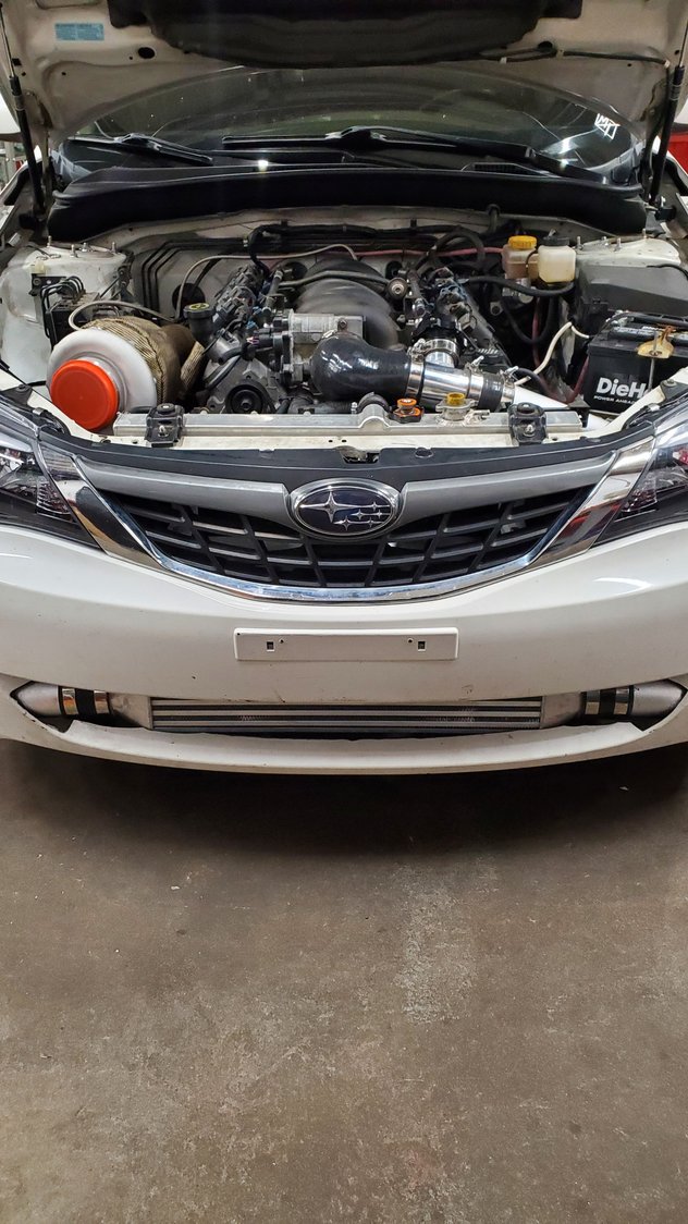

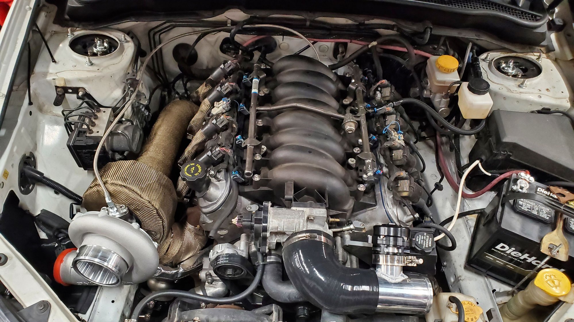

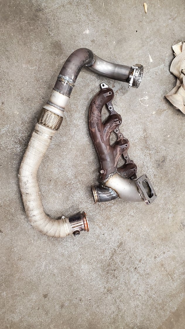

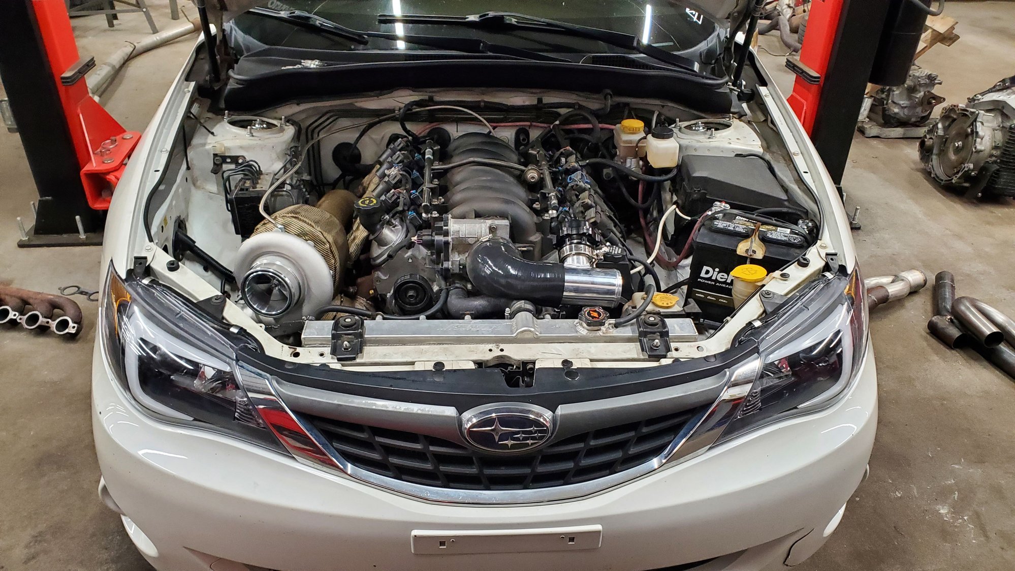

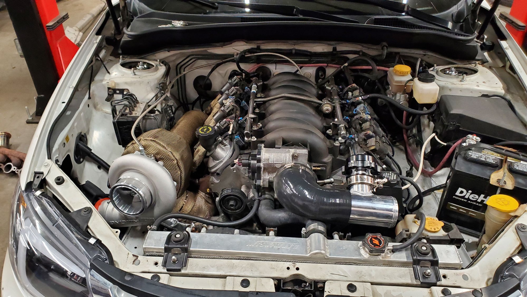

Gathered some bits and had the shop to myself for a long weekend with one goal...turbo time
Downpipe ingredients

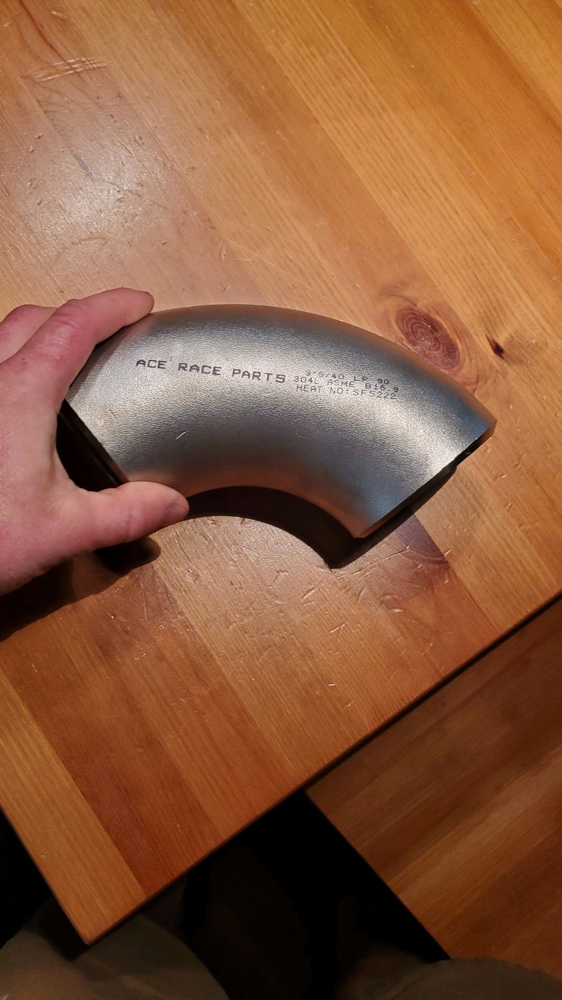

Schedule 40 stainless elbow...stout chunk of metal
Tacked in with flange
Angle looks good...it was tough holding all this and turbo while trying to mark it to get alginment right

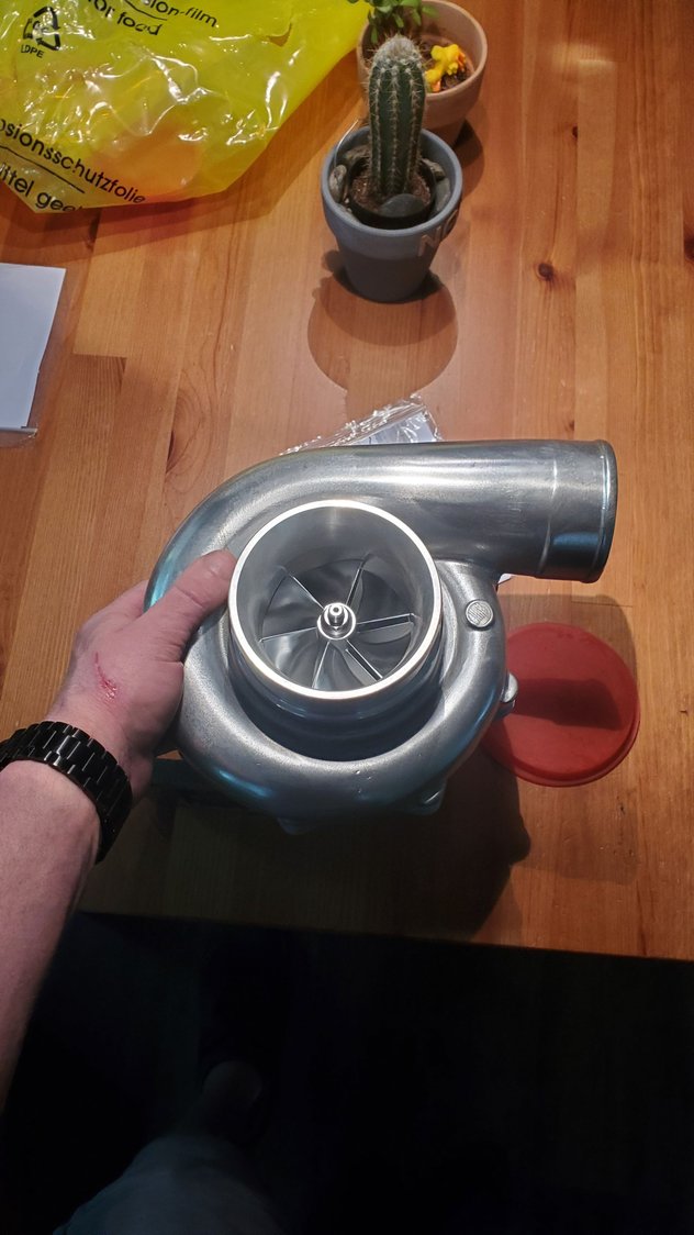

Turbo mounted...getting spicy
Turbo manifold with crossover modified from original layout

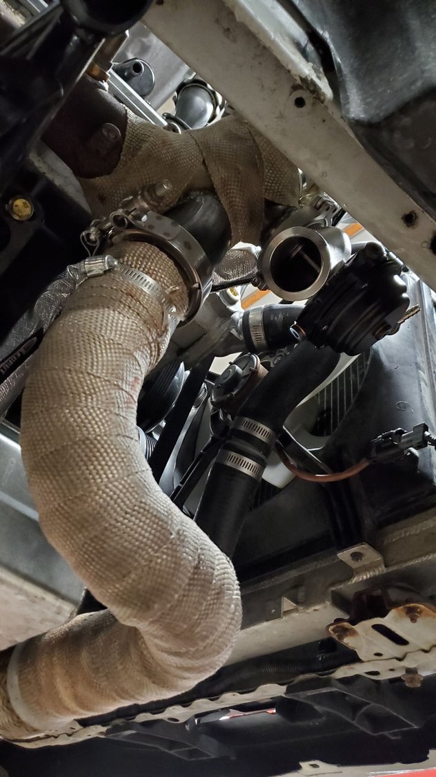

Hotside wrapped and coming together

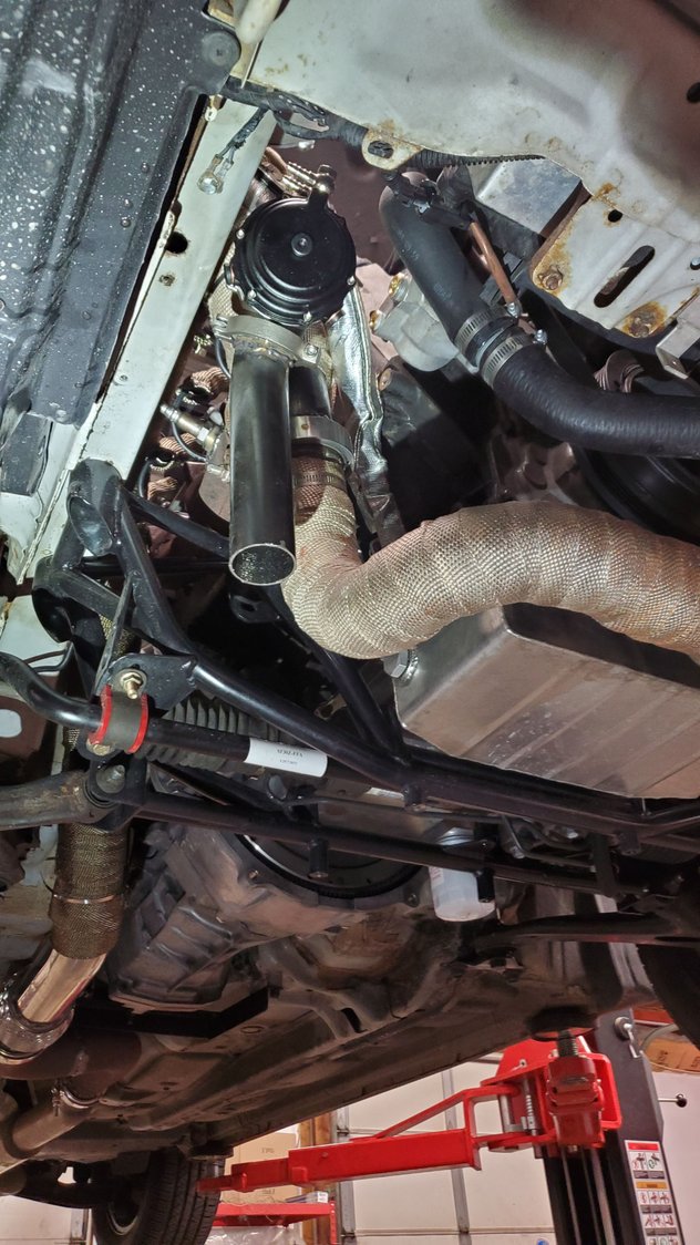

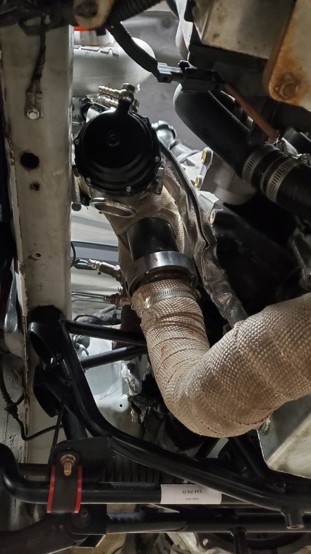

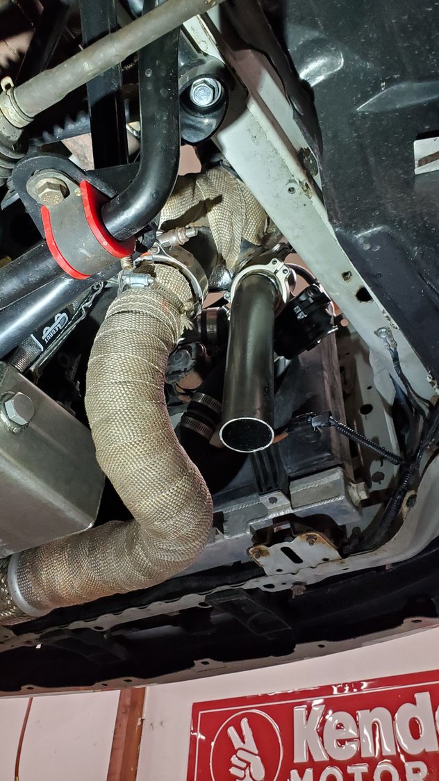

Wastegate in and heater outlets tapped and plugged
Downpipe constructed
A little heat treatment
Hotside complete
Now time for the coldside

Dump pipe fitted
Old Jul 6, 2023 | 07:20 PM
Bbknucks's Avatar
Joined: Dec 2022
Posts: 444
Likes: 158

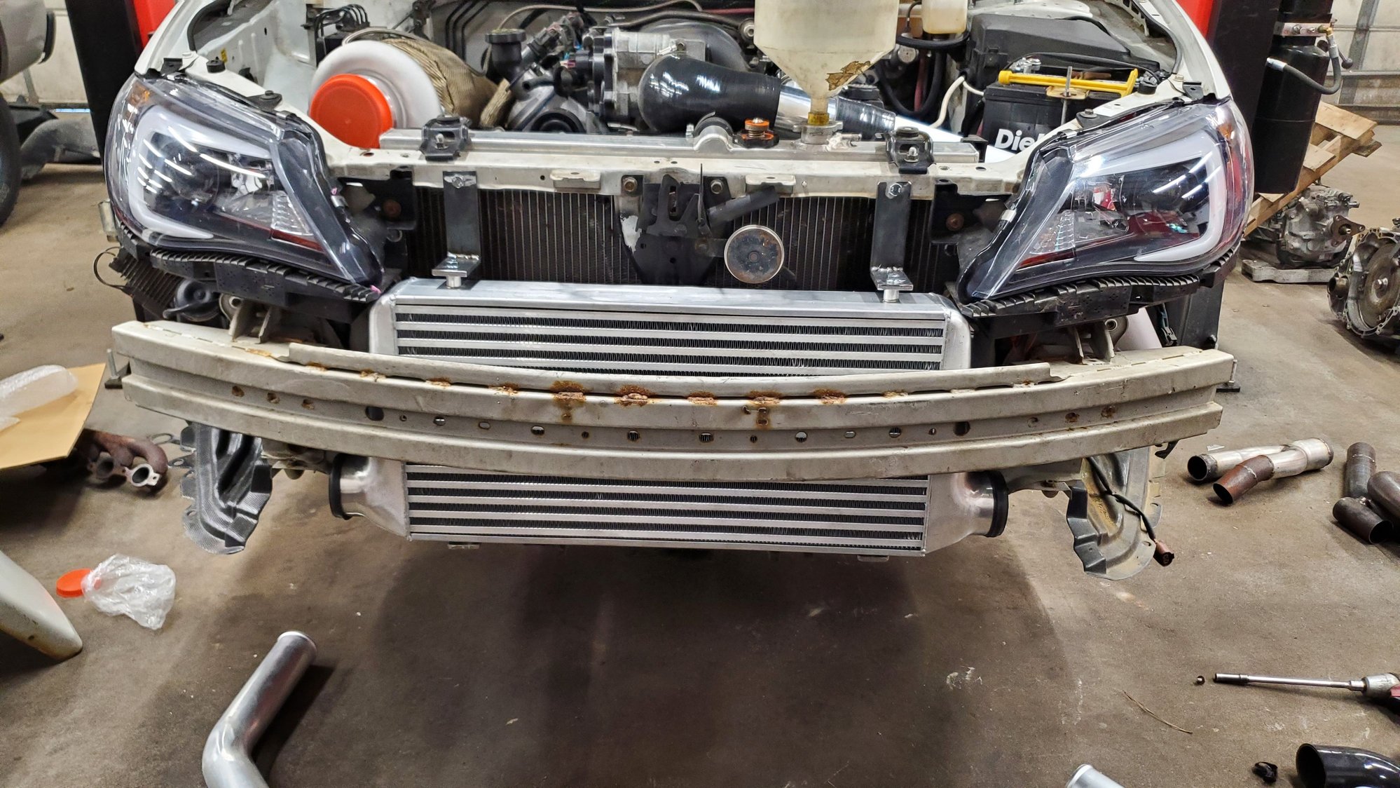

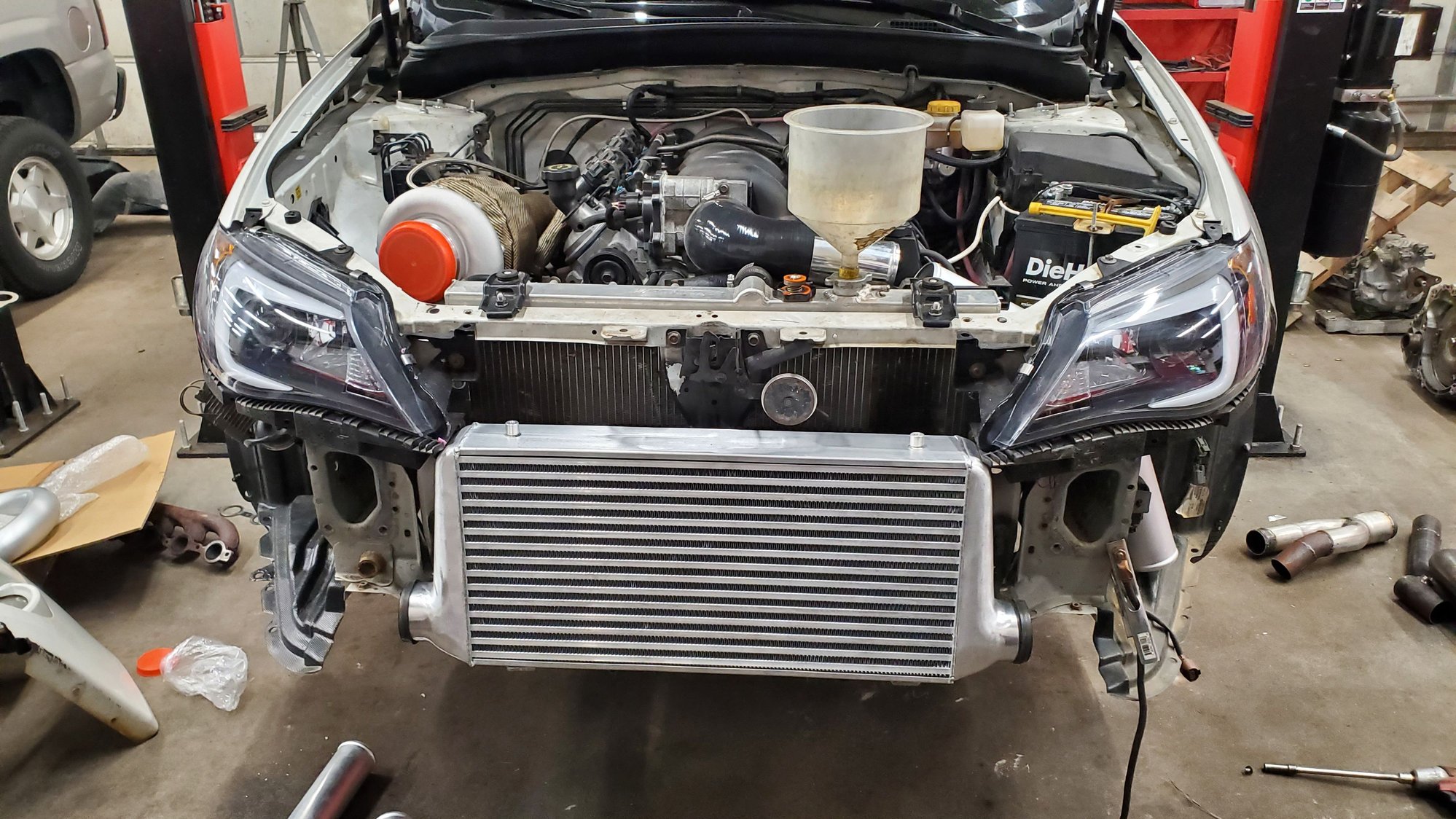

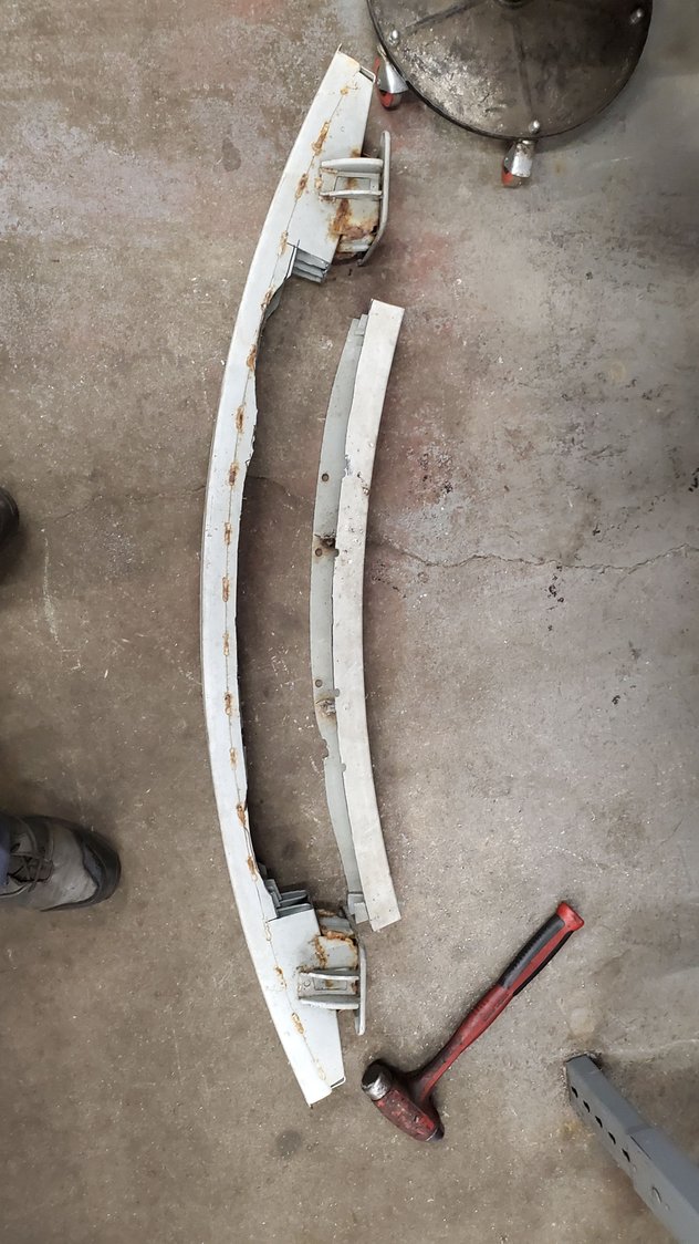

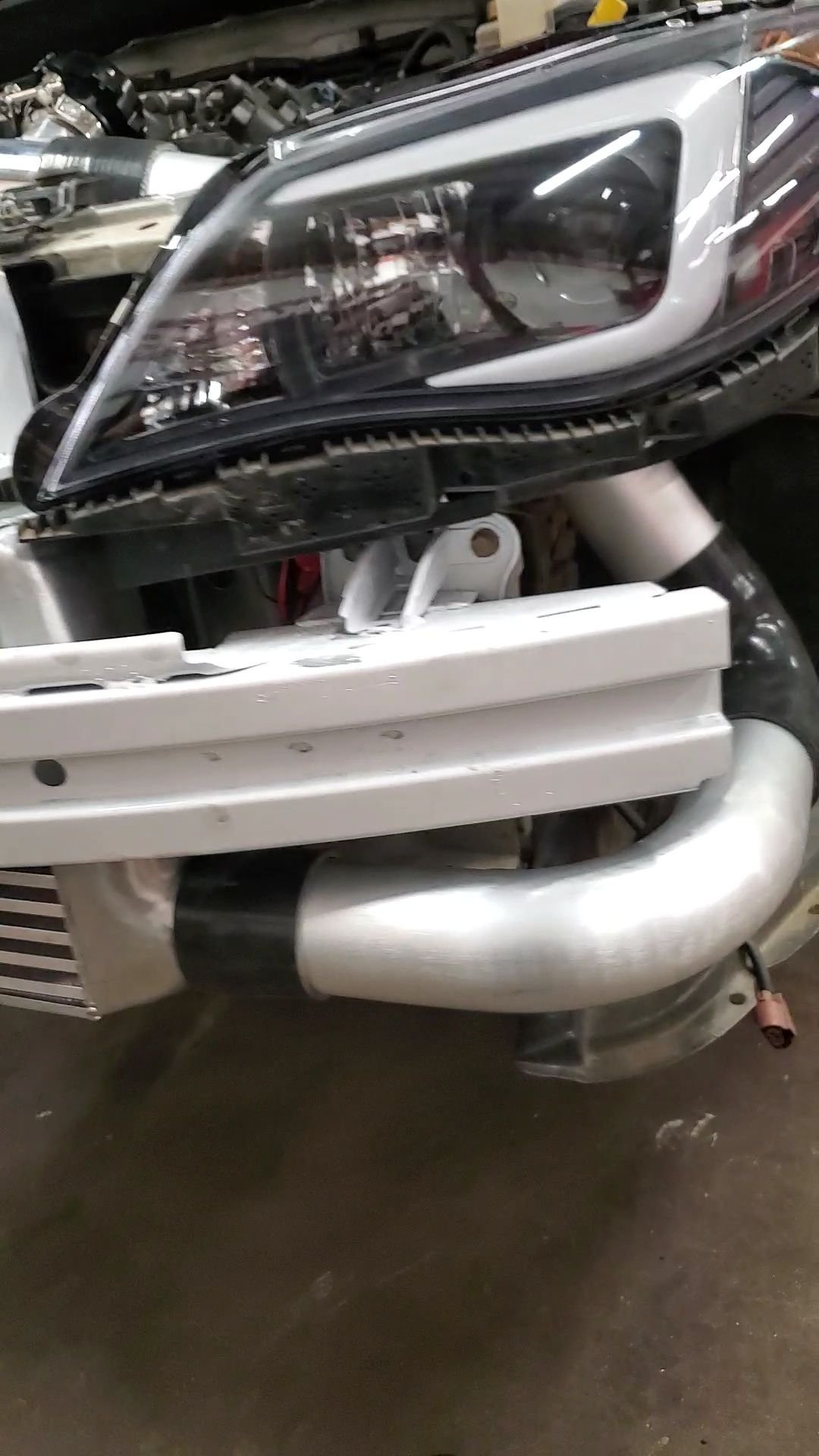

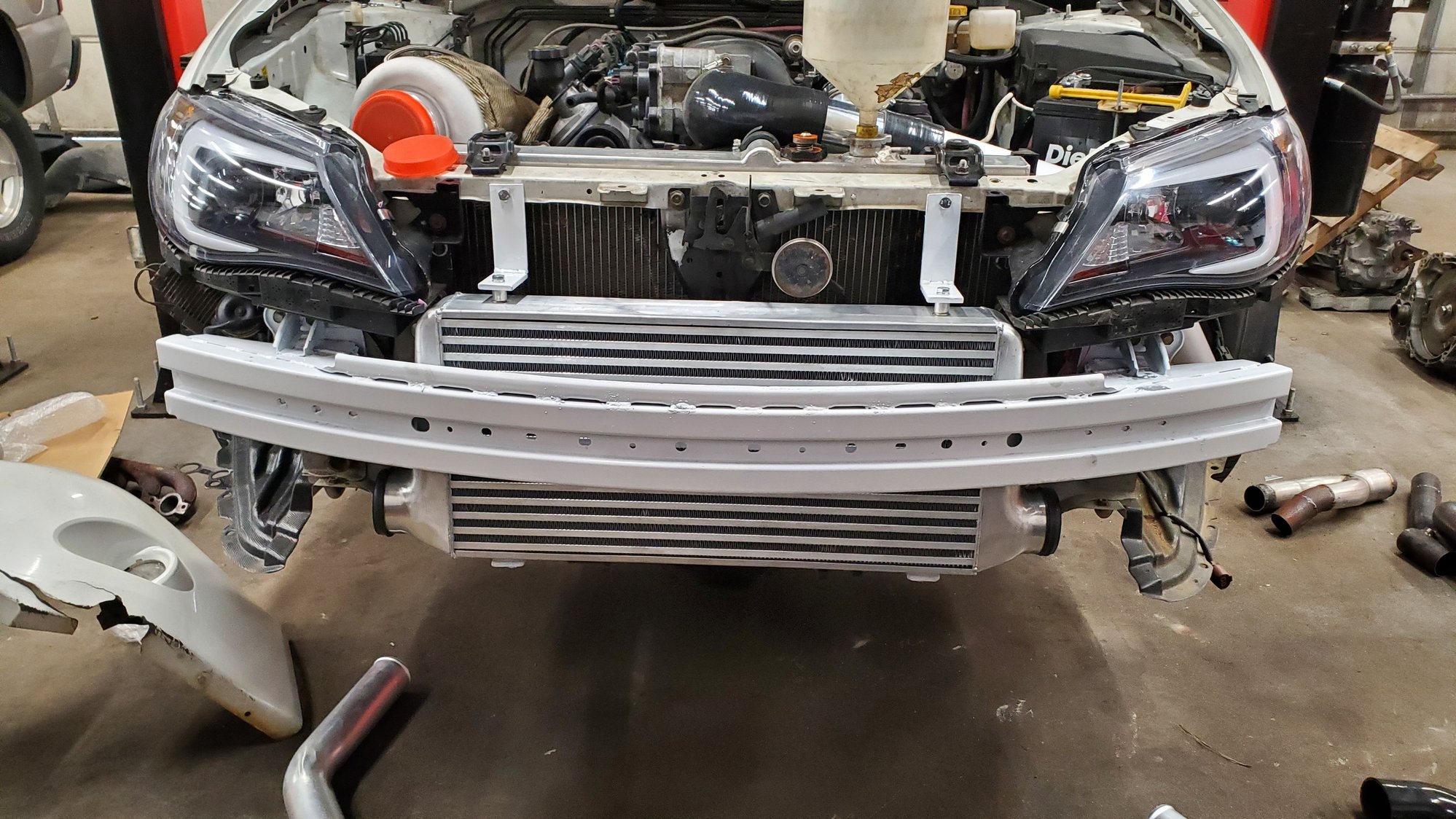

Big ol cooler... gonna need some brackets and alot of cutting to fit
Was able to male the bumper beam fot with some slight modificating
All mounted and bumpered
Painted the bits

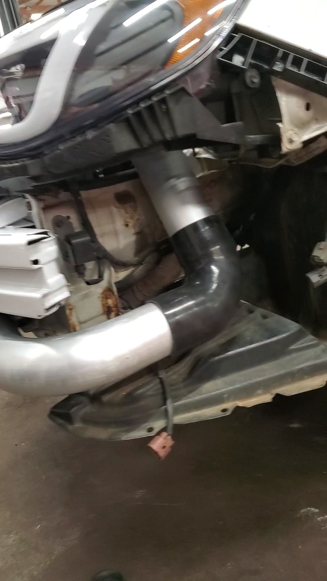

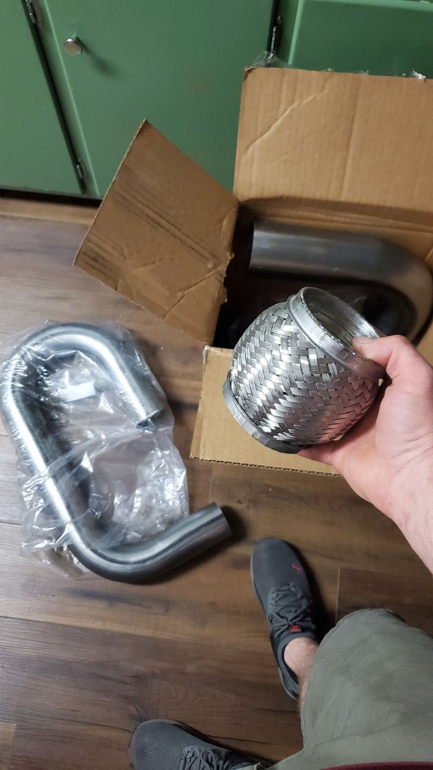

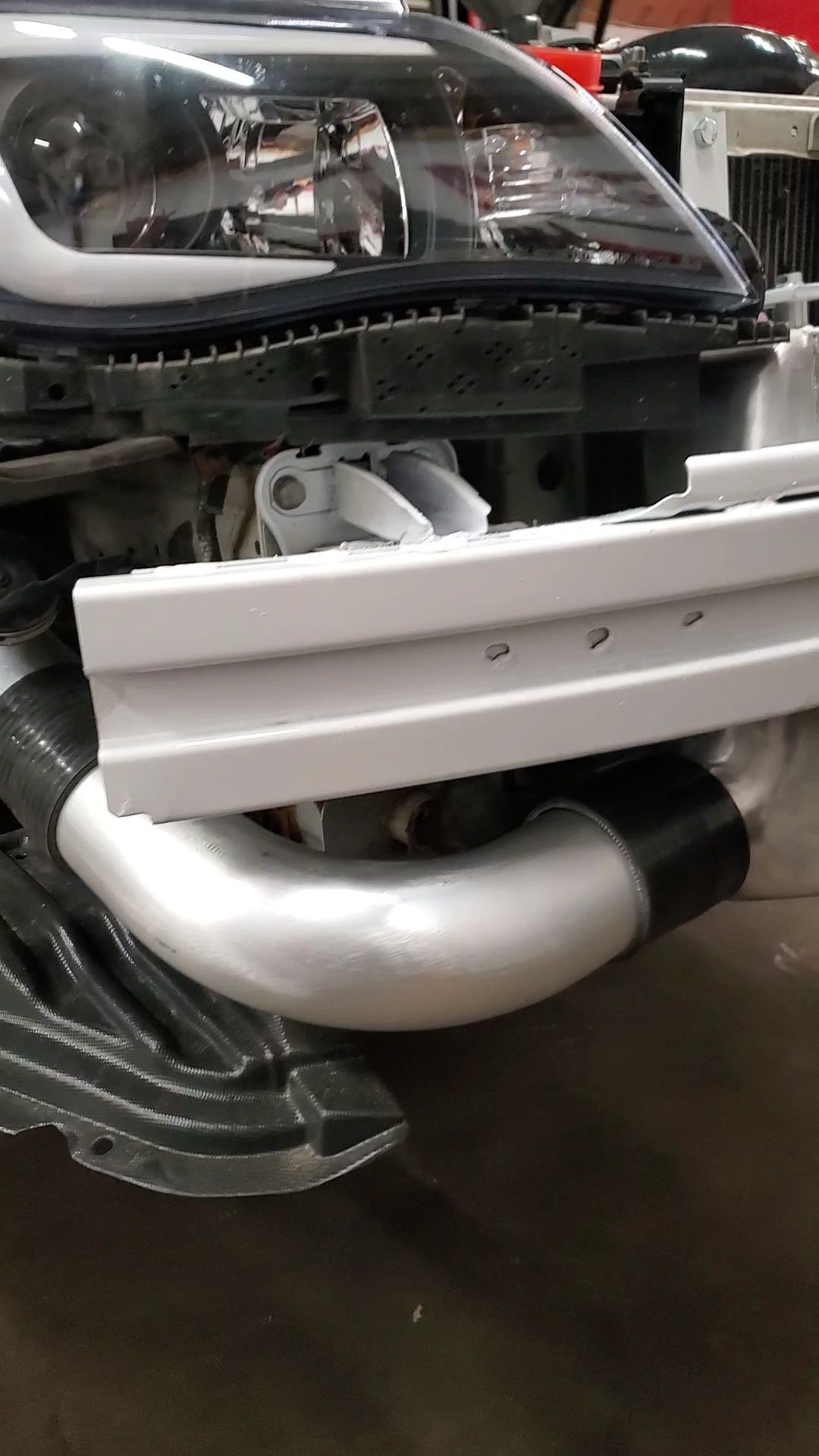

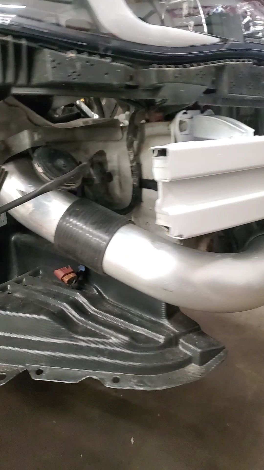

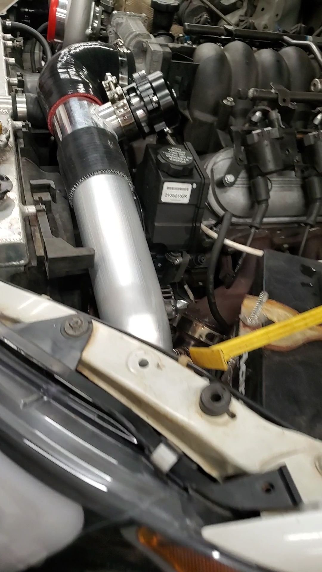

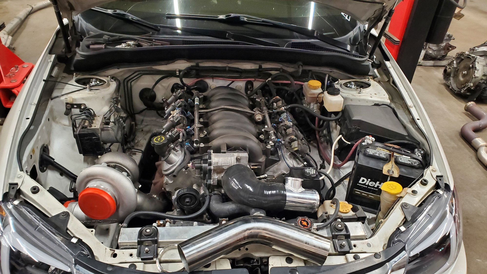

Cold side constructed from a generic ebay 3in kit
Cutting aluminum was a nice break from the steel working
Almost looks like it was made for it

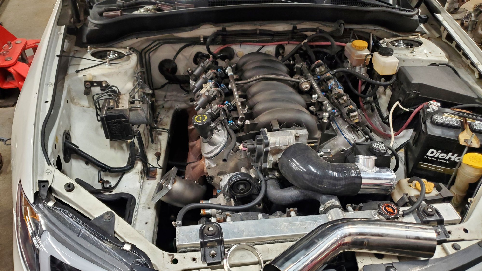

Got the deka 80s in then swapped 3bar map sensor.
Moved fuel regulator from tank to engine bay for boost reference
Installed flex fuel sensor and wired to pcm
installed one way valve and any vacuum/boost reference lines
Flashed in the 3bar OS3with a fat and safe VE table

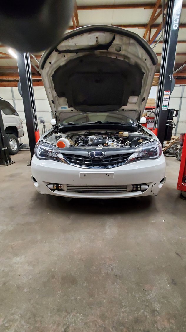

Weekend mission accomplished... turbo noises are sooo cool
Bumper on and ready for the 3bar tune and drive

Little better pic of the finished bumper

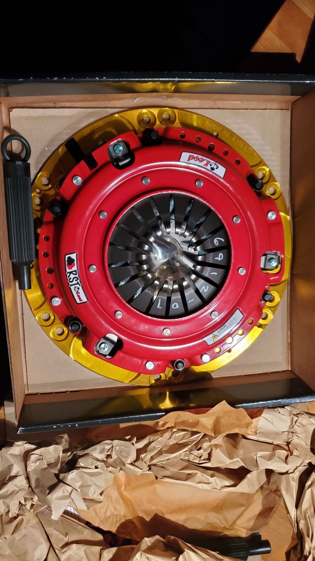

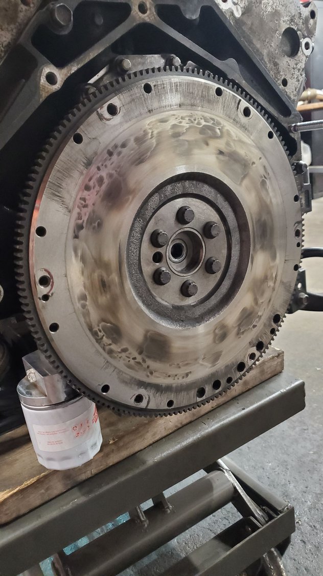

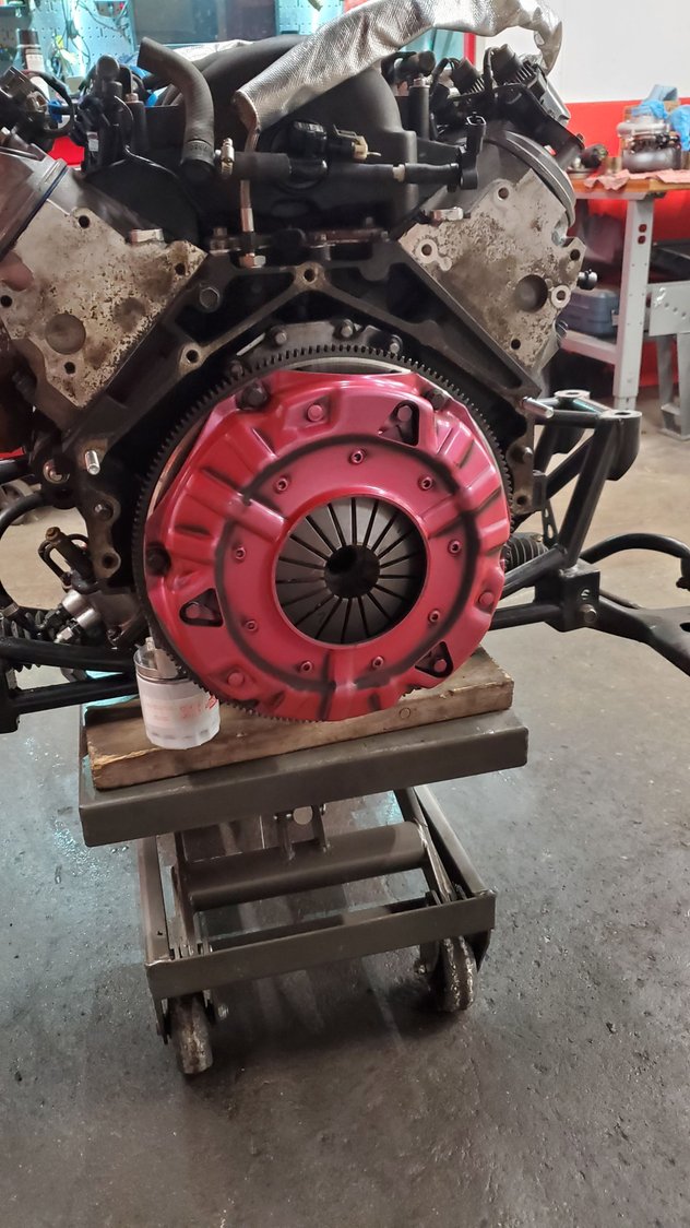

With the turbo setup the Ram clutch I had in there couldn't hold. It was rated for 500hp but would just lose grip under boost above 60mph.
Picked up a twin disk setup from mcleod. Hopefully all will hold. Little more break in and we will hive her all the beans my fuel system can give her.

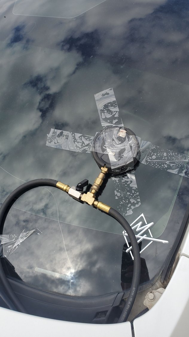

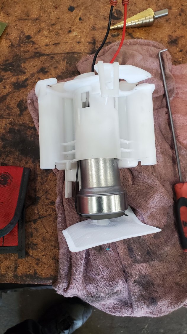

I was running out of fuel above 5krpm. I swapped the 340 pump with a 450 but still running lean up top. Need to verify fuel pressure but its gonna need more pump or injectors unless i limit boost at 10psi
Slapped my gauge on the windsheild and took it for a spin... definitely dropping pressure

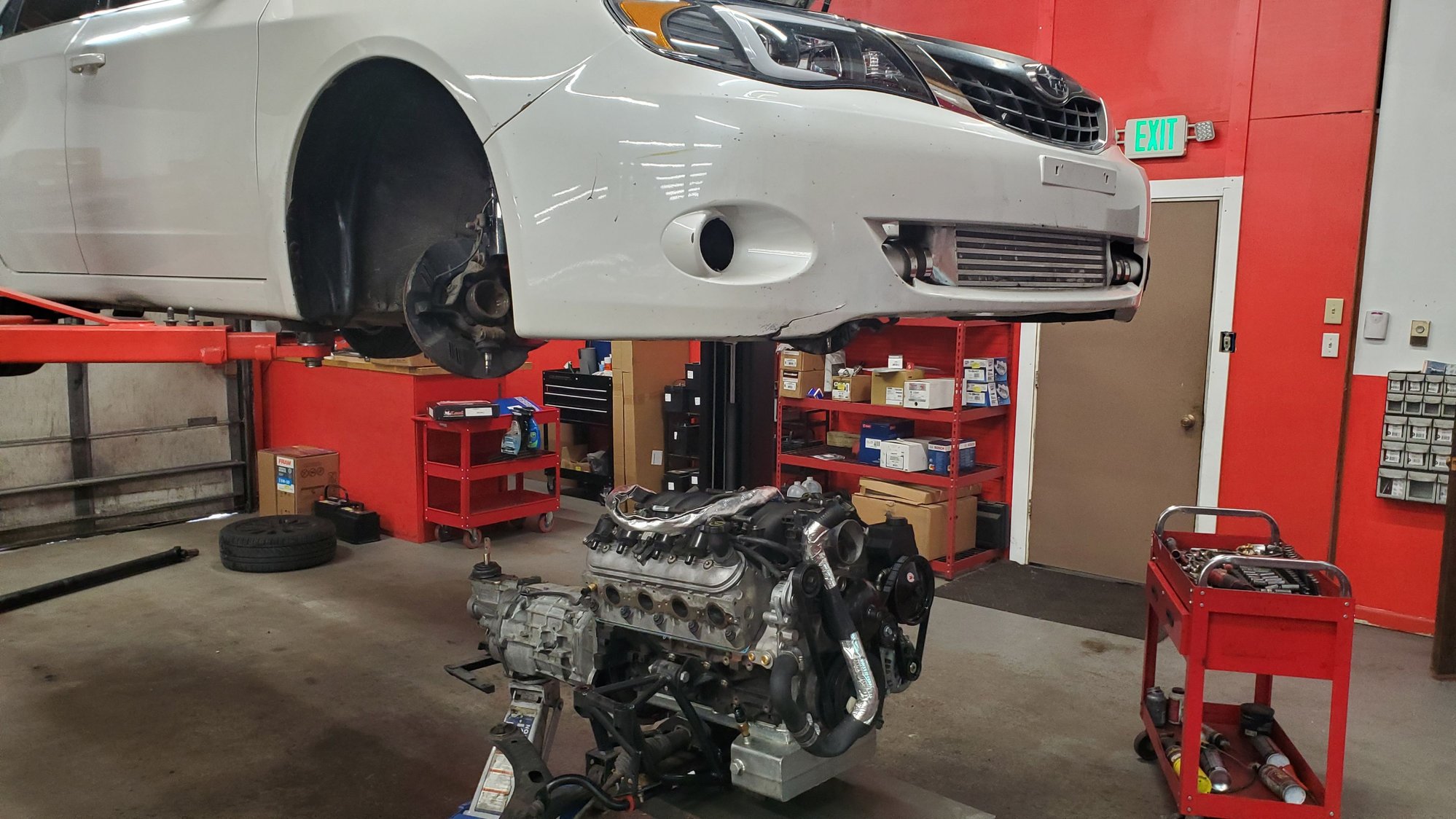

Pulled drive train to separate engine and trans
Mcleod twin disk rated for 800hp so hopefully should be enough
Ram clutch was not having a good time
Got a little spicy
Walbro 450 crammed in the stock basket

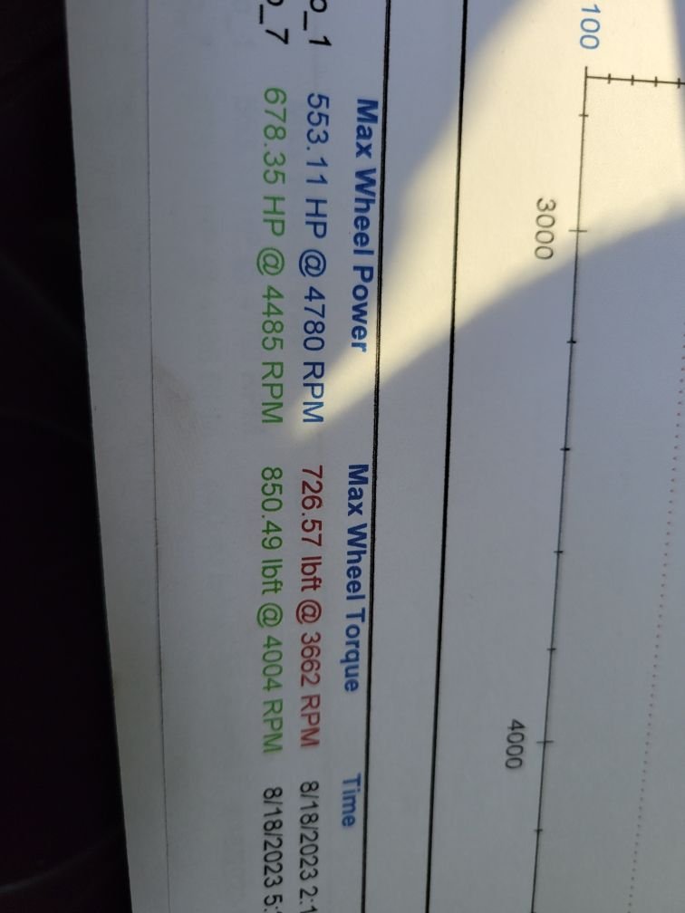

With a better boost controller she would really be putting it down
