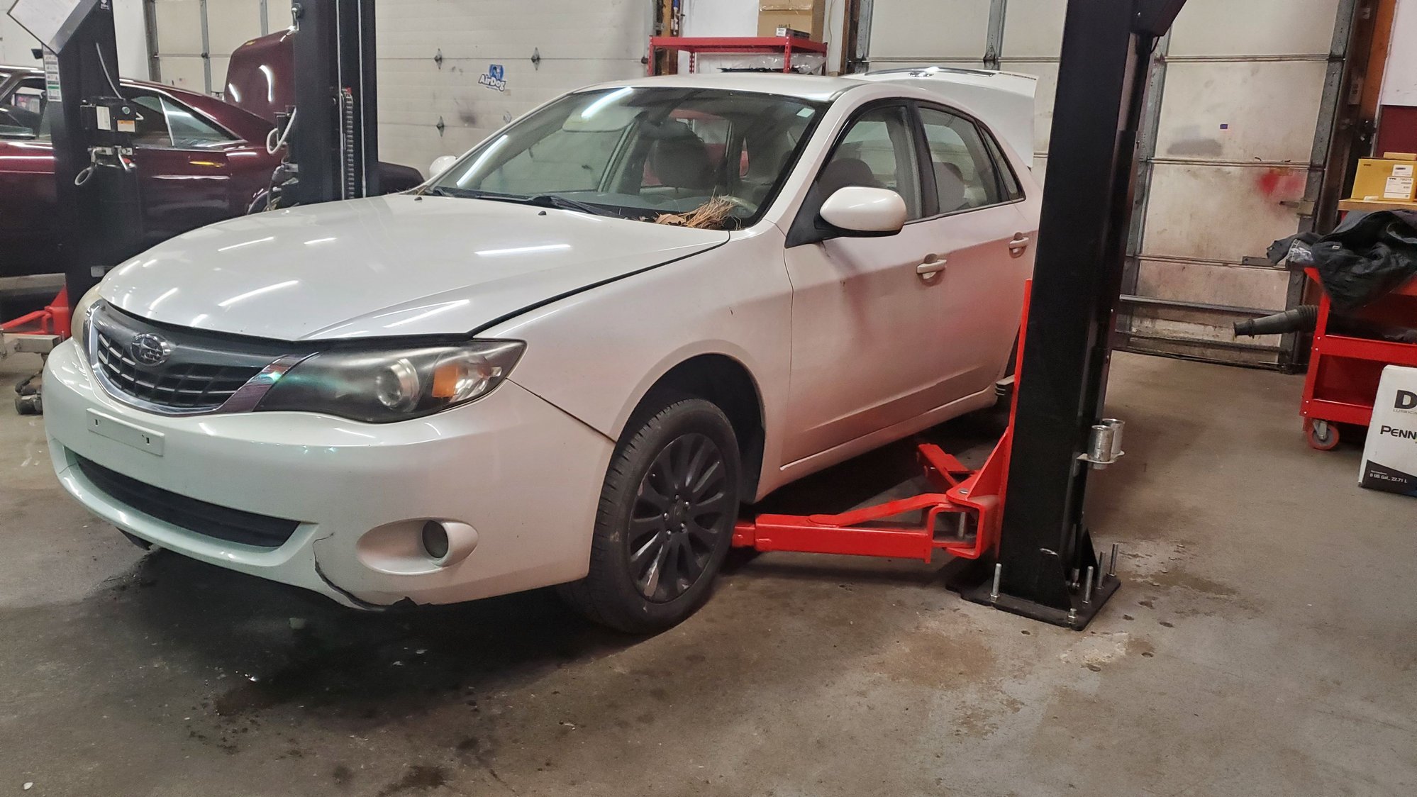

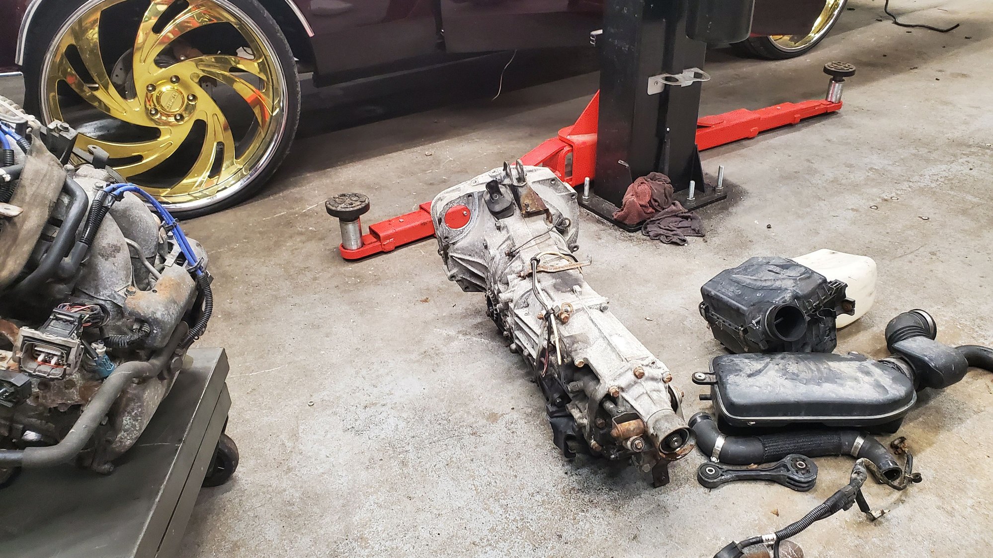

My buddy had this impreza with bad head gaskets and a 99 2500 sitting for years and i decided to make some use out of them. I also had a t56 sitting in the shop sotime to put that to use also.

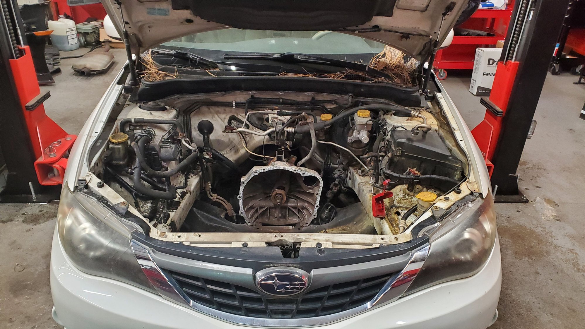

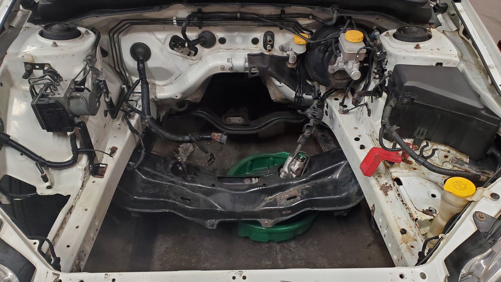

2008 impreza been sitting for a while due to bad head gaskets...

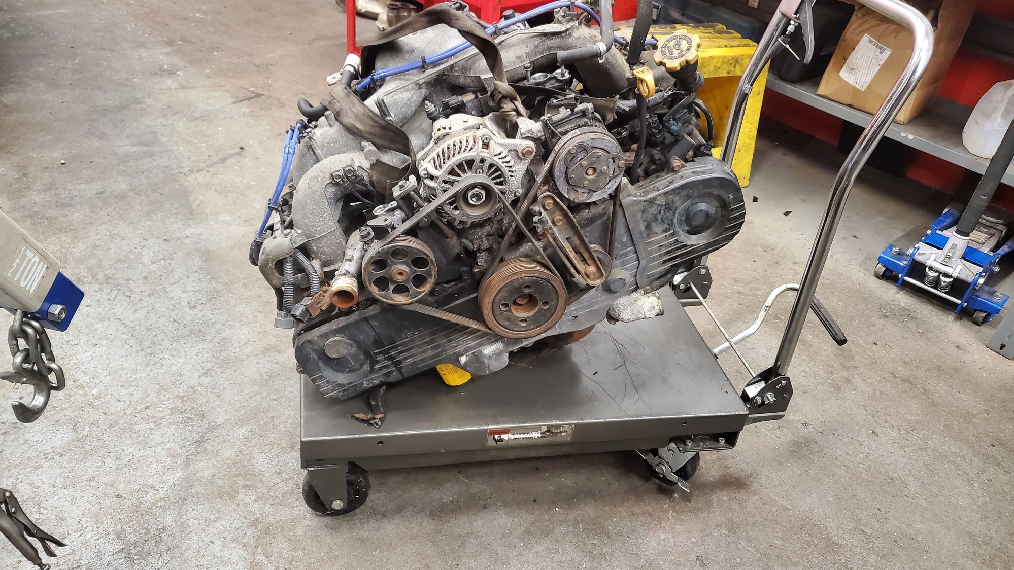

Flat boy out
Out with the old trans
Plenty of room for activities

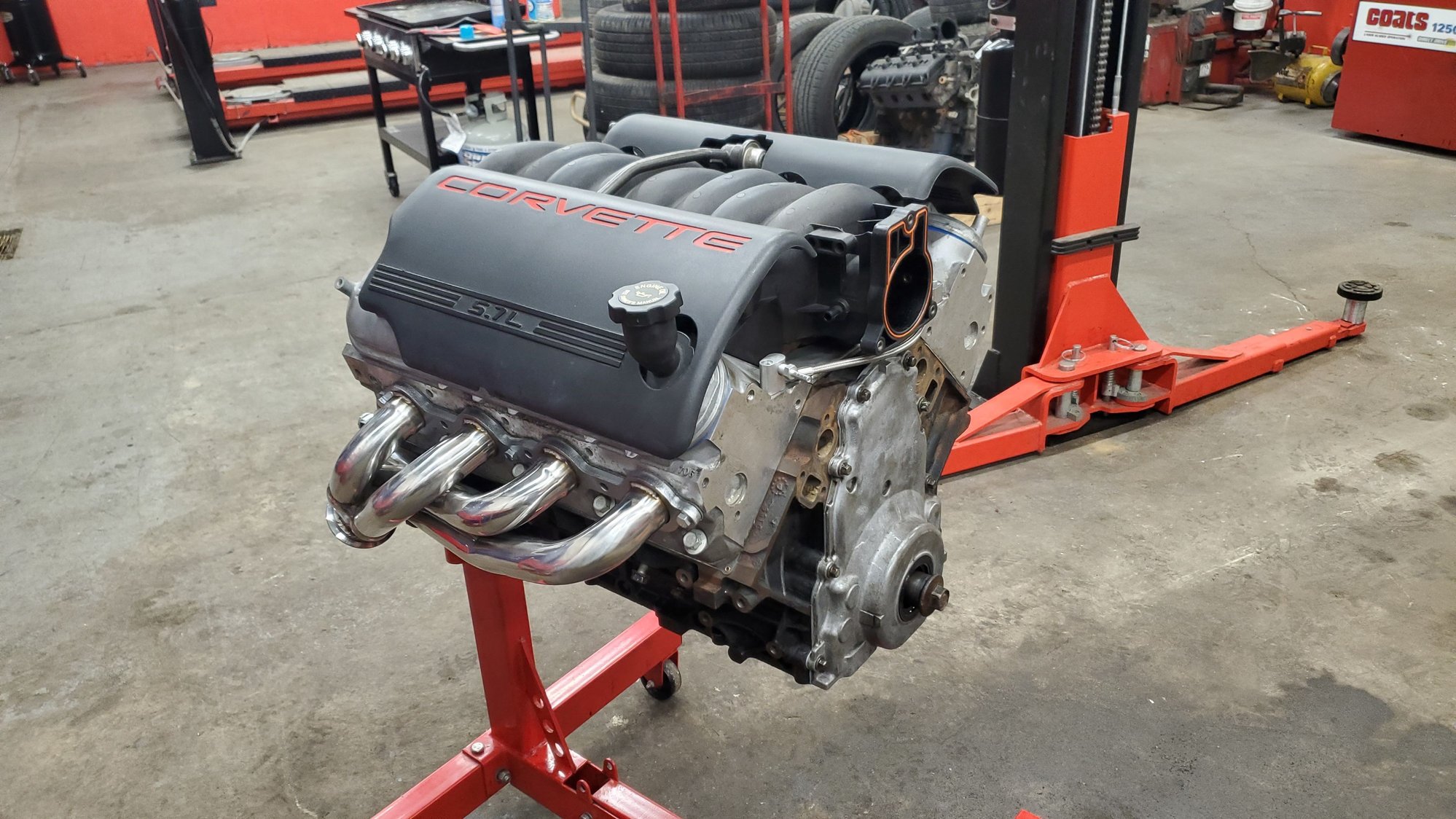

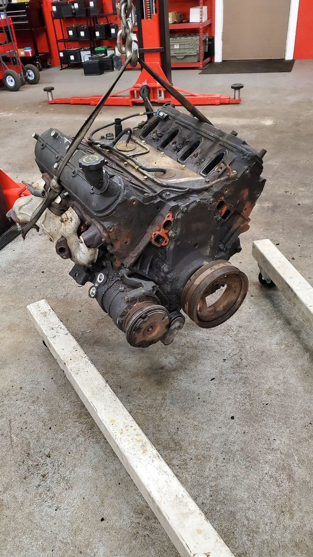

Iron Lq4 pulled out of 99 2500 donor...needs some love

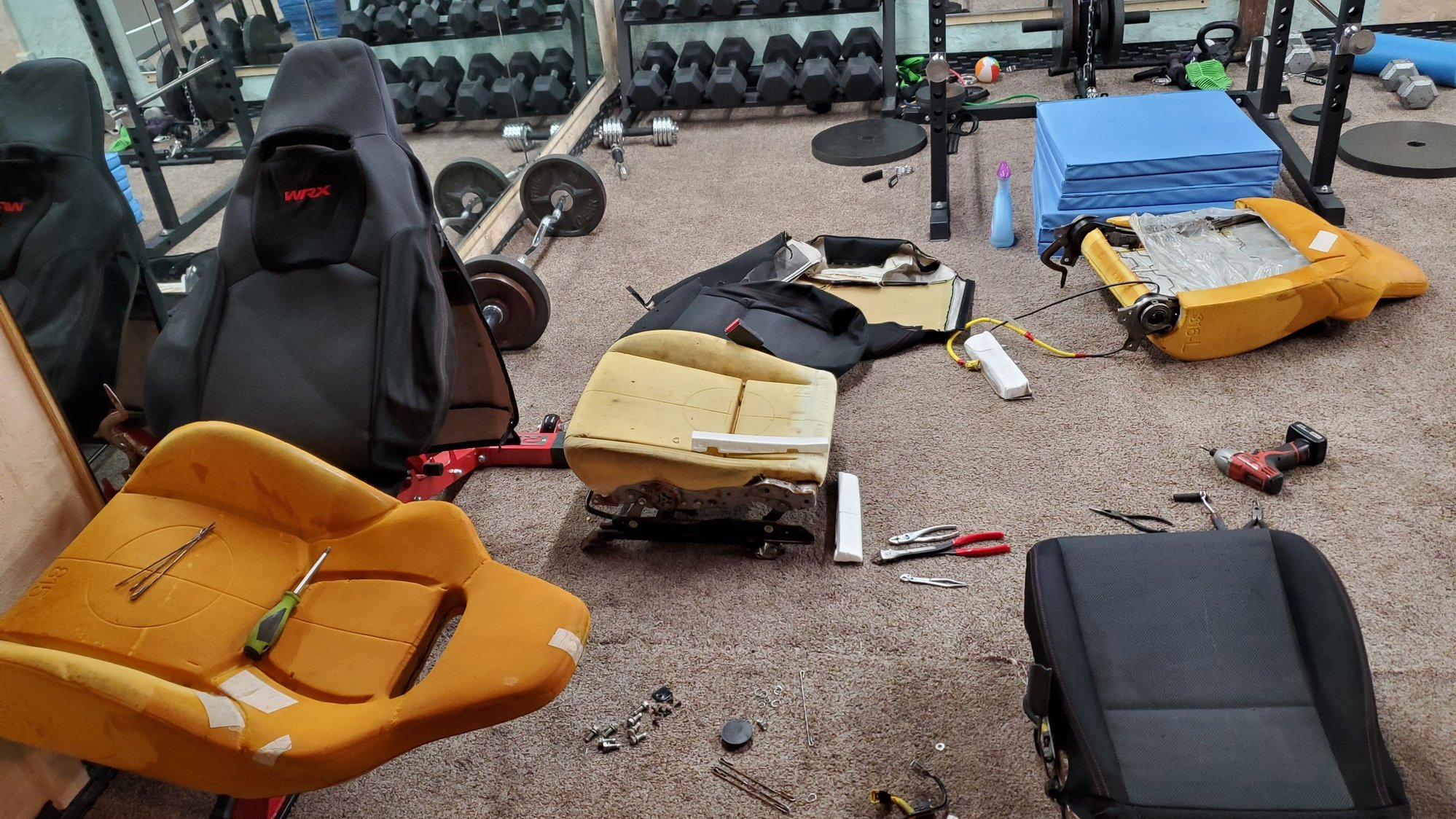

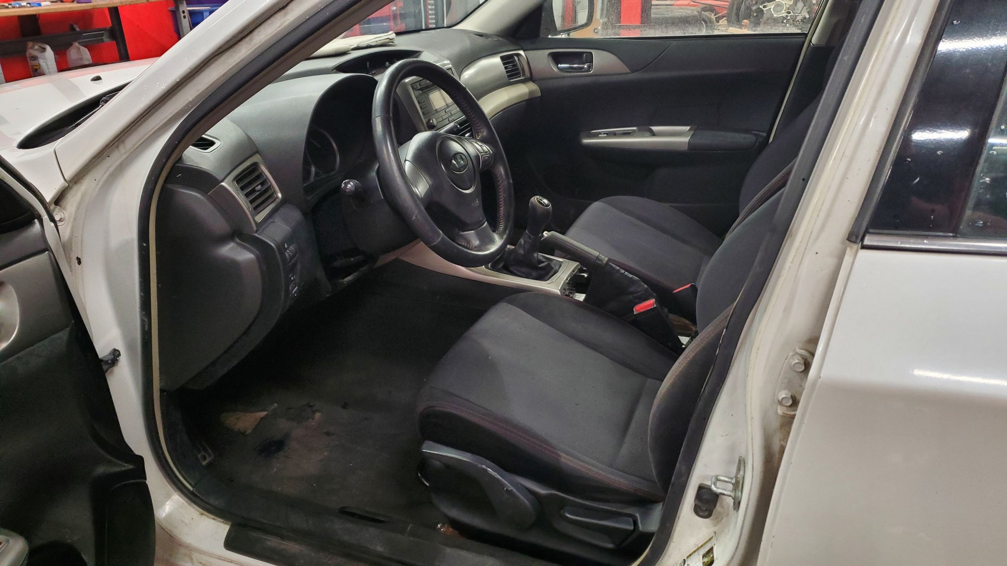

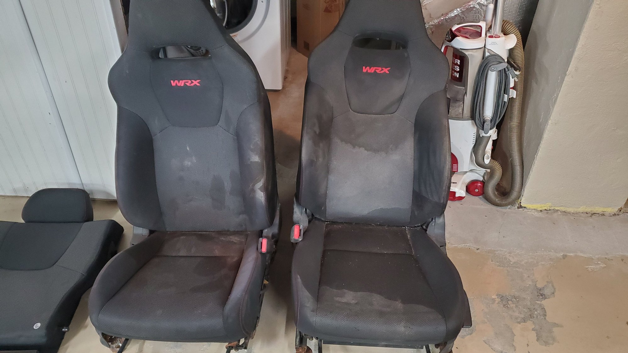

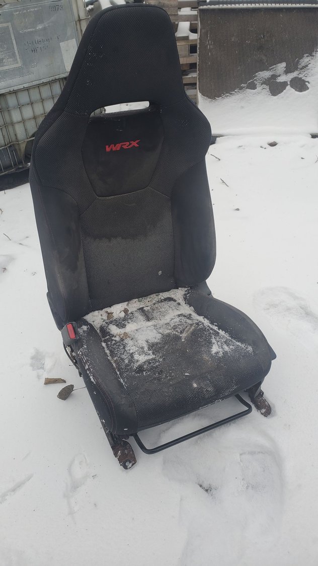

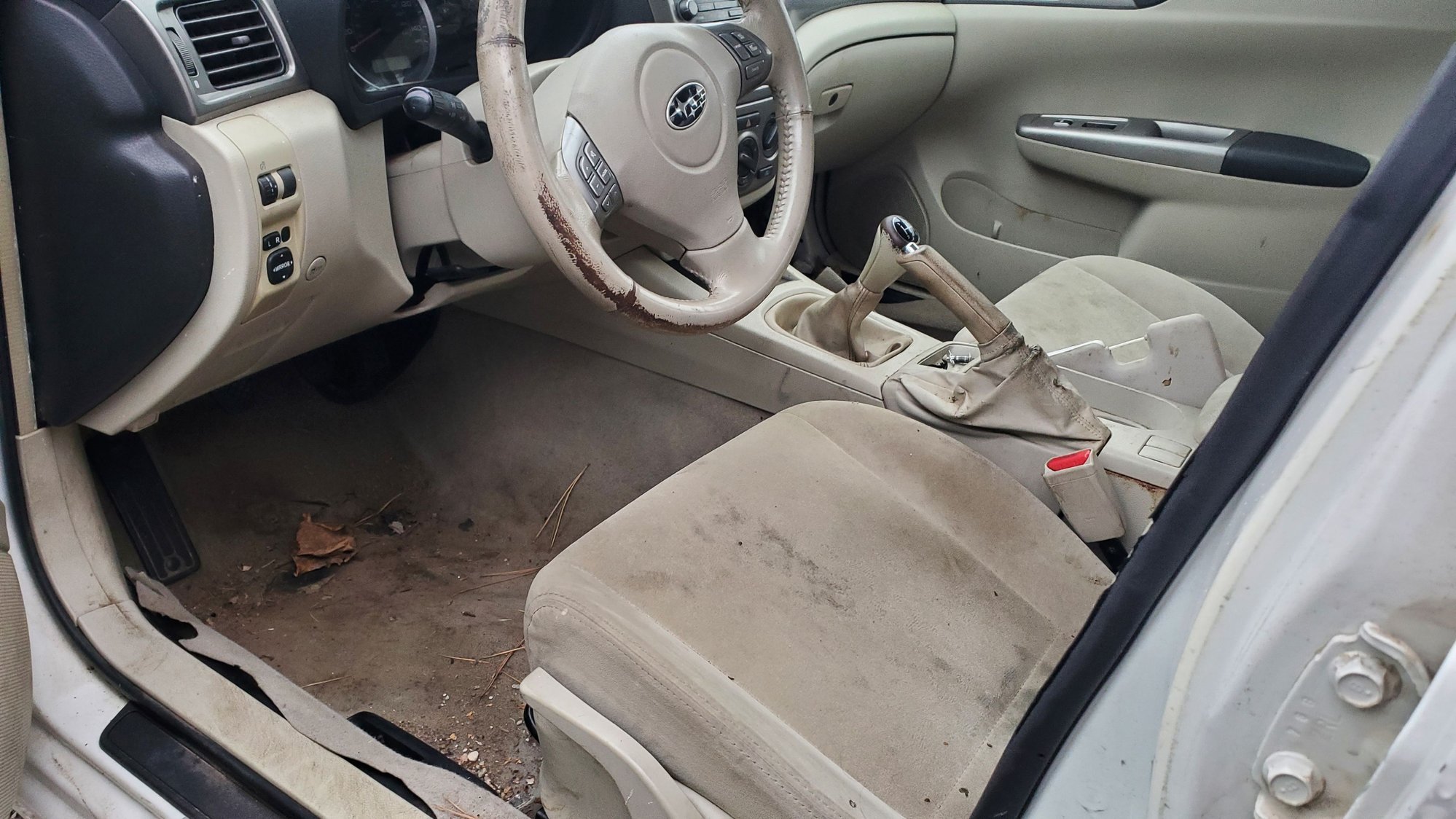

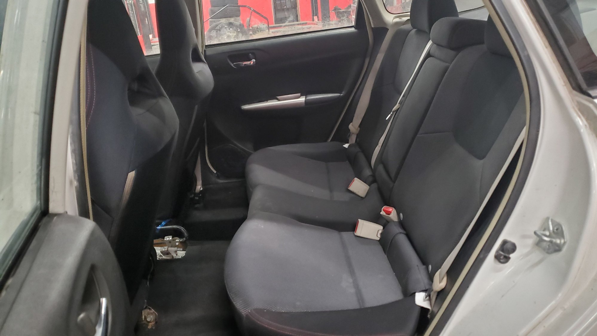

Found a wrx in junkyard and swiped interior
Stained and dirty
Striped down to wash fabric
Reassembled and looking better
Before
After
Much better

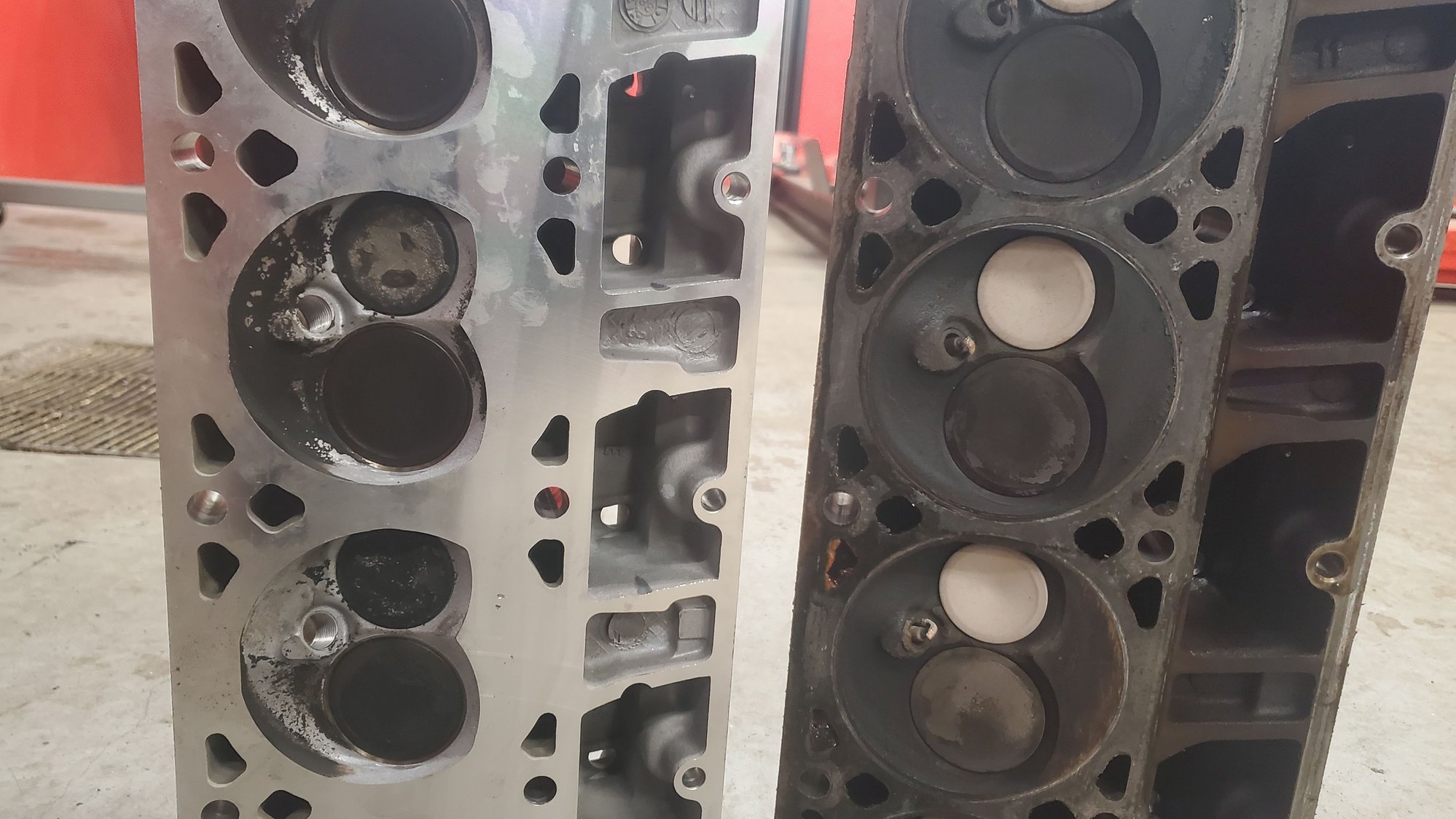

Removed old iron heads in favor of some 706 I got for 100$ had them pressure checked and decked

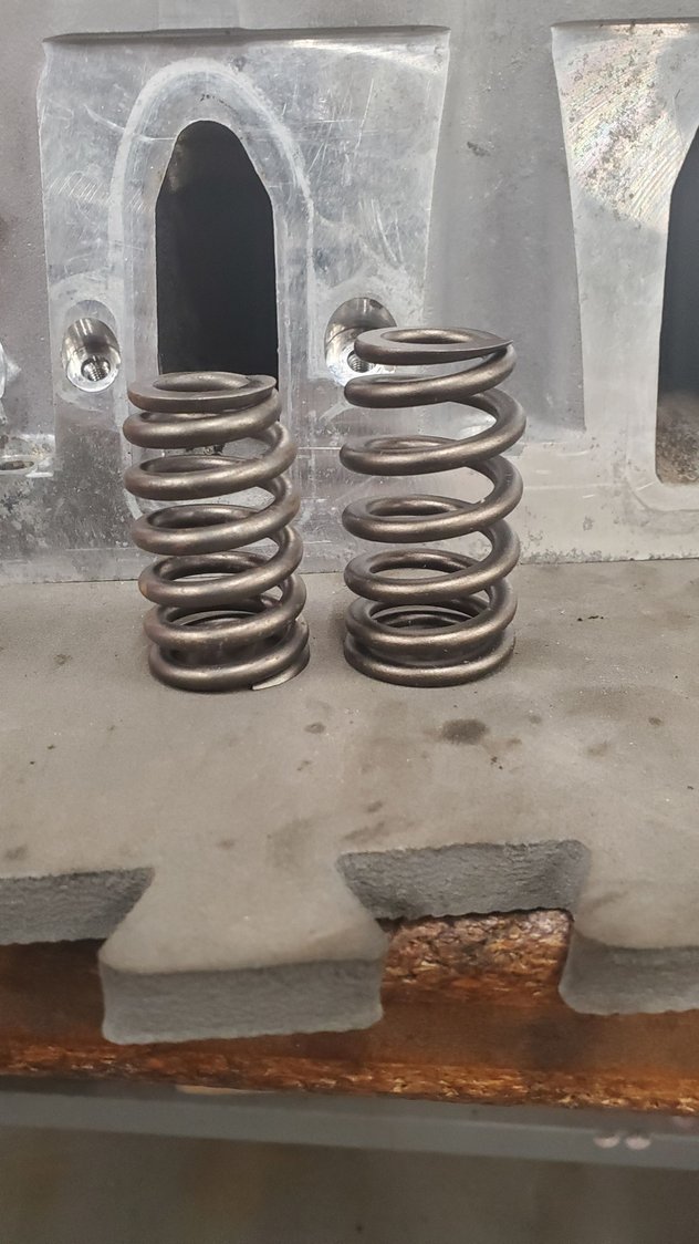

Pac springs to go with the sloppy 2 cam
Polished up a bit with some covers my buddy gave me

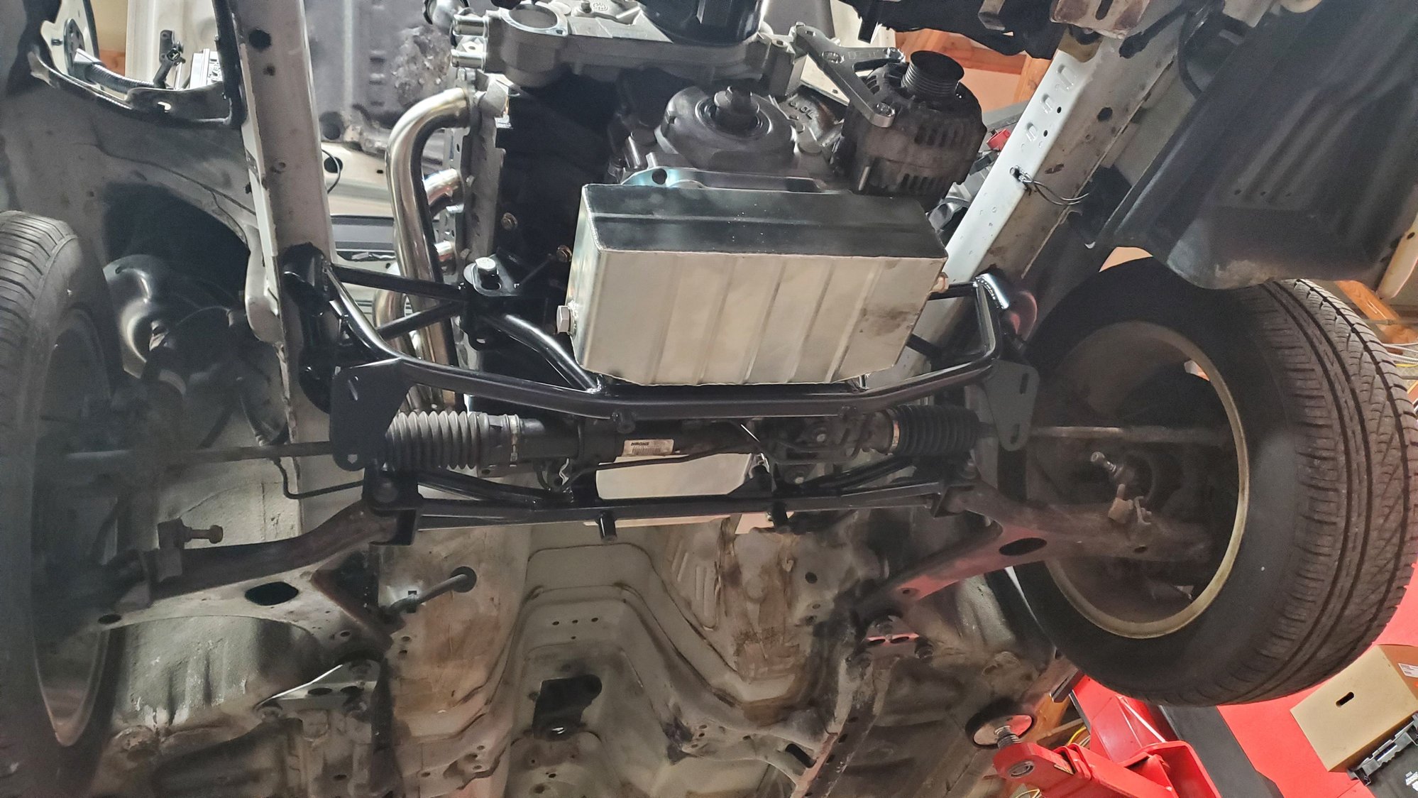

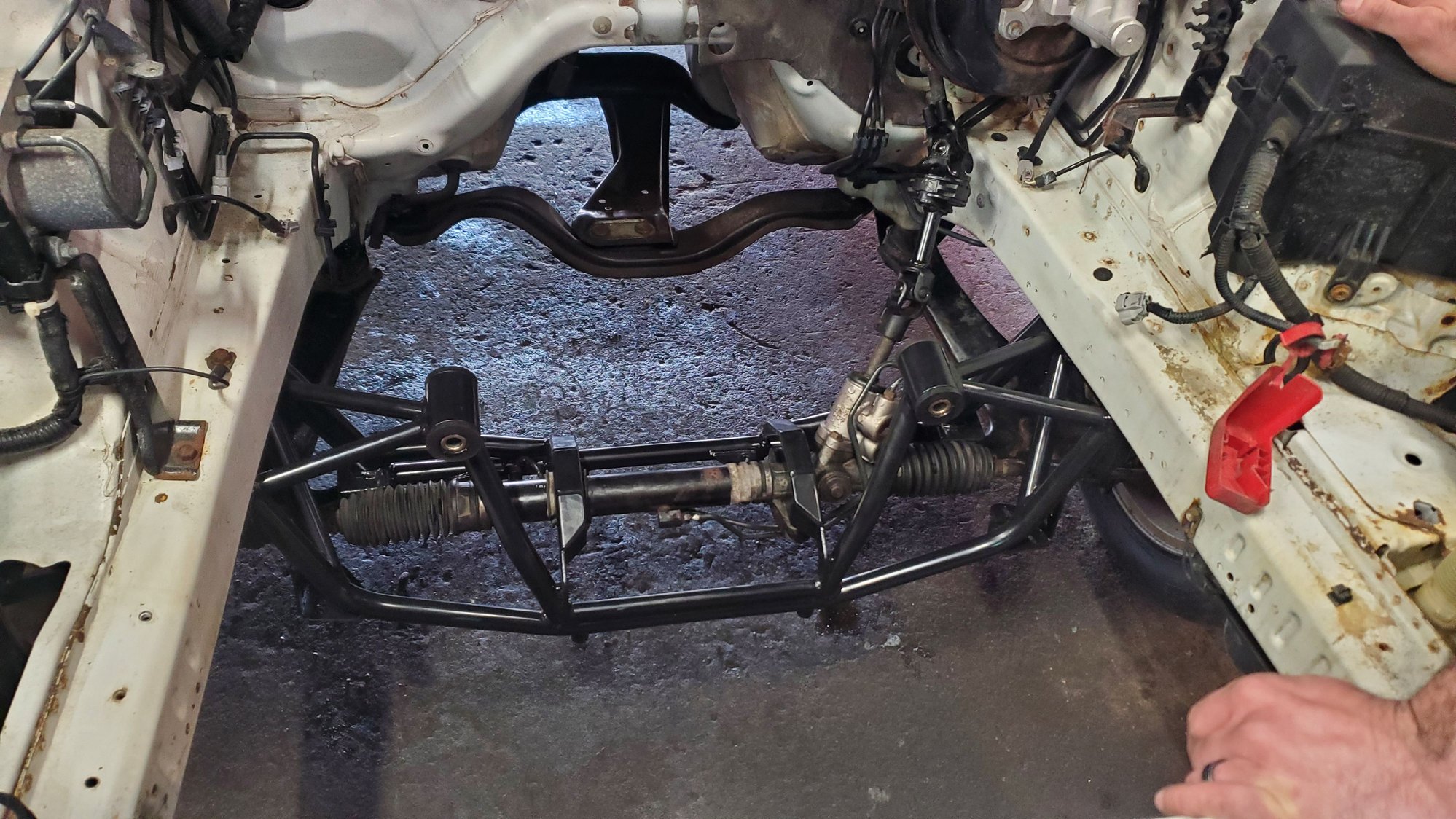

New subframe from tssfab.com to hold the ls in the subie. Off to powder coat

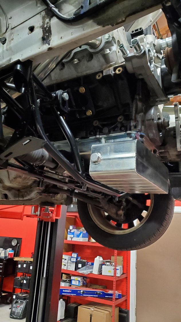

Checking clearances for oil pan..options are limited
Goofy shaped pan. Made for ls swapping a 350z

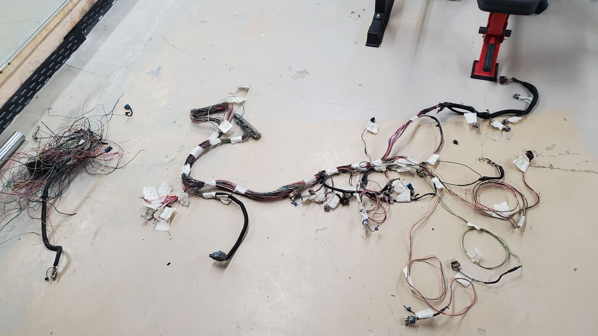

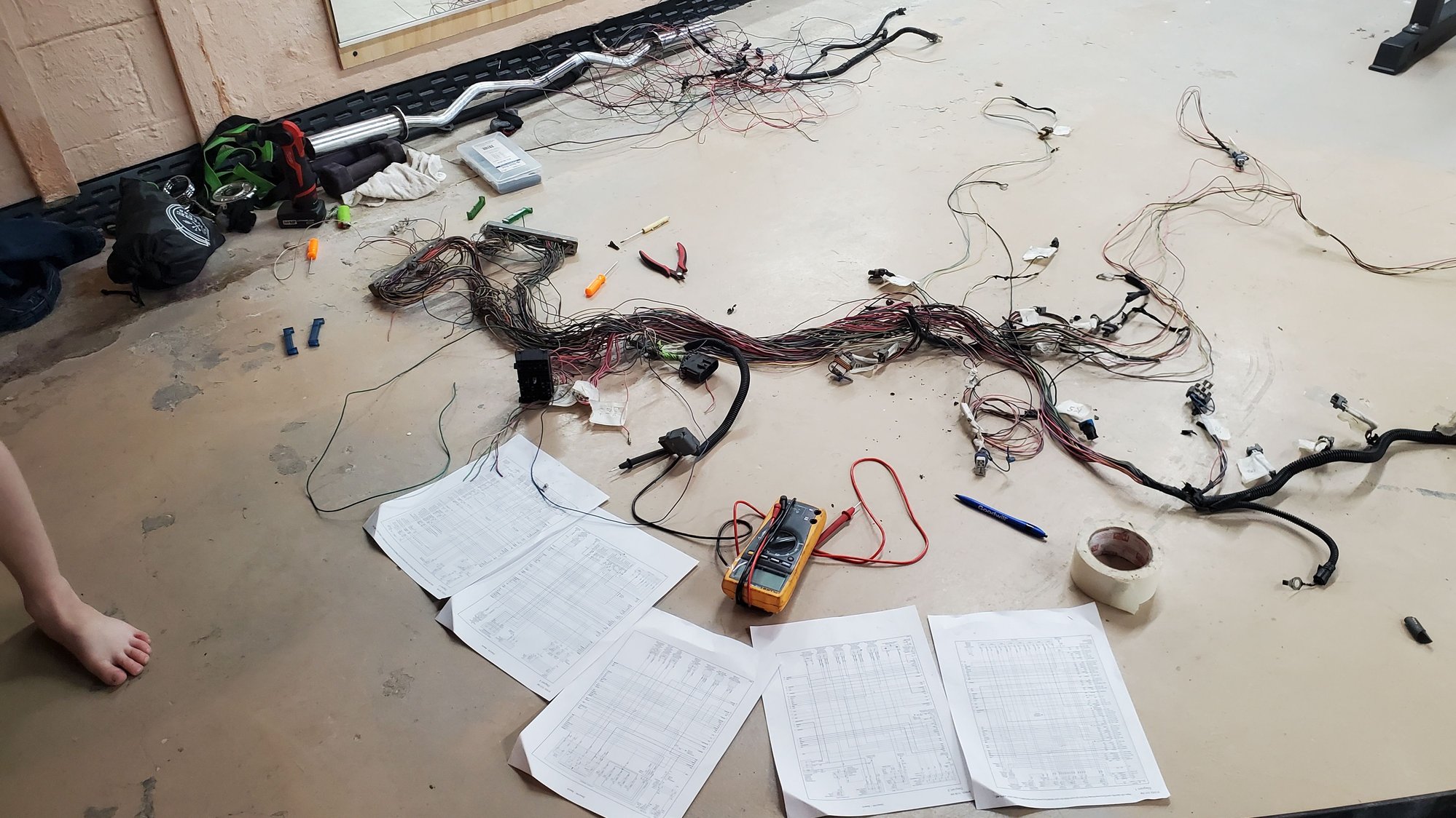

Wiring...never fun
Removing unnecessary circuits and fixing some failed ones
All cleaned up and reworked

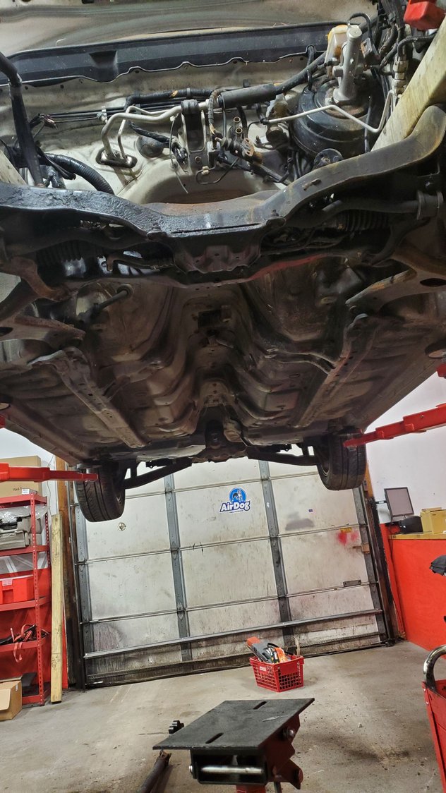

Sub frame in

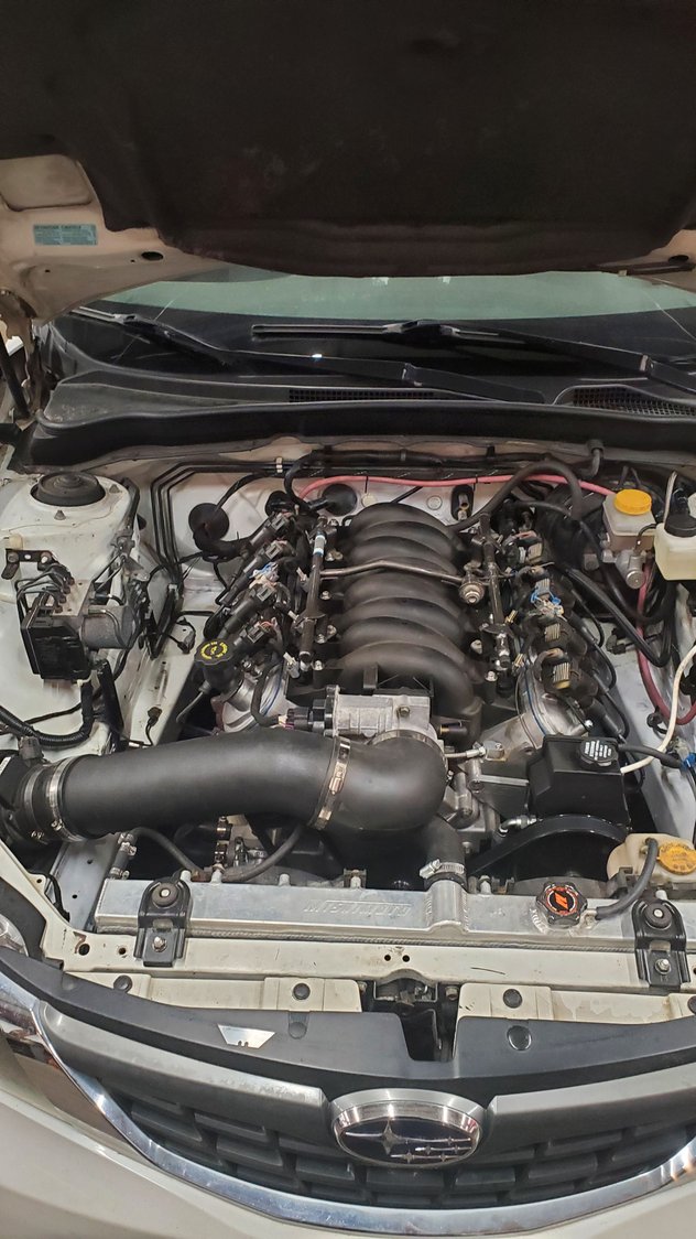

Finally in its new home
Just enough clearance with f body accessories

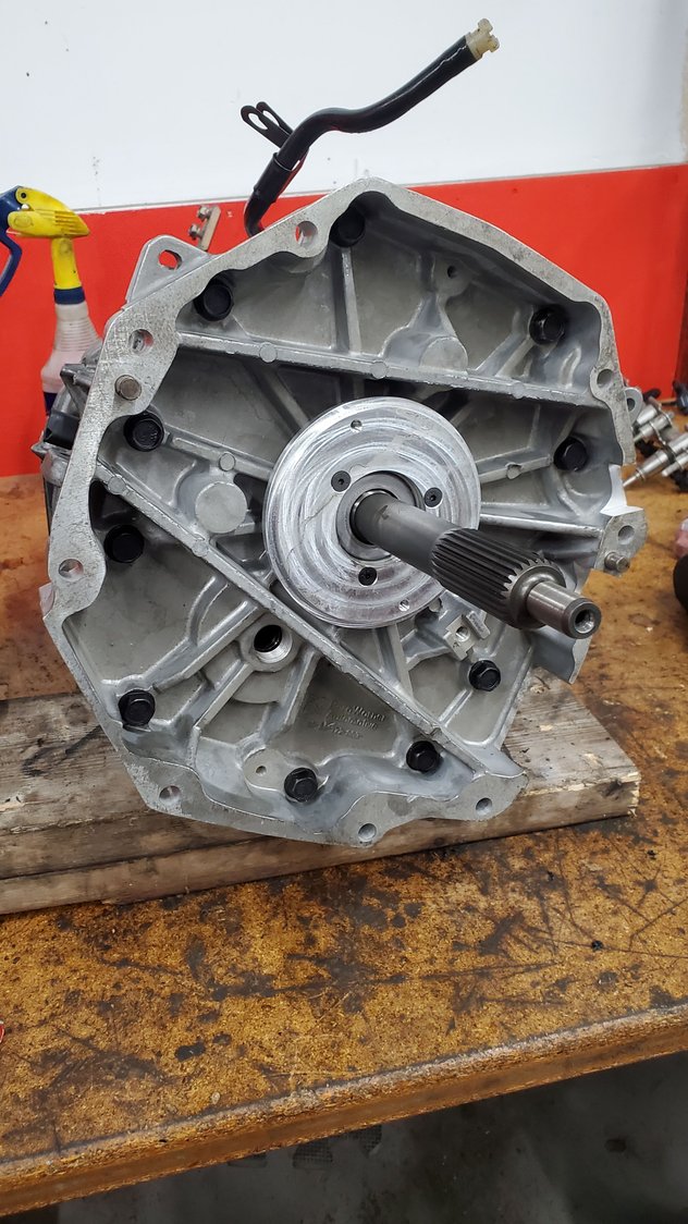

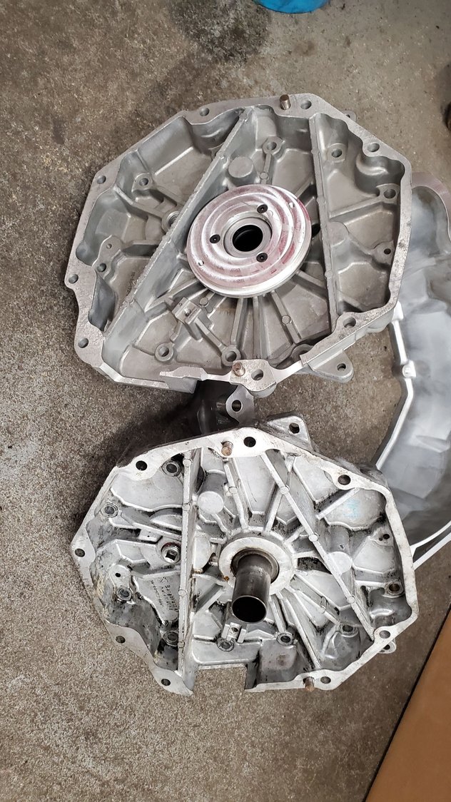

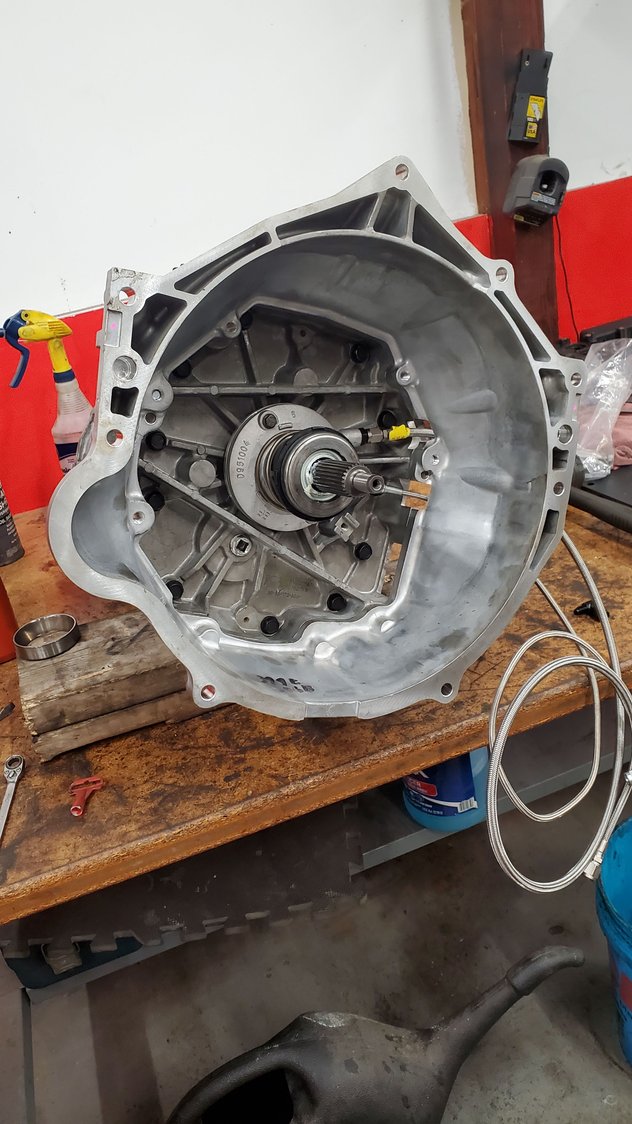

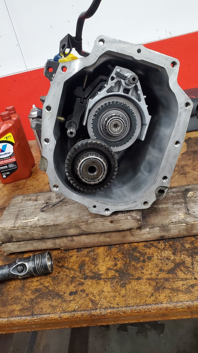

The t56 I had was from an older fbody with lt. I thought it would mate right up to the lq4 being a long crank...wrong... so I got a conversion kit from Rockland gear including the front plate, input shaft,shims and bell housing
Converting t56 from lt to ls
All ready to go in with remote bleeder to make life easier

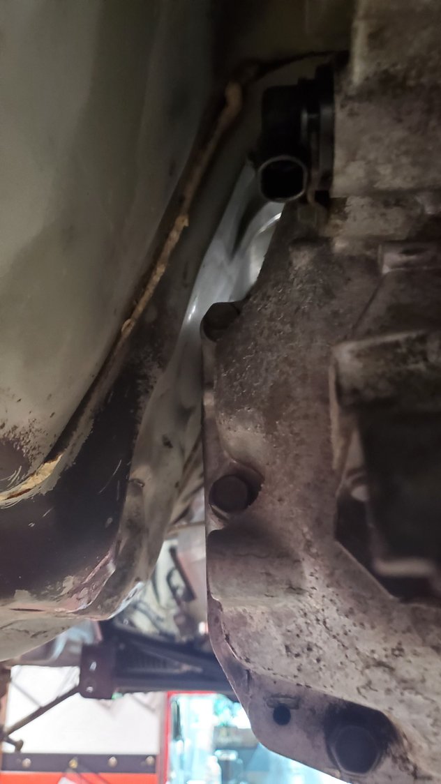

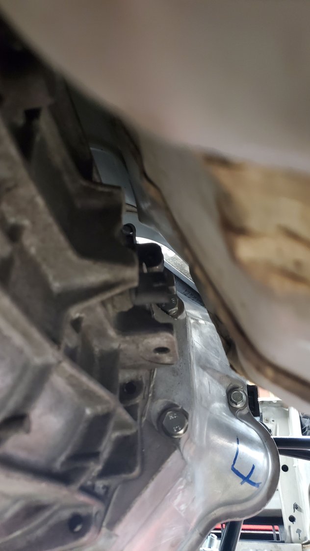

Not much clearence for exhaust...gonna have to run it forward

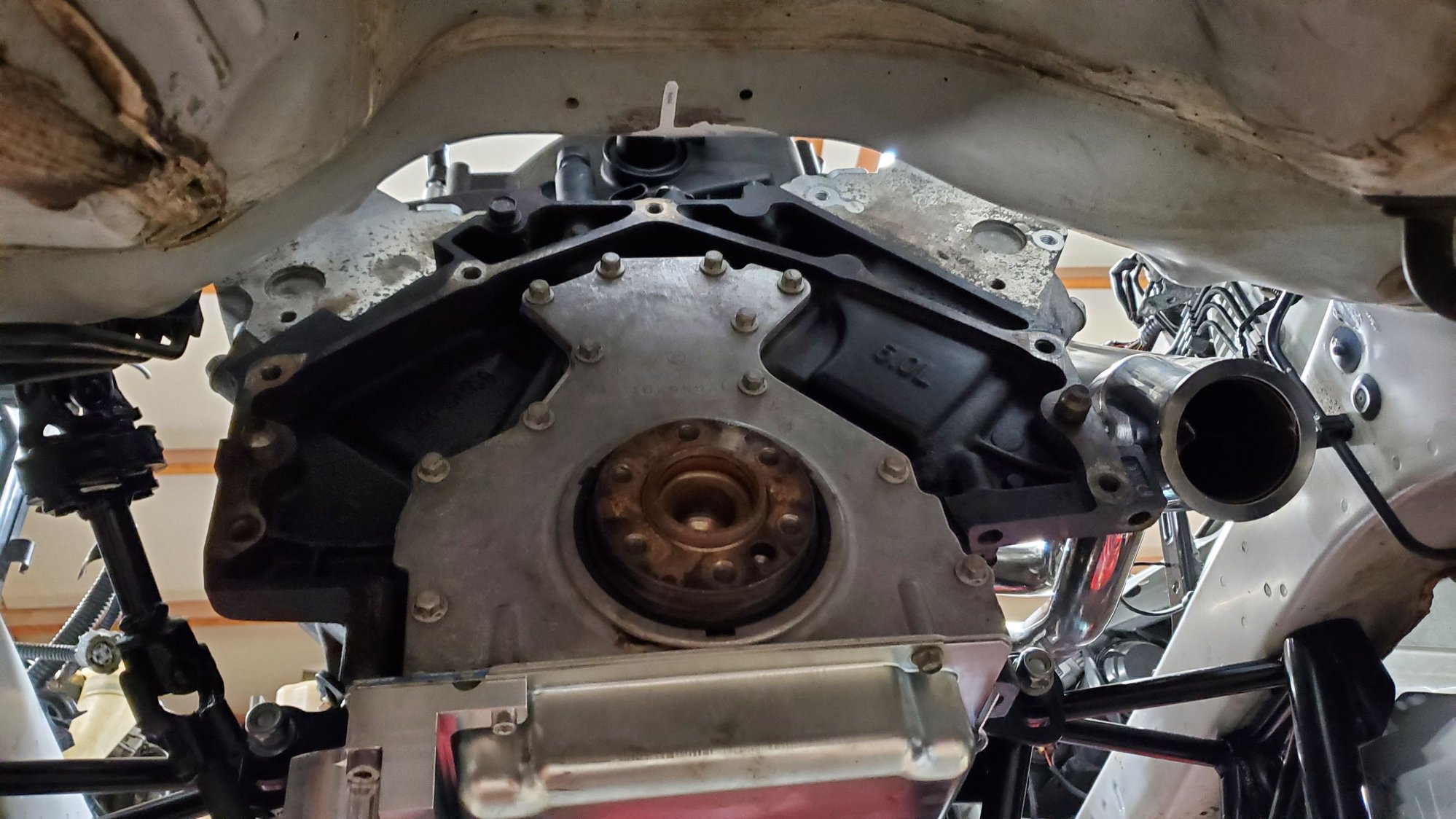

Eww long crank... so i first called mcleod racing asking about clutch and flywheel options for a long crank and a lt t56. They said i would need to convert trans but if i used one of their expensive flywheels i could still use the long crank...well after i got it in i realized that wasn't possible unless I shimmed the block and bell housing 1/2 inch...spacers are expensive not to mention lack of space so out she goes...shoulda swapped cranks when I first had the thing apart

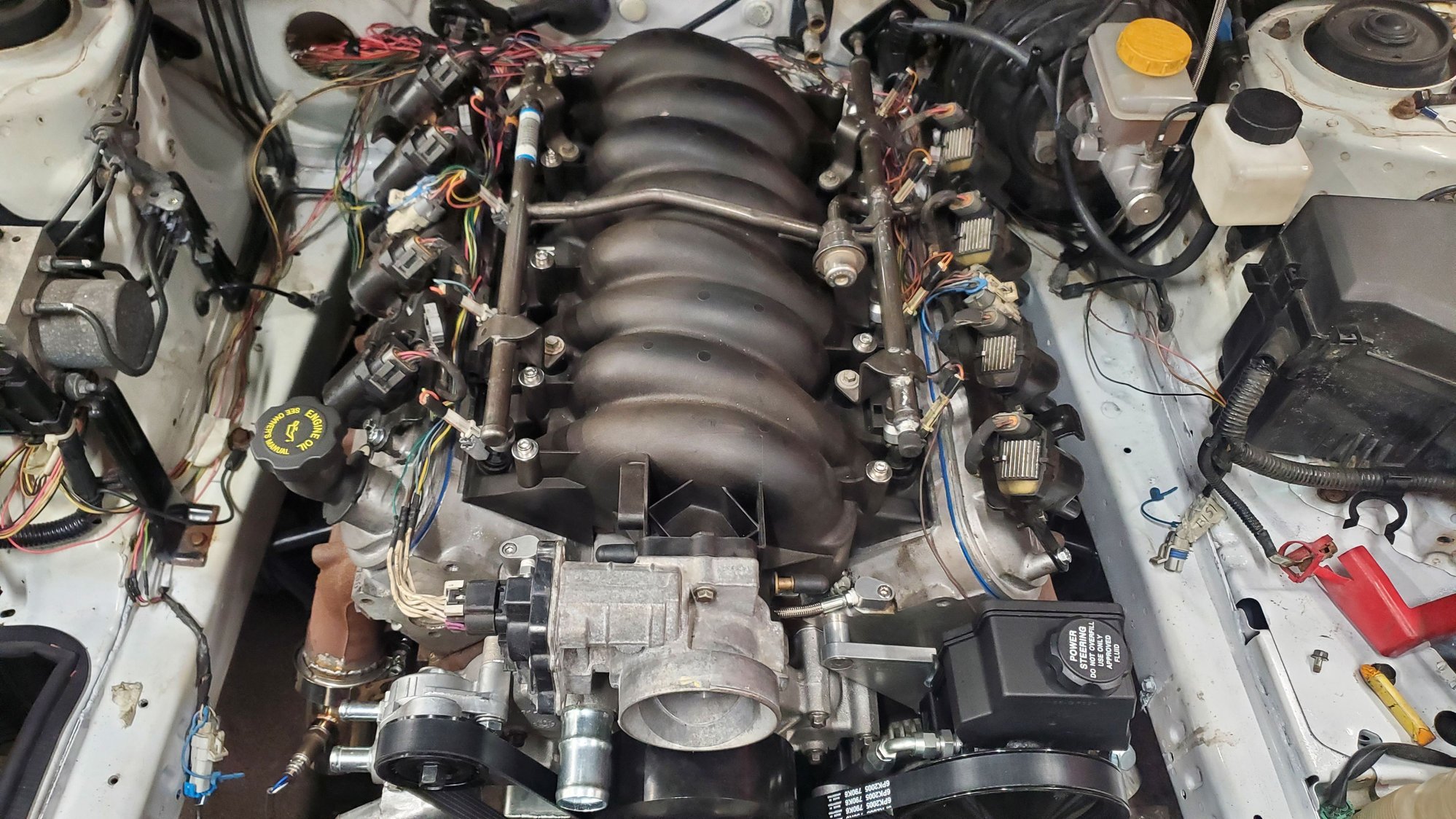

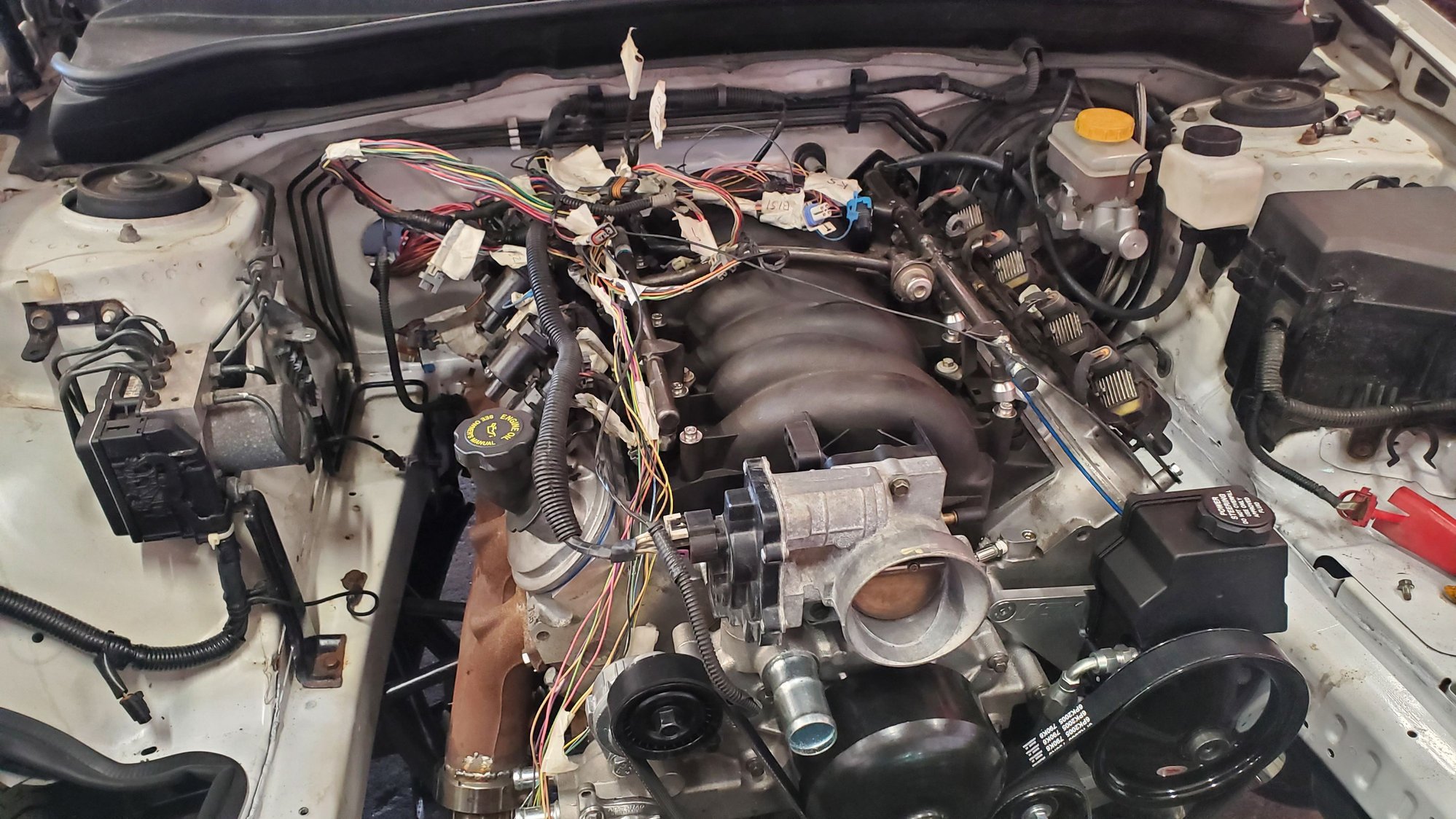

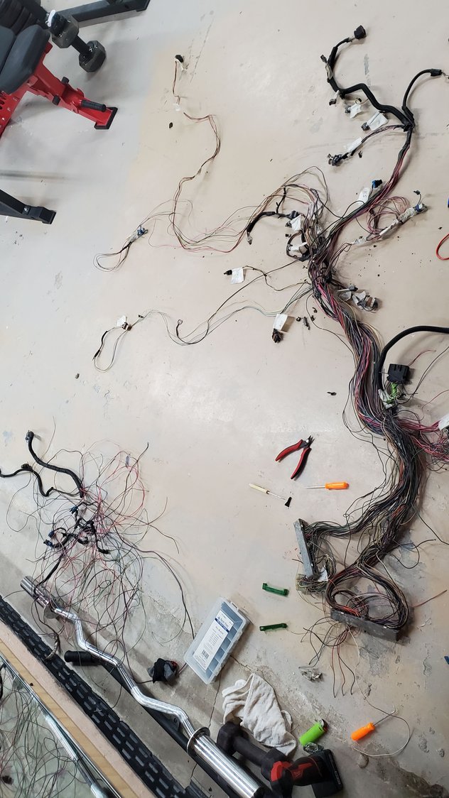

Starting the wiring merge
New short crank in
new crank with new bearings fitted..now it's a proper ls series

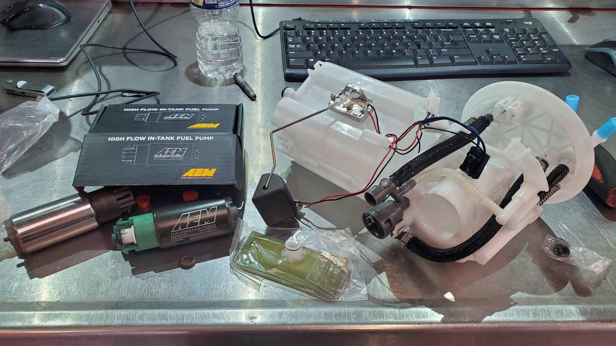

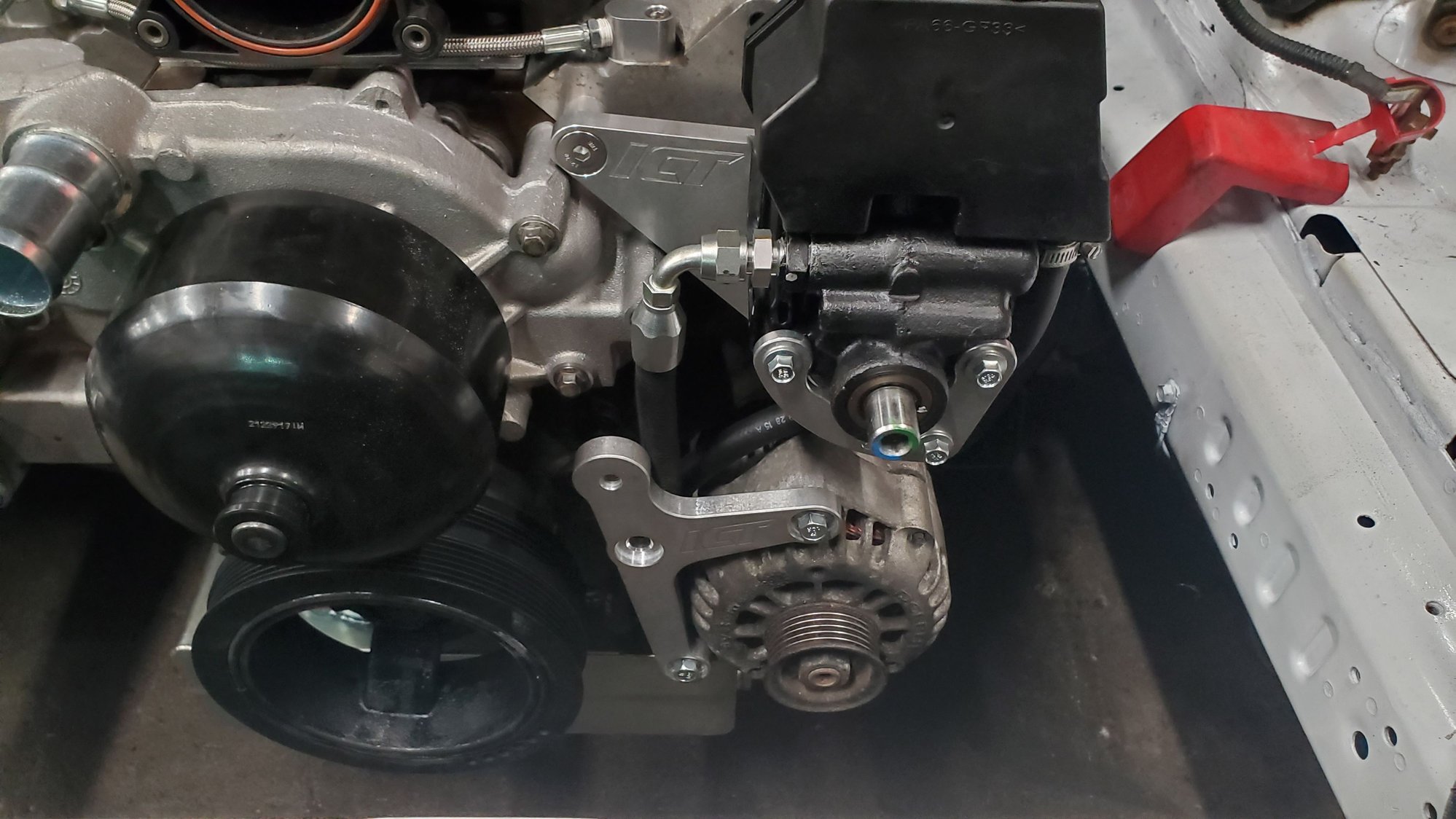

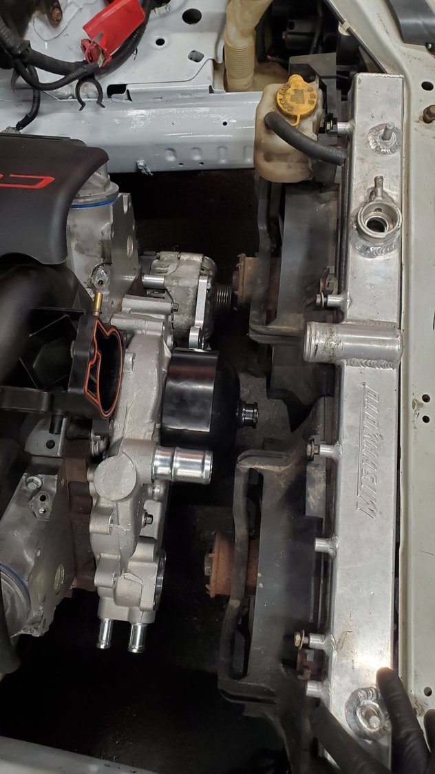

Upgrading fuel pumpt to an aem340
Ram clutch
Just enough space thanks to me clearancing tool
Just enough room
-an fittings on pump and rack

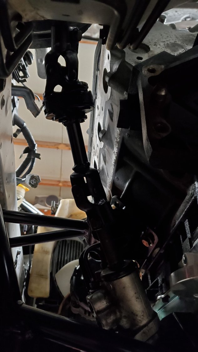

Modified truck manifolds. Gonna flip them and run forward to deal with steering shaft clearance

Now that ecm is behind firewall on right side every wire needed to be relengthed..tedious and time consuming
Sized and routed... after some testing ill loom it up in some sort of way

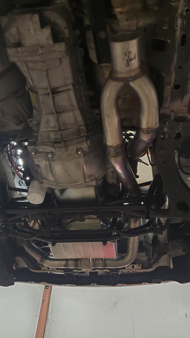

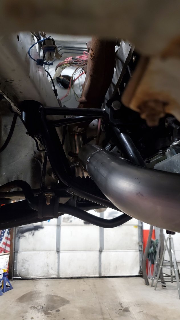

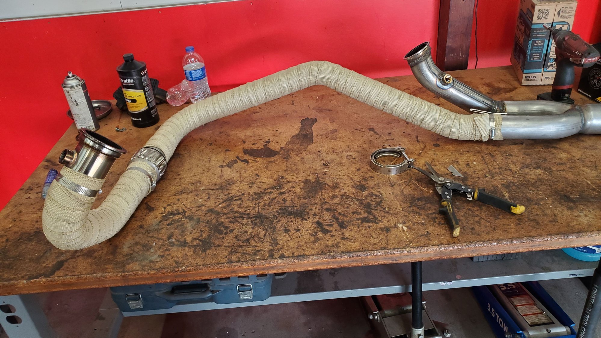

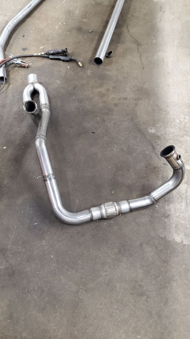

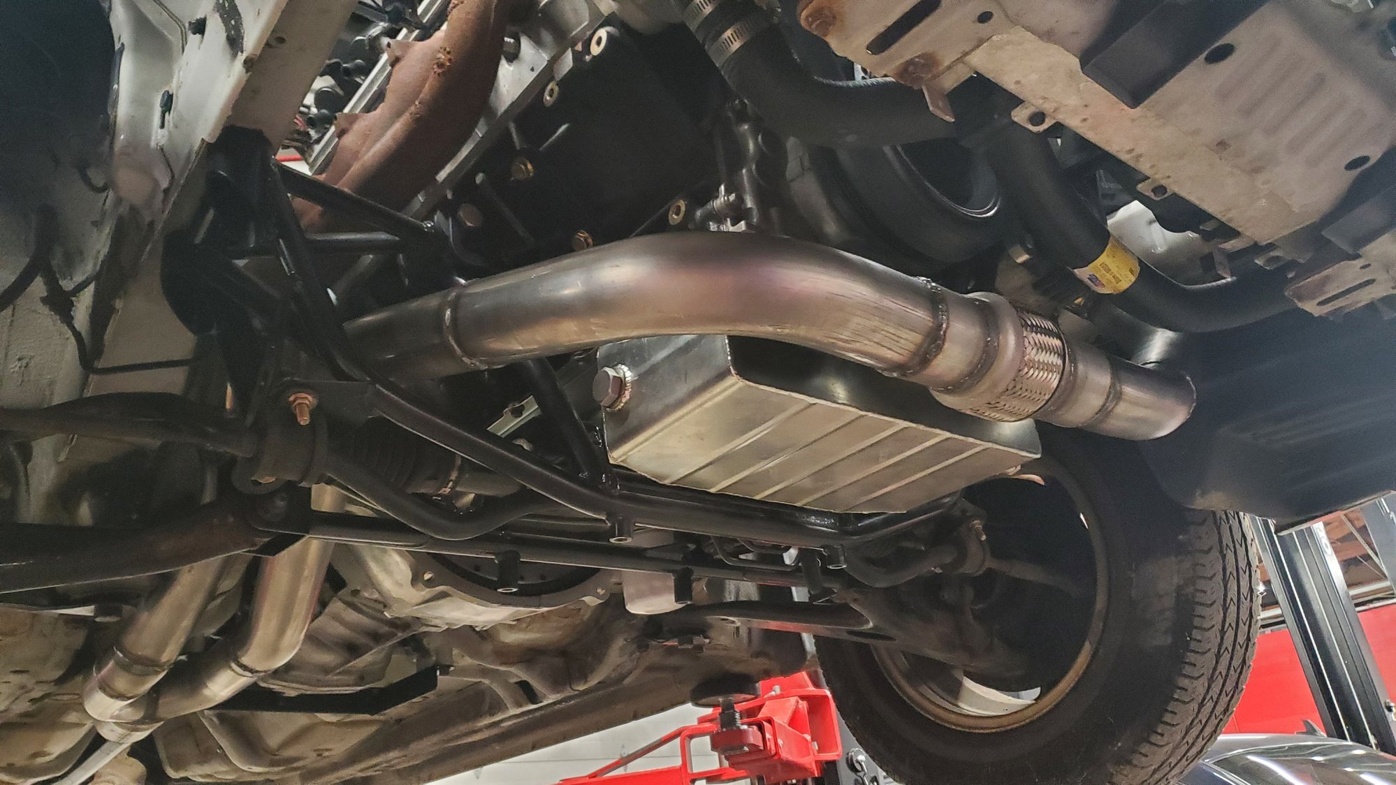

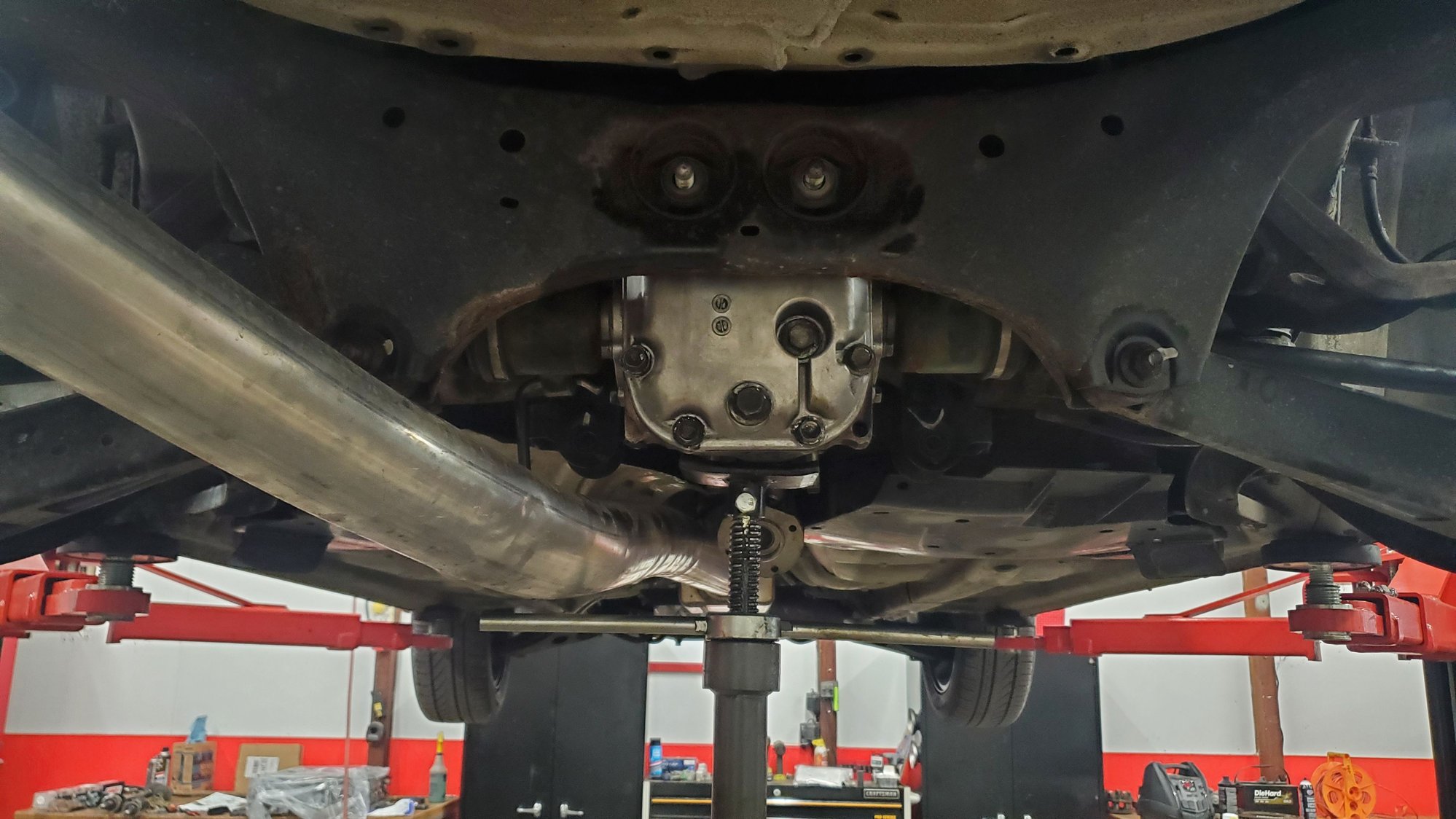

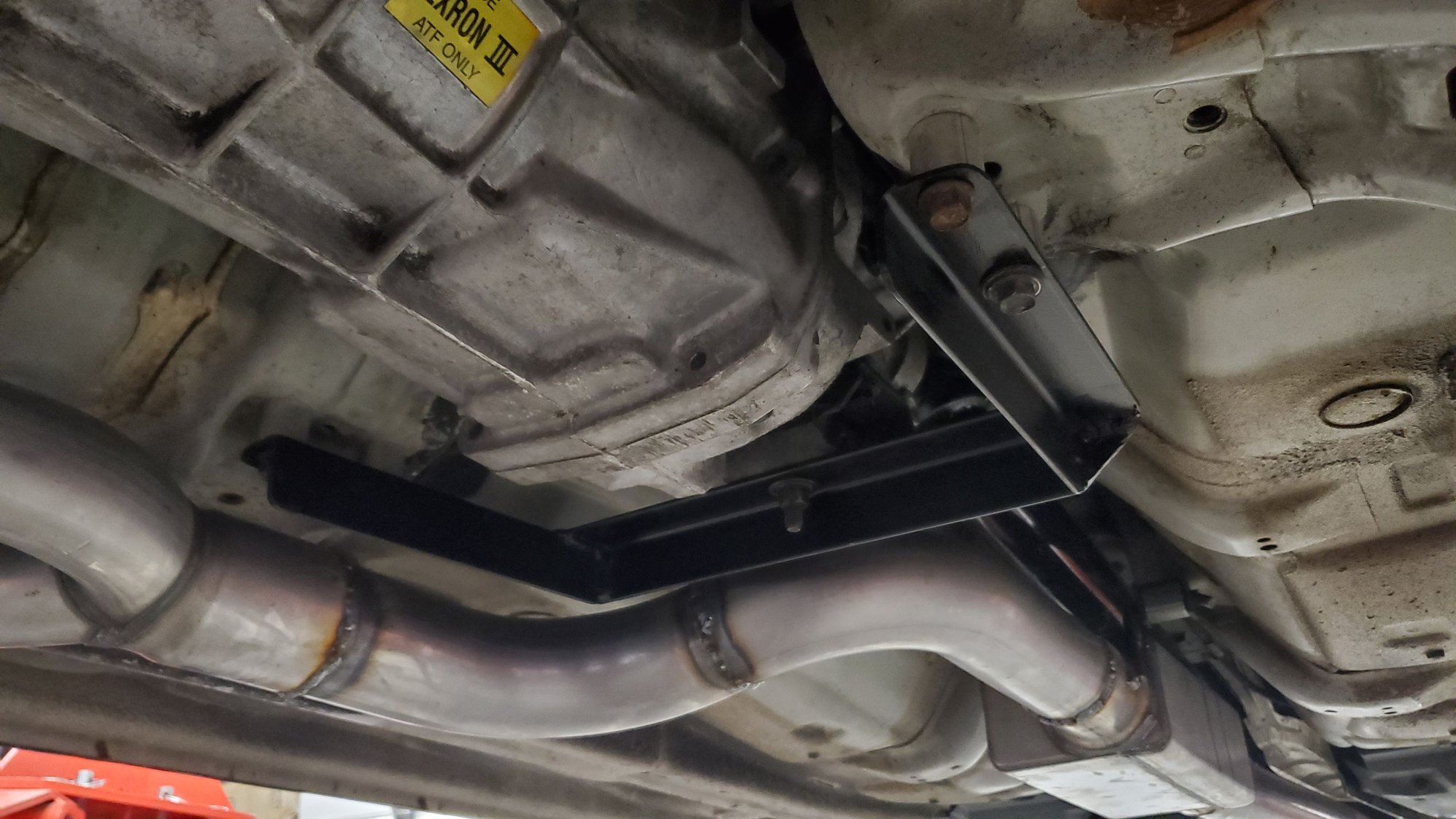

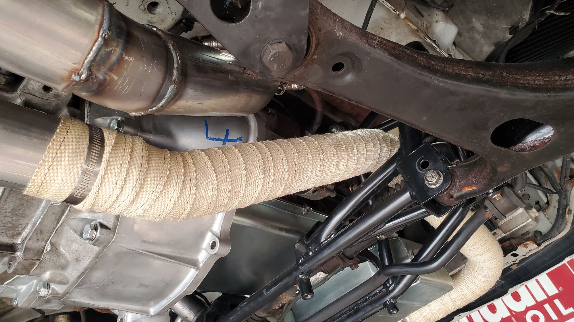

Here is my solution to no space for exhaust to clear steering shaft...this ridiculous y pipe haha... staying true to subaru style with the unequal length.
Im a rookie with the welding and fabbing but got to fit and stay together...so far
Ran it through the frame and met up on the other side
2.5 y to 3
Pulled out to wrap
Looks decent and room to spare
I didnt bother wrapping the other side just heat sheilding on starter and ckp wiring
Snaked around trans back to tunnel and tucked a spintech in there... Didnt have anymore v bands but will add them or band clamps later for serviceability
More wiring... since i moved the ecm to the exact opposite of the factory truck(behind firewall on passenger side) i had to lengthen everything from one bank and shorten the other... literally every wire
All trimmed up

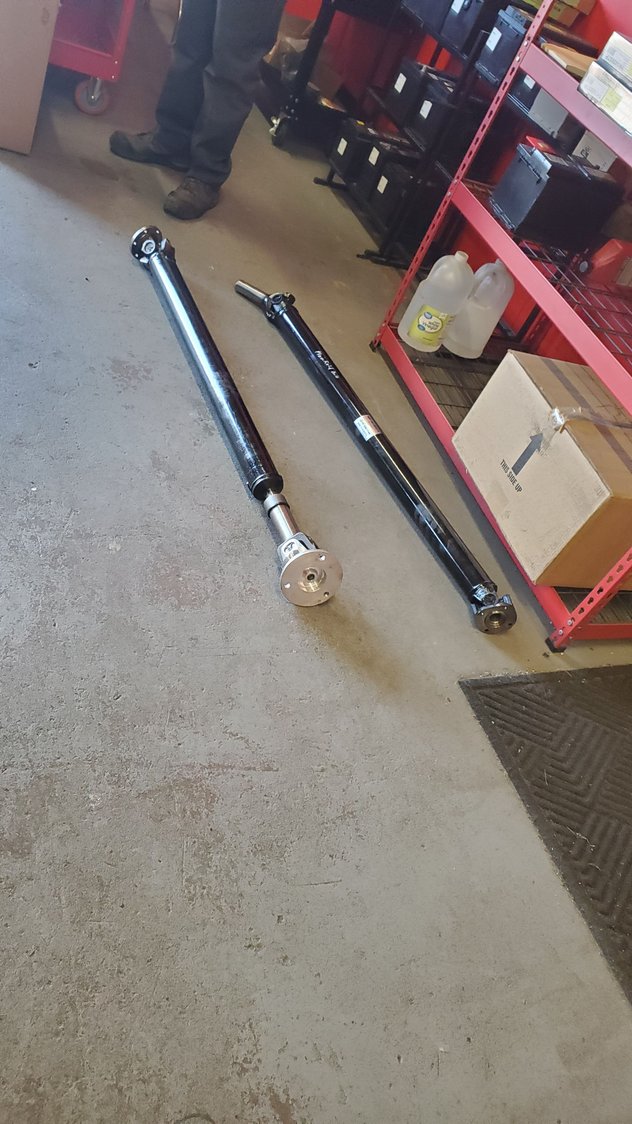

New driveshaft to fit between t56 and little subaru diff
All cleaned up
Old Jun 10, 2023 | 10:34 PM
Posts: 22,308
Likes: 3,625
OK, I'm not seeing something right.
In some pics, the driver manifold exits forward into the crossover which goes past the rear-exiting passenger manifold, then both enter a Y to head rearward.
BUT, in some pics the passenger manifold exits forward. Earlier version?
Old Jun 10, 2023 | 10:39 PM

Ready for test run

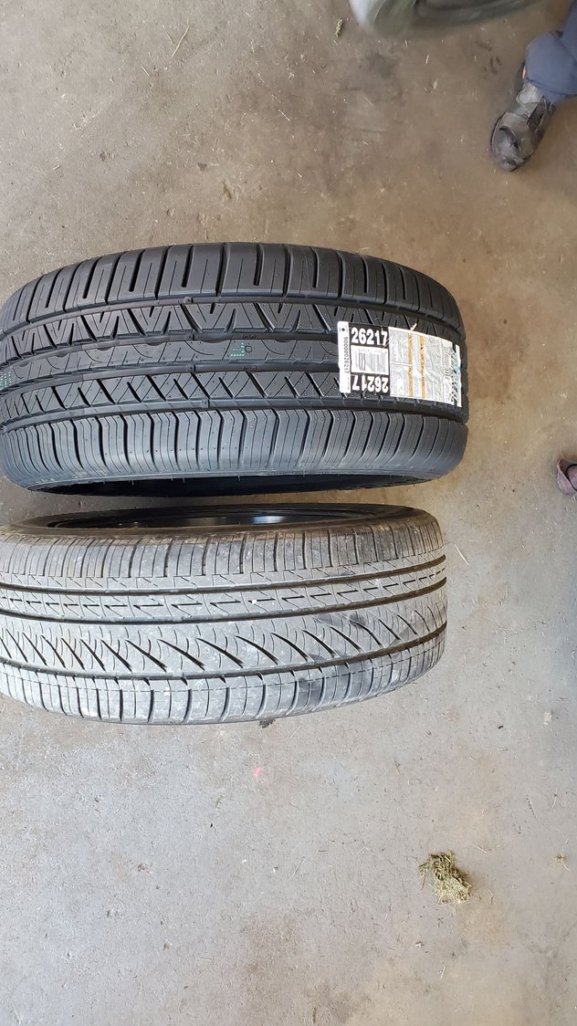

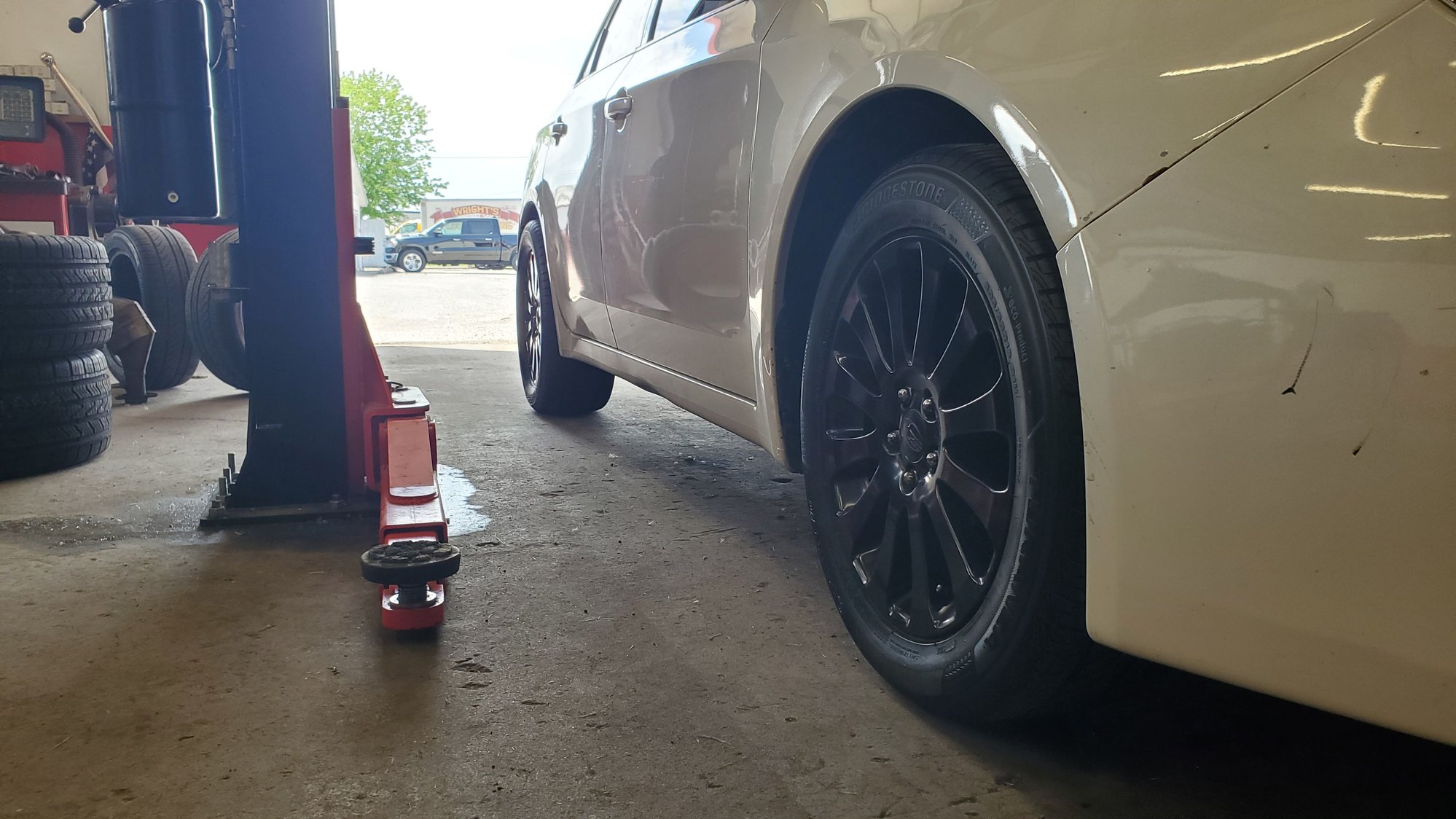

New tires for the back from 205 55 16 to 245 50 16

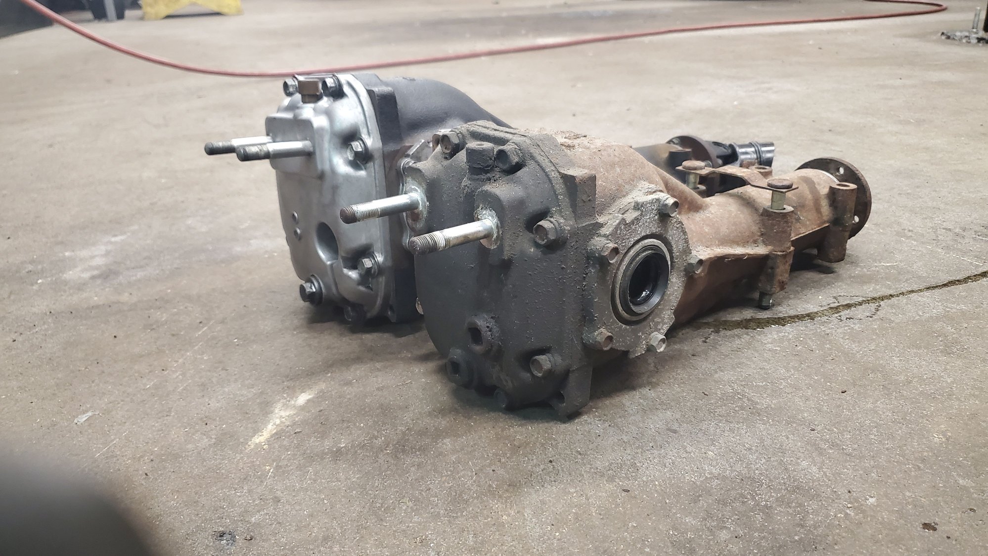

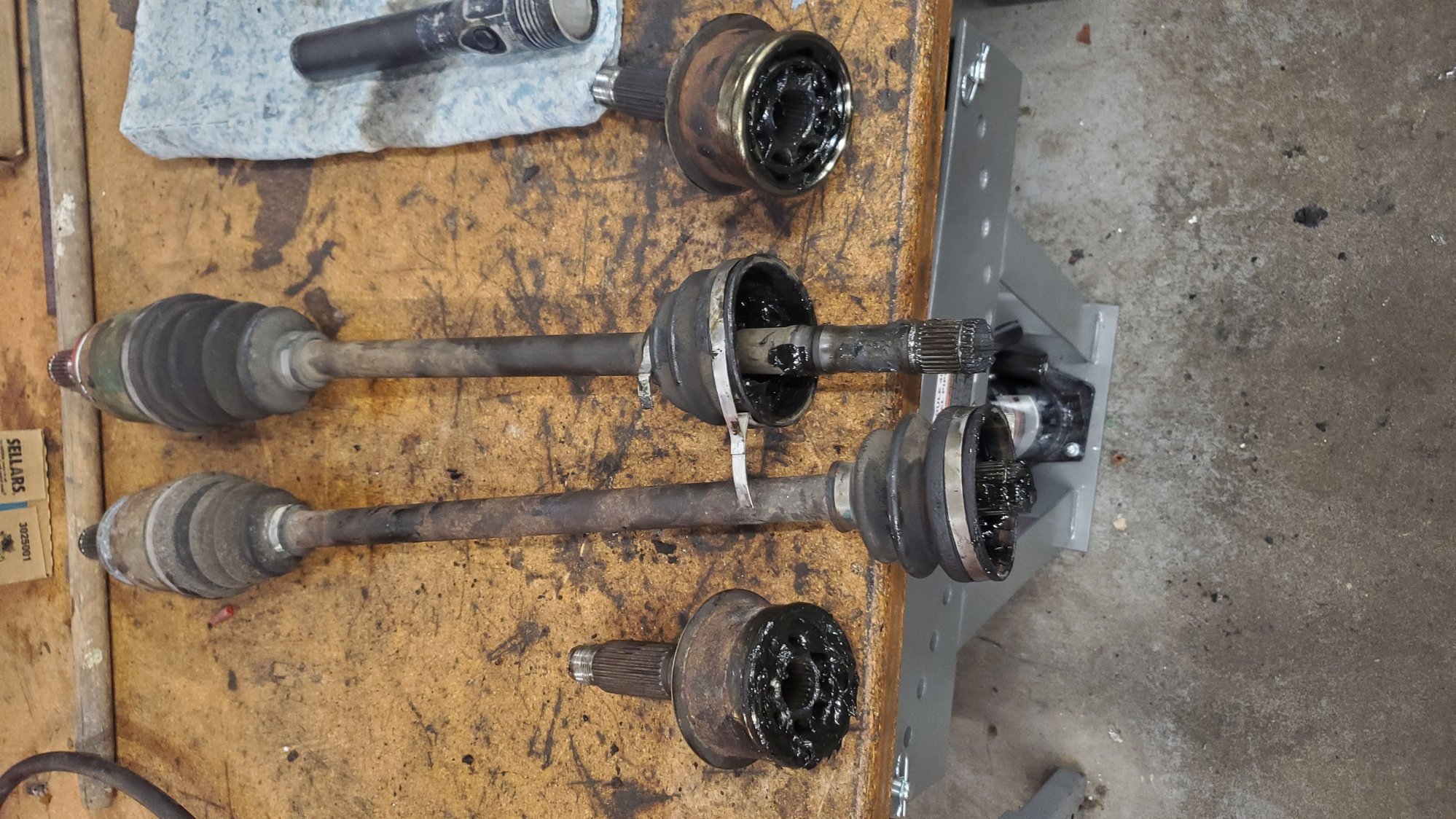

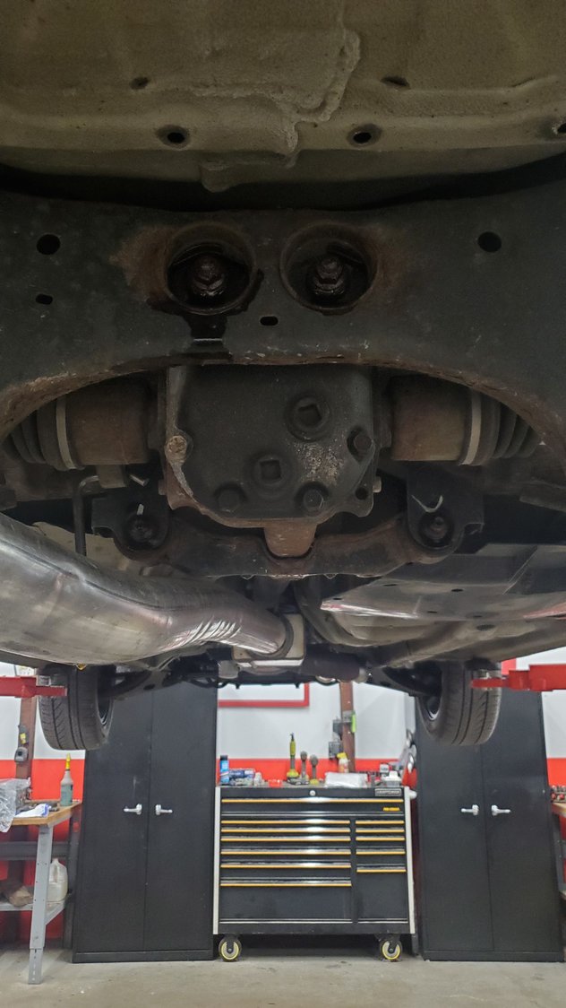

Picked up beefier diff out of a legacy spec B. R180 on the left and r160 on the right
Splines on the new diff are mich bigger and the diff is wider. I got legacy spec b axles with the diff hoping the would have the correct hub side spline but they werent. So i had to make a hybrid axle using the impreza outer cups and bearing races and put them on the other axles
Old tiny r160 diff
New r180 and hybrid axles fit perfect...even used same driveshaft

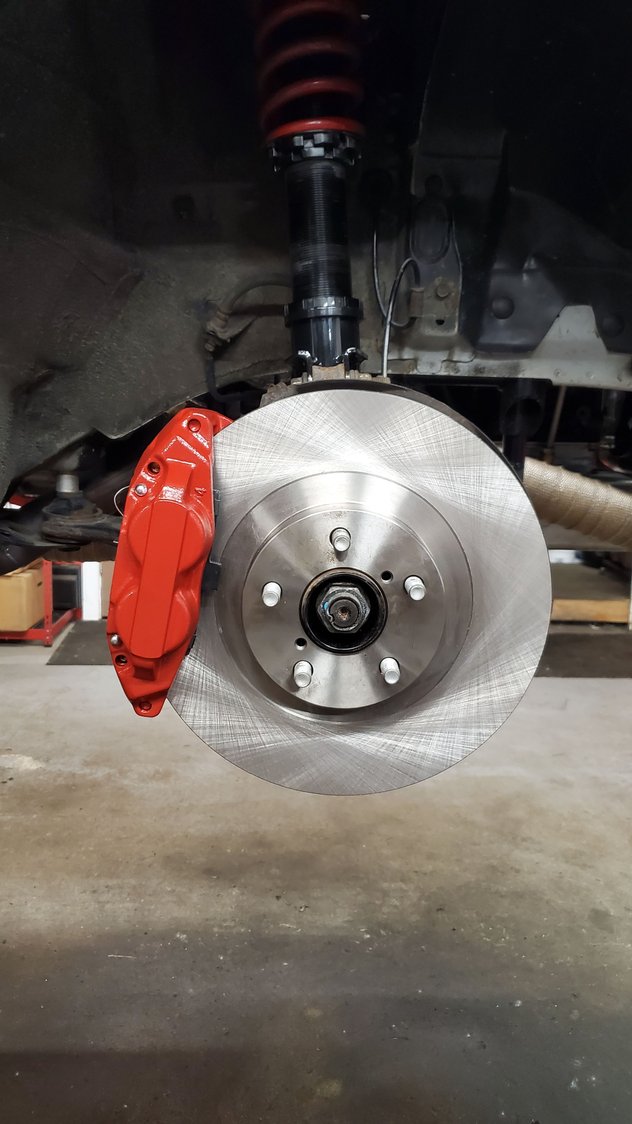

Suspesion was slammed and rode like a brick with all that weight. The 2008 impreza had the softest springs out of any year ever. And the brakes where feeling the weight also. So i got some adjustable coilovers and wrx 4 pot brakes and its soo mich better

Yea I was originally gonna run them both forward and y them but it was gonna be tight with inefficient bends so I got another passenger manifold
Old Jun 10, 2023 | 10:48 PM
Posts: 22,308
Likes: 3,625
Ahh, OK. It turned out really well and should flow pretty decently.
