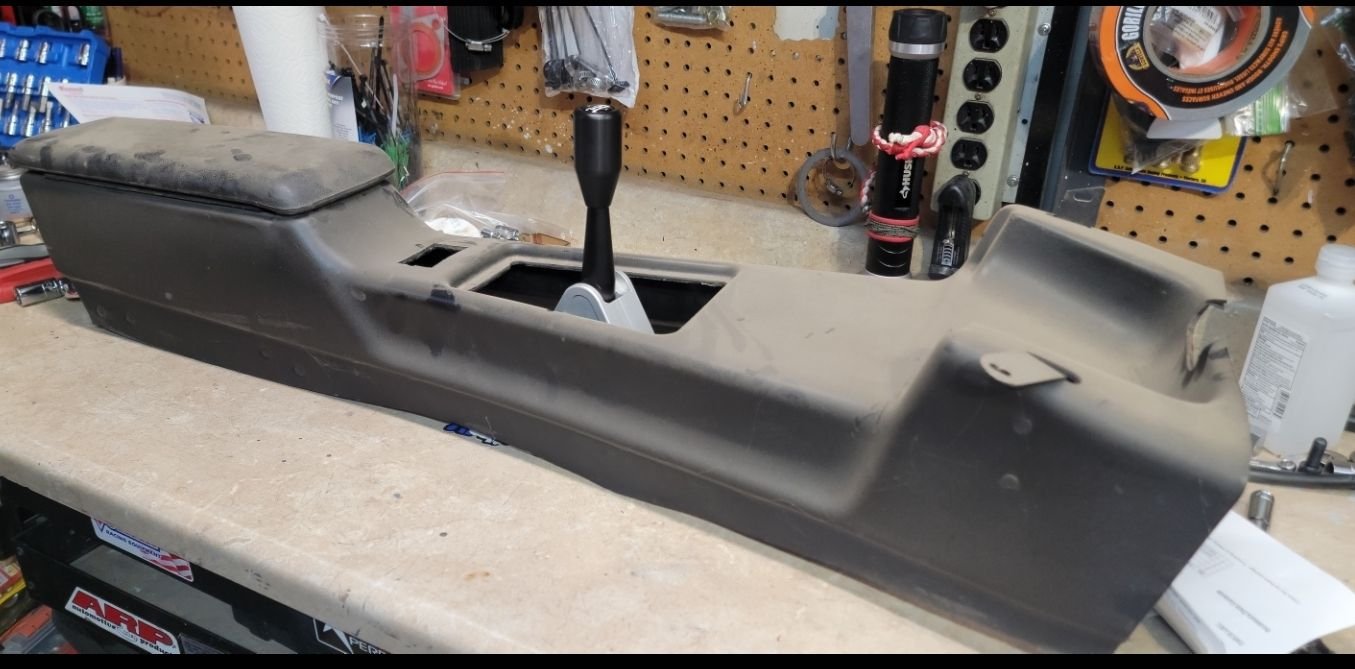

Shifter Pic here(other Pic is too big to upload)

From: Houston, TX
Your cam isn't too far off from mine... You're using the stock converter, correct?
Dang, was hoping for a pic of the shifter installed haha looks nice though! Are you using the BMW shifter?

Yeah stock converter. After running it, I would say it could use a higher stall(you can feel it pulling at idle/drop rpm shifting into drive or reverse)
I am only using this shifter, I'll try to get a picture... It's installed on the floor but need to redo thr console. Plate I made

Here's a picture in the dusty console it's in

Super helpful info, thank you. How are you able to engage Park and reverse with just that shifter?

The TurboLamik allows you to program various moves of the shifter to do different things. So two clicks up might mean Park, just as an example.

Pretty much what Andrew said. Currently it's 2 forward to get to reverse then 1 back to go drive. The shifter is very stiff(in a positive way) so you really can't accidentally bump it.
