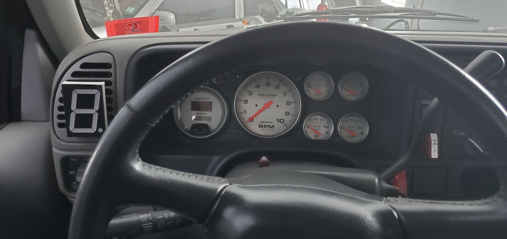

  #373
SCOTT_A's Avatar
Joined: Jan 2010
Posts: 315
Likes: 43
From: Lebanon, NH
To illustrate my interest in this swap into my 95 C1500, below is a picture of where I plan to place a 7 segment display from Turbo Lamik.
I'm in the planning stages and I have searched the Turbo Lamik Facebook Community page. Lots of good info, but what I can't find is solid info on what GM ECMs are compatible with CAN.
The Lamik website lists the following:
60- Camaro SS, Silverado (09-15r) ECU E38
61- Trailblazer, Saab ECU E37
62- LS2 E38
I have a GM 411 pcm in the truck today. It is very clear that the 411 (24X crank reluctor) has no option for CAN and will need analog signals (Brake pedal, TPS, RPM, MAP) to the Lamik TCM.
An option I have is to use the ECM and LS2 from my Saab 9-7X Aero when I no longer need for a winter car. This is an 58X crank and it is known that I need to keep the 58X crank with the ECM. This ECM is a E67. This is where my question lies. The Lamik website lists the E38 and E37 as CAN compatible. The E67 is the same generation as the E38, but is not listed.
So I have 2 questions:
1. Is the E67 ECM compatible with the Lamik using CAN? If yes, will the E67 cut and blip the throttle when commanded by the Lamik during shifts?
2. When using the Lamik with Analog inputs, is the shifting harsh under WOT? , Is the life of the trans greatly reduced when we don't have a way to cut throttle between shifts?
