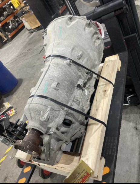

I literally just got back from a 3hr round trip. Picked up a 2021 5.7l charger 8hp70 with 29k miles for $900. This one is going in my 1995 chevy obs pick up build with the CanTcu. The other is for my twin turbo chevelle and using Turbolamik
