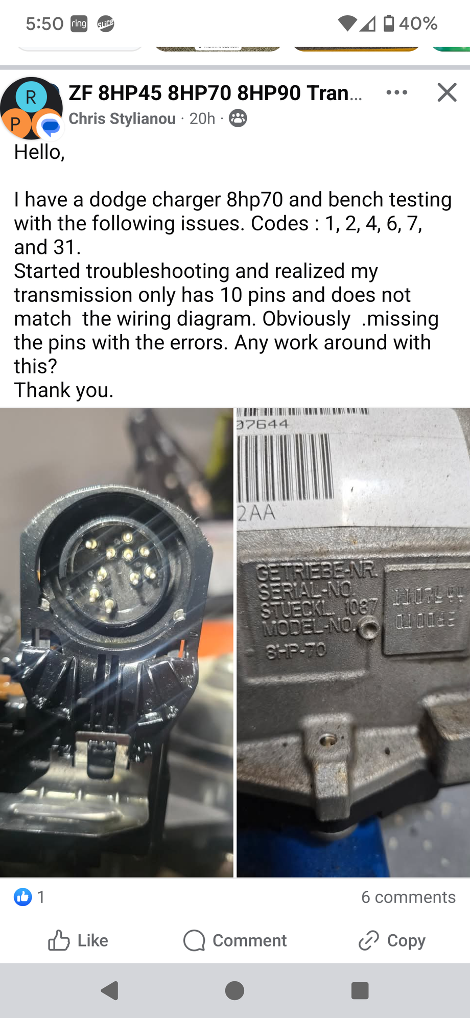

They should probably get that out there before some poor guy cuts up his stock TCU and finds out there is no going back....
Looks like thats already happened. What a shame. Could have been avoided too.

Originally Posted by TurboLamik
These just started to pop up. I have never seen one till few months ago.
so whats the solution/options? I wasnt aware I was supose to be checking my trans before I bought them. This knowledge could ve been helpful prior to the purchasing.

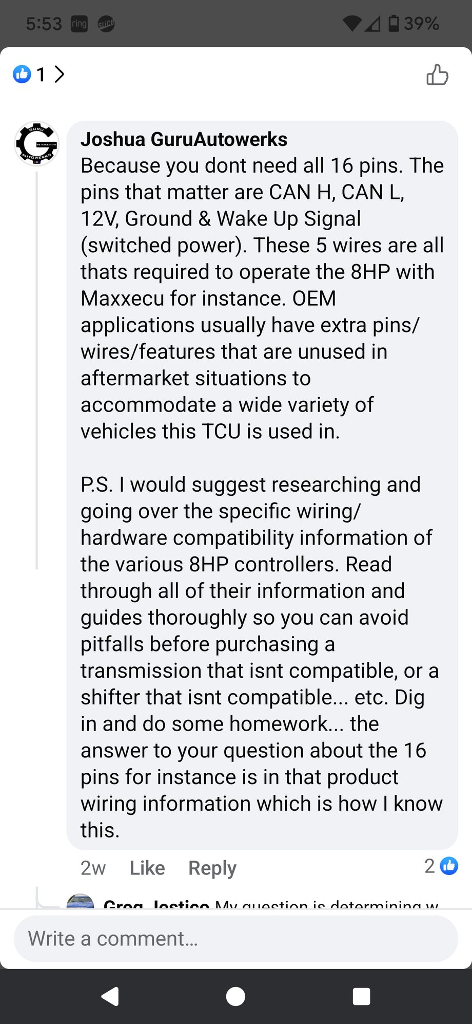

Word is spreading fast on FB it seems...

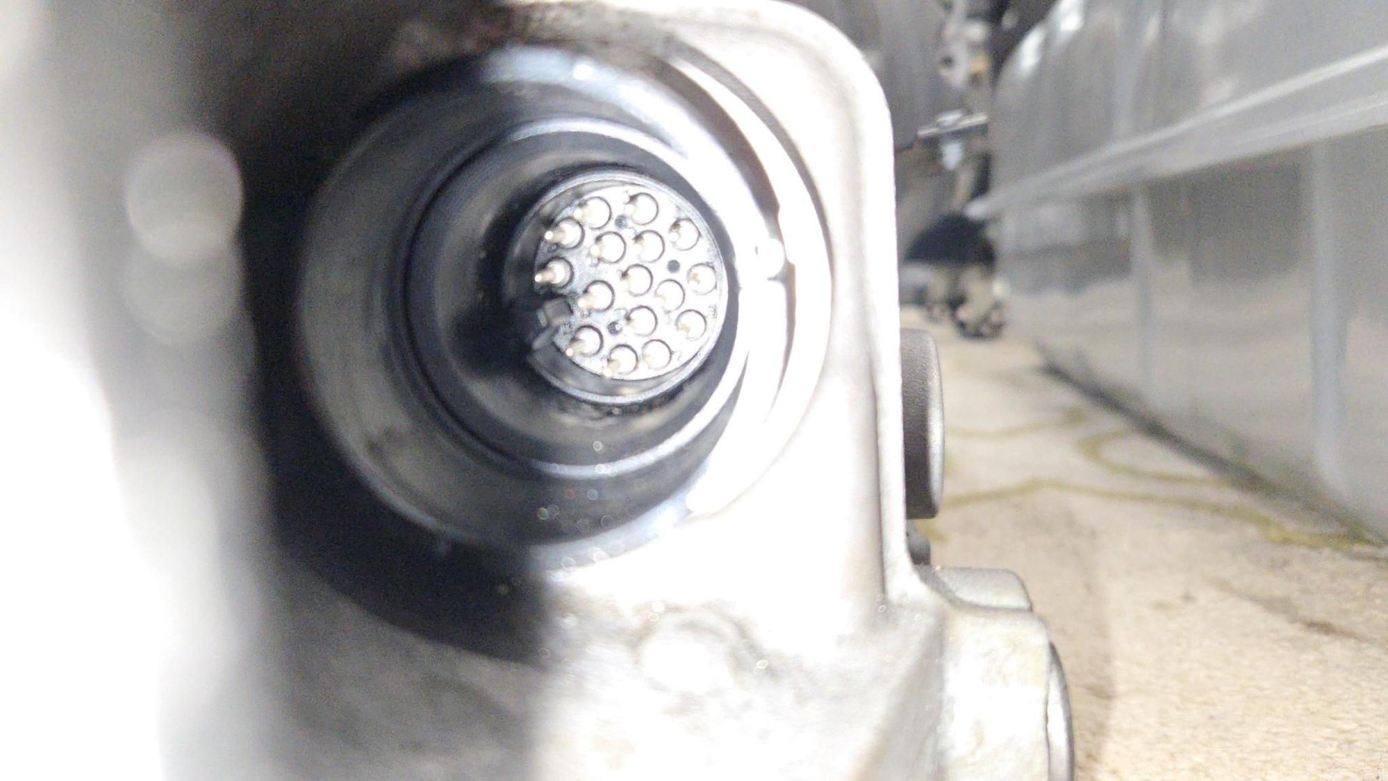

Lucky me. Only 1 of my 8hp70s I have sitting here has a 16 pin connector. Im guessing that would ve been discovered as an issue AFTER you purchased one and tore it down to either soider your own board in or mailed it to turbolamik. I ll have to do some research and see what options there are for the 10pin connector or if its now a paper weight of a trans. Im hoping by running the CanTcu on that one that its compatible. Gunna have to send them an email. I ll report back here fellas. Hate to see anyone else buy an incompaitble trans if thats whats happening.
@TurboLamik feel free to jump in here and clarify.

From: Bayville,NJ

So far , based on Rkupons unit, and the one I have seen, its 21-22 Chargers that have this pin issue. Proooobably 23 as well. Maybe someone who has seen more of these trans' can state what year it started ? All across dodge/ram/jeep products, or ?.
Or you can buy another used TCU assy with the correct pins ? If you want to use Turbolamik
"paper weight of a trans" is a huge over exaggeration
These TCUs without all the pins are a new thing but by all means it should not stop you from purchasing the trans. It is not the end of the world.
The replacement TCUs with all the pins are readily available and can be swapped easily.
45, 50, 51, 70, 75, 76 are same TCUs from TurboLamik point of view and are all interchangeable
90 and 95s have longer speed sensors but otherwise are the same.
Those pins carry signals to our TCUs. Basically connections to all the solenoids, speed sensor and temp so yes, they are all needed
They are required for the operation but this is why TurboLamik can do what it does as its a full standalone and not just a CAN gateway with limited funcionality
