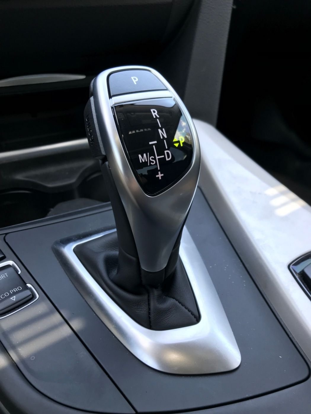

What about shifter options with the tlc?
Any bmw of this style?
Old Feb 8, 2025 | 08:08 AM
  #329
Project GatTagO's Avatar
Joined: Mar 2003
Posts: 10,604
Likes: 1,881
From: Little Austin
https://manual.turbolamik.eu/SupportedCANSelectors.html
The new A90 Supra and the Dodge T Handle shifters are also supported.

Old Feb 8, 2025 | 08:17 AM
  #330
Bbknucks's Avatar
Joined: Dec 2022
Posts: 443
Likes: 157
Exactly what I was looking for.
Thanks Andrew
