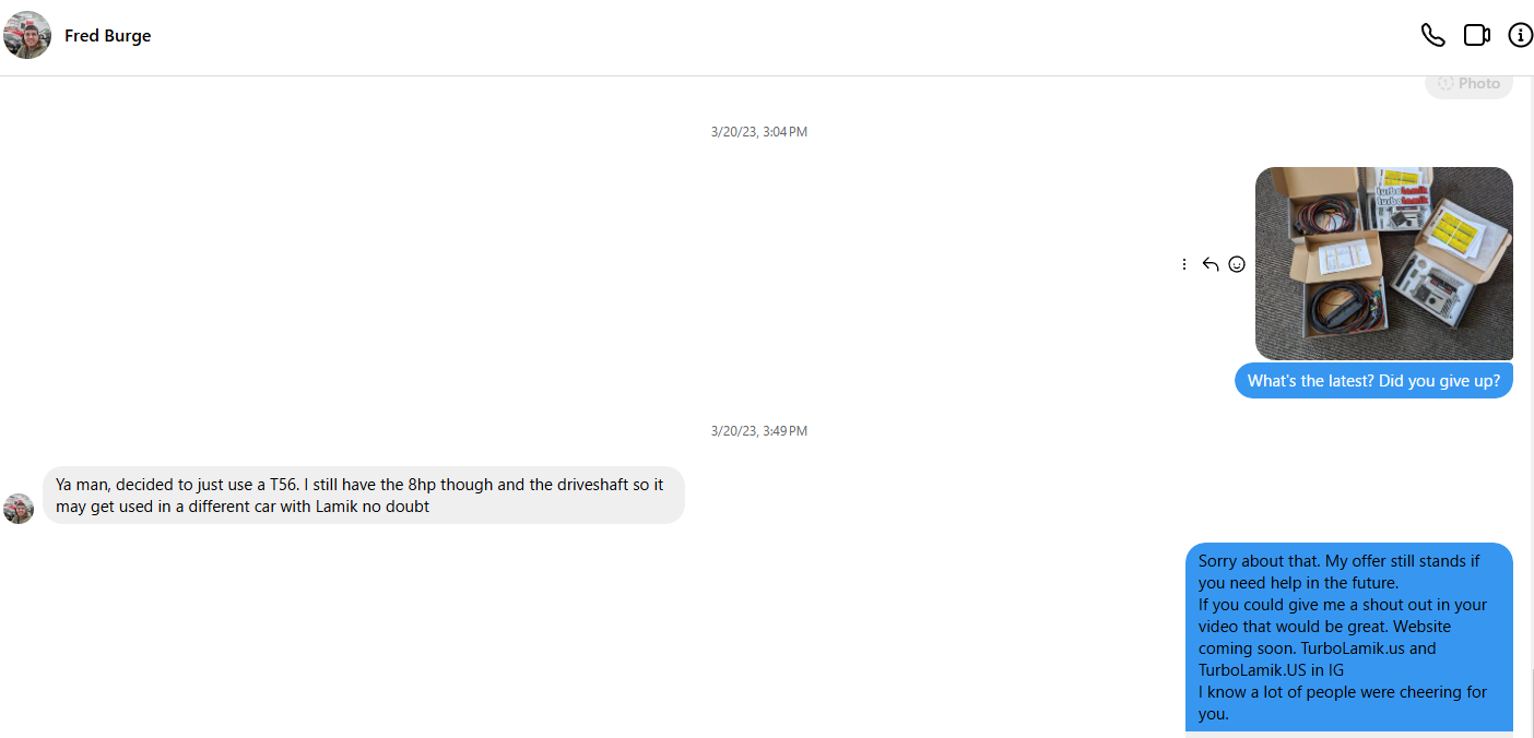

PLEASE CORRECT YOUR POST. HE WAS USING HTG CONTROLLER THAT HAD MANY ISSUES
I actually reached out to him when he had issues and offered assistance as he is in St Louis and I'm in Chicago. I actually said if he is willing to drive here then I would install the controller test and if he's happy with the performance then he can pay me my cost but at this point he was so frustrated that he just was ready to give up but that doesn't mean the swaps don't work.
HTG GCU
HTG GCU
