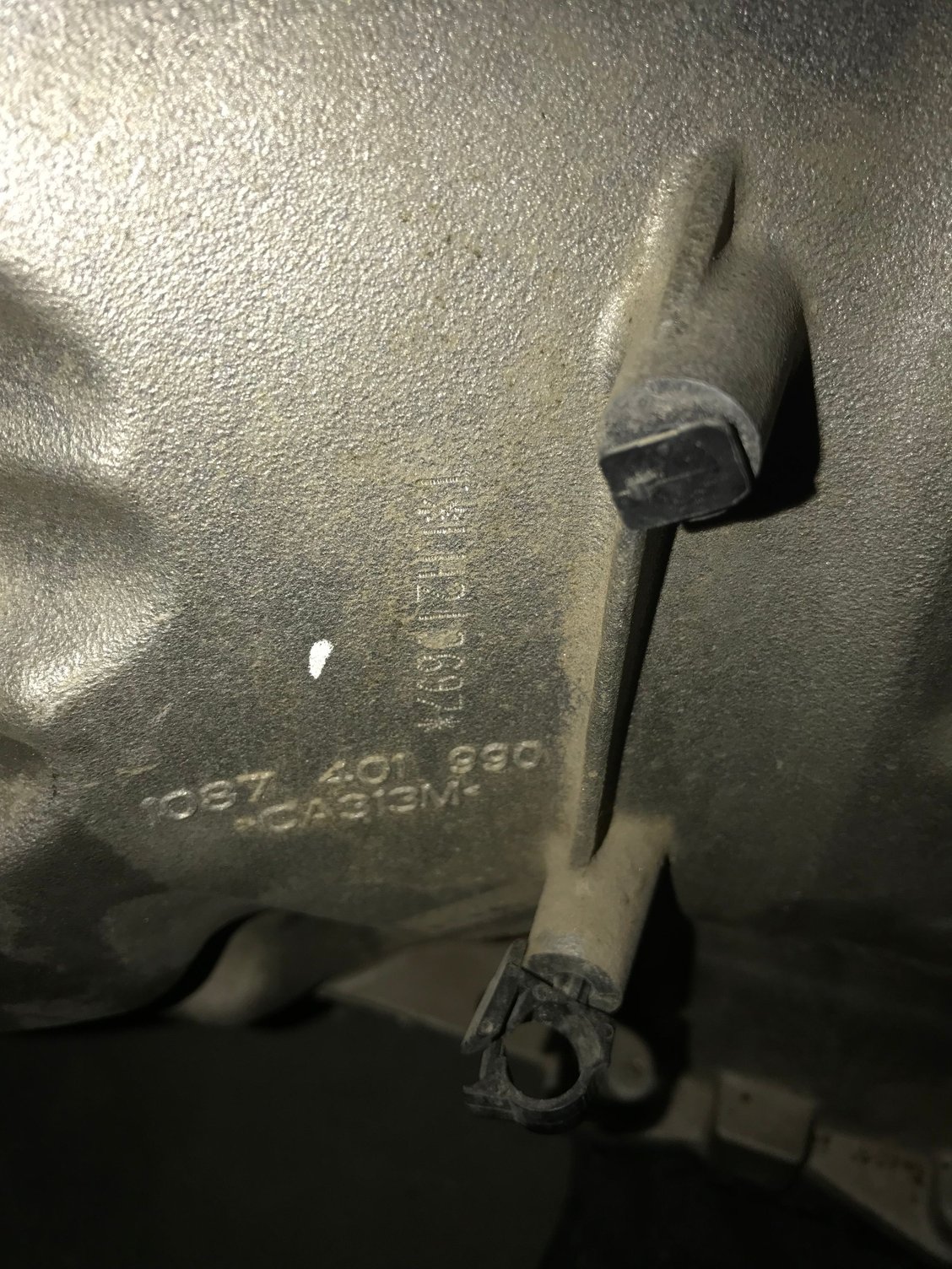

So for those that are trying to determine what 8HP70 transmission they're buying there is a partial VIN stamped on the forward part of the Bell Housing. I have enclosed a picture of mine.
You will be able to determine the exact year from the partial VIN.
I was able to determine the complete VIN from this number and verify that the trans I bought is from a 2020 Charger 5.7 R with 20,400 miles.
Also this 2020 trans has all the pins in the TCU plug.

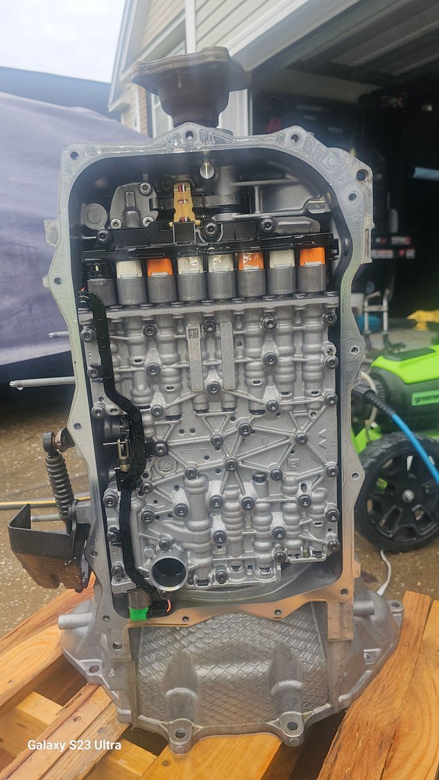

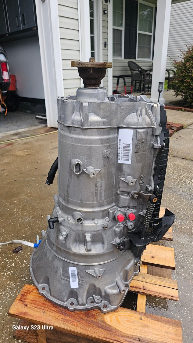

This was a low mileage 8HP70 from a RWD Dodge car. It is already modified for use with the TurboLamik TCU.
I swapped in a new oil pan which also has the filter assembly built in.
I am waiting on Amazon to deliver a new 5th Gen Camaro starter, which is what the Cougar has already. I will mock it up with the DomiWorks adapter do see where the transmission bellhousing needs to be notched to clear the starter nose.
