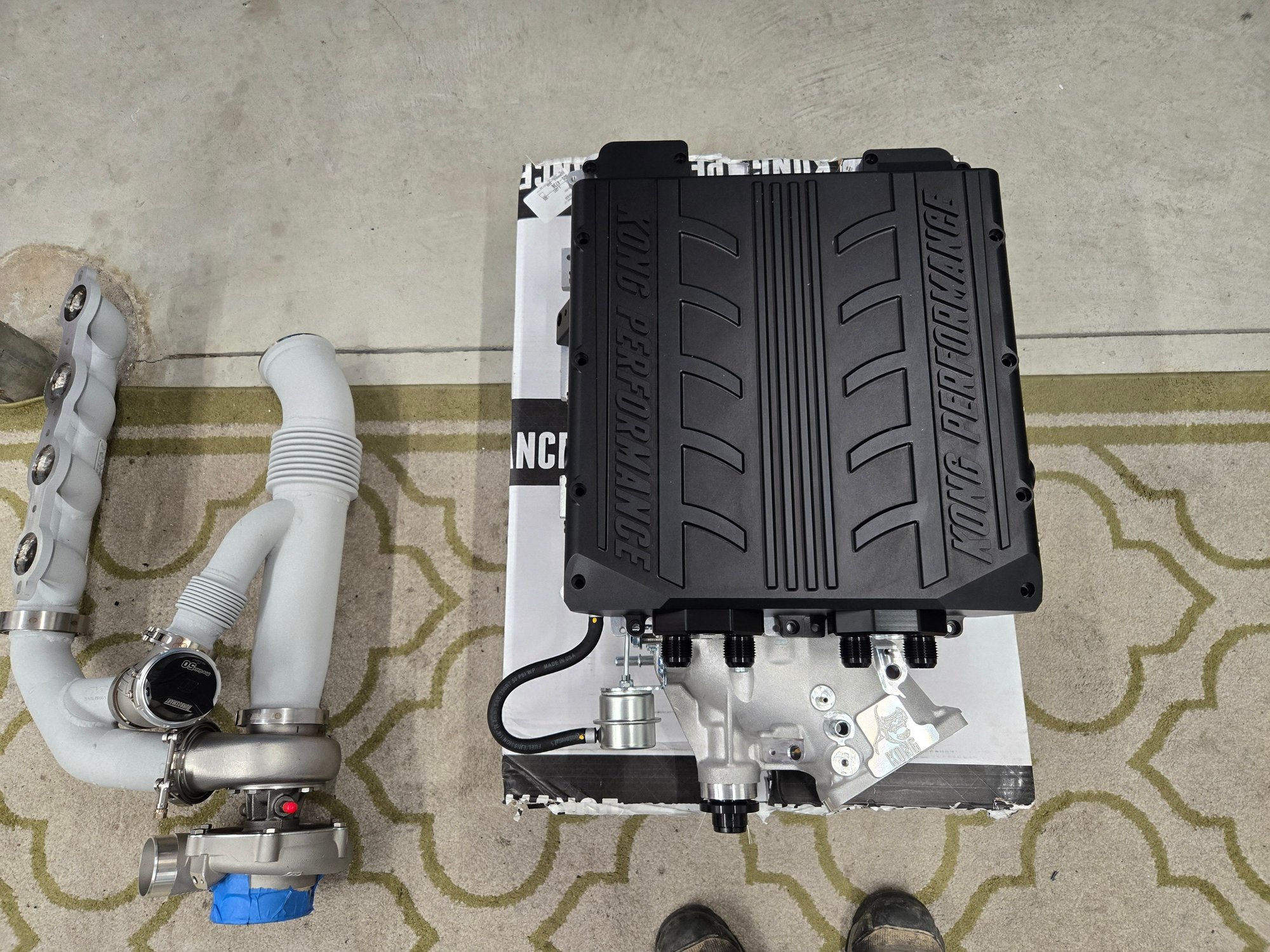

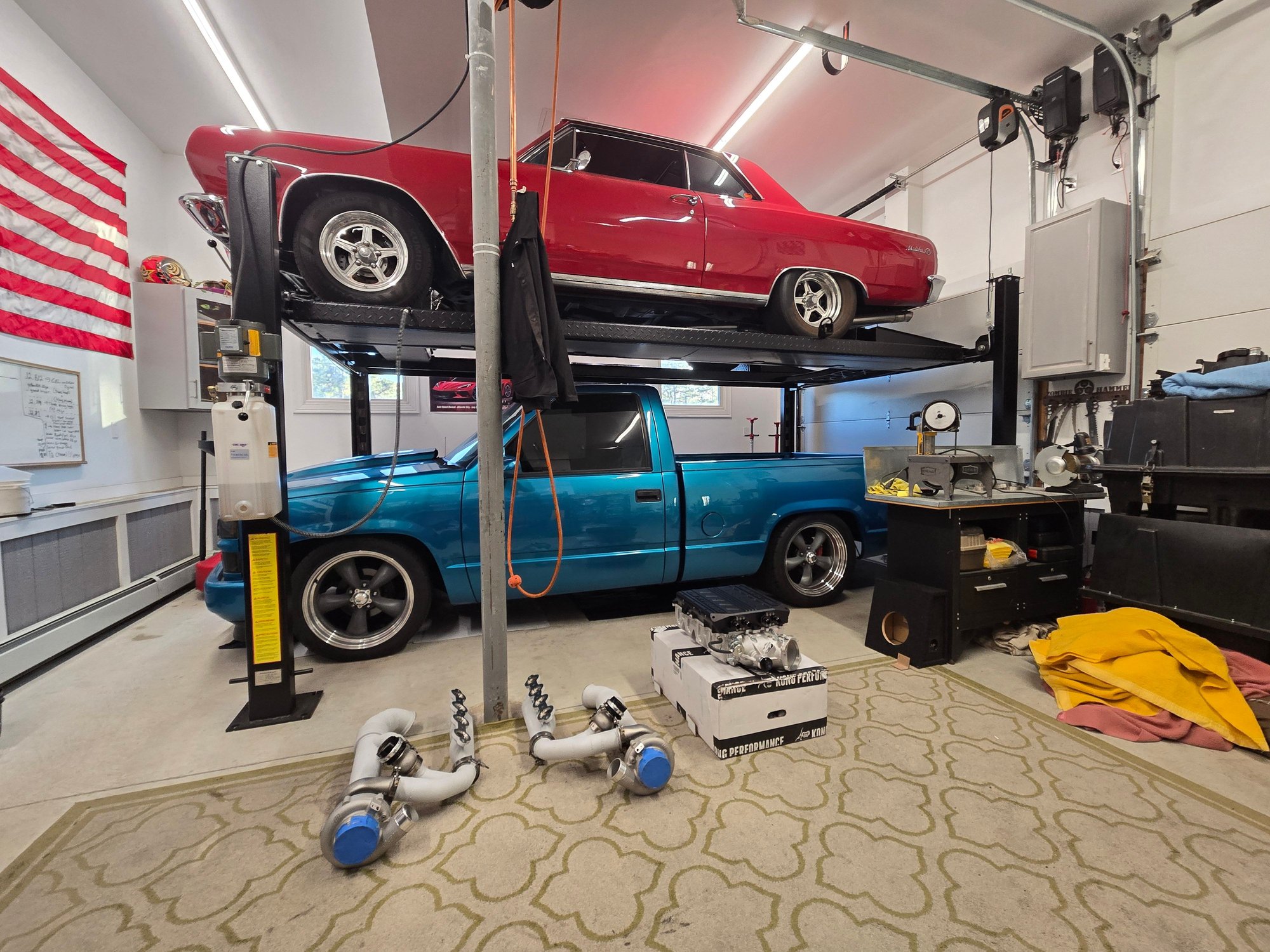

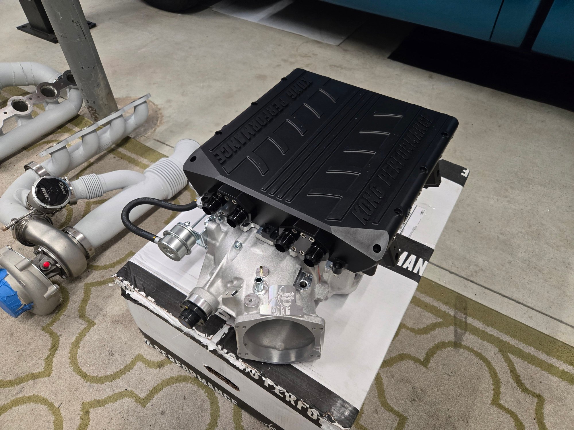

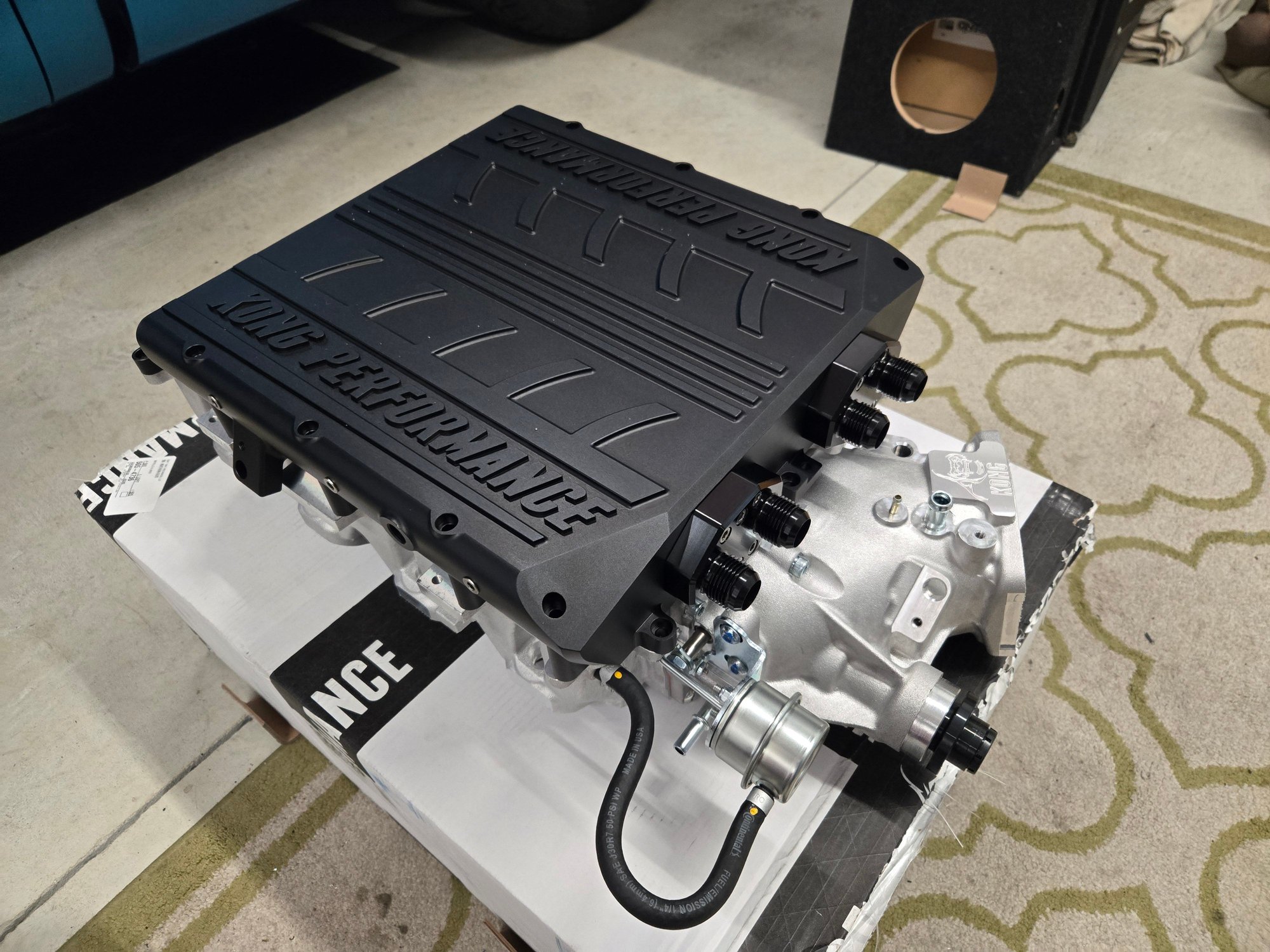

Huge shoutout to Andrew, Dr Efi. We got my OBS up and running today. Got the Ls and 8hp70 driving nicely with Holley Dominator and TurboLamik! Kong LSA2650 up next!
