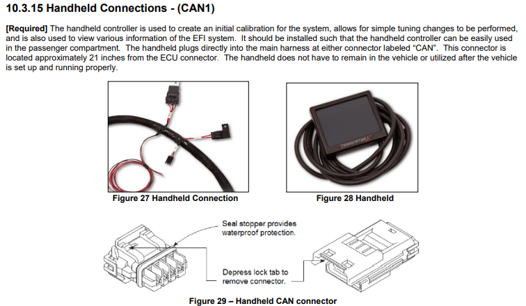

Old Aug 31, 2025 | 05:44 PM
  #537
chase1873's Avatar
Joined: Jul 2010
Posts: 6
From: North East
Hey, where specifically do you connect the CAN wires from the turbolamik to the holley terminator. Best I can tell the only CAN lines on my holley are used for the handheld and/or laptop via a splitter. Is this where the lamik hooks up? If so, can it be split three ways so I can run the trans, laptop and handheld at the same time?
I would appreciate specific connector and pin information so I can make this connection. Also any info about setting up communication between the terminator and lamik would be nice. Please link some threads if this has been explained already.
Also, regarding starters. I bought Powermaster PowerMax Plus Starters 9109 from Summit for $173. Looks like no cutting required.
Part Number: PWM-9109
https://www.summitracing.com/parts/p...4aAkJOEALw_wcB
Old Sep 1, 2025 | 10:03 AM

Do you have a Terminator X or a Terminator X Max?
Andrew
Old Sep 1, 2025 | 11:31 PM
  #539
chase1873's Avatar
Joined: Jul 2010
Posts: 6
From: North East
Andrew
Terminator X Max for gen III LS
Old Sep 2, 2025 | 06:39 AM
  #540
Project GatTagO's Avatar
Joined: Mar 2003
Posts: 10,604
Likes: 1,881
From: Little Austin
The TL orange/black goes to pin 20 on J3 and the orange/brown goes to pin 14 on J3. That's the CAN2 . Email me if you have any questions. projectgattago at Gmail dot com
Andrew
