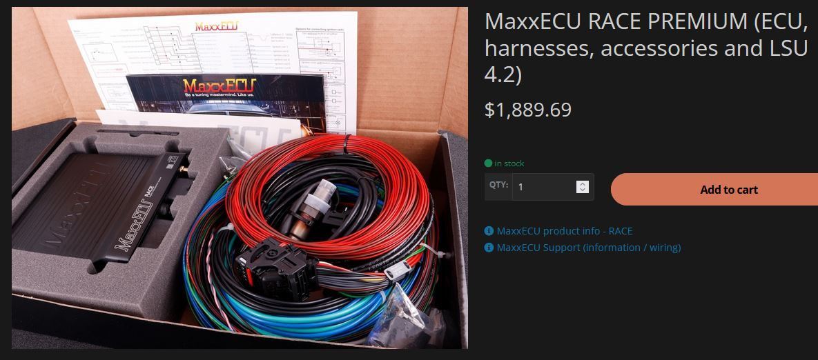

Looking into MaxxECU it can control the 8HP as a stand alone control, you just need a few inputs for it to work, its not as feature rich as the Turbolamik but $2K is just too much for this build just for trans control alone, I could get a Maxx Race to control both engine and trans for that much, or get a Maxx mini and Holly TermX which has a lot more LS support. . . .

I got the maxxECU race with the flying lead harness. Includes a wideband and can run the LS engine and 8HP or DCT and others. You need to terminate your own connectors. They have pre built LS harnesses, but I feel I need to modify any pre-built harness anyway, to make them fit better, so I go with the flying lead.
