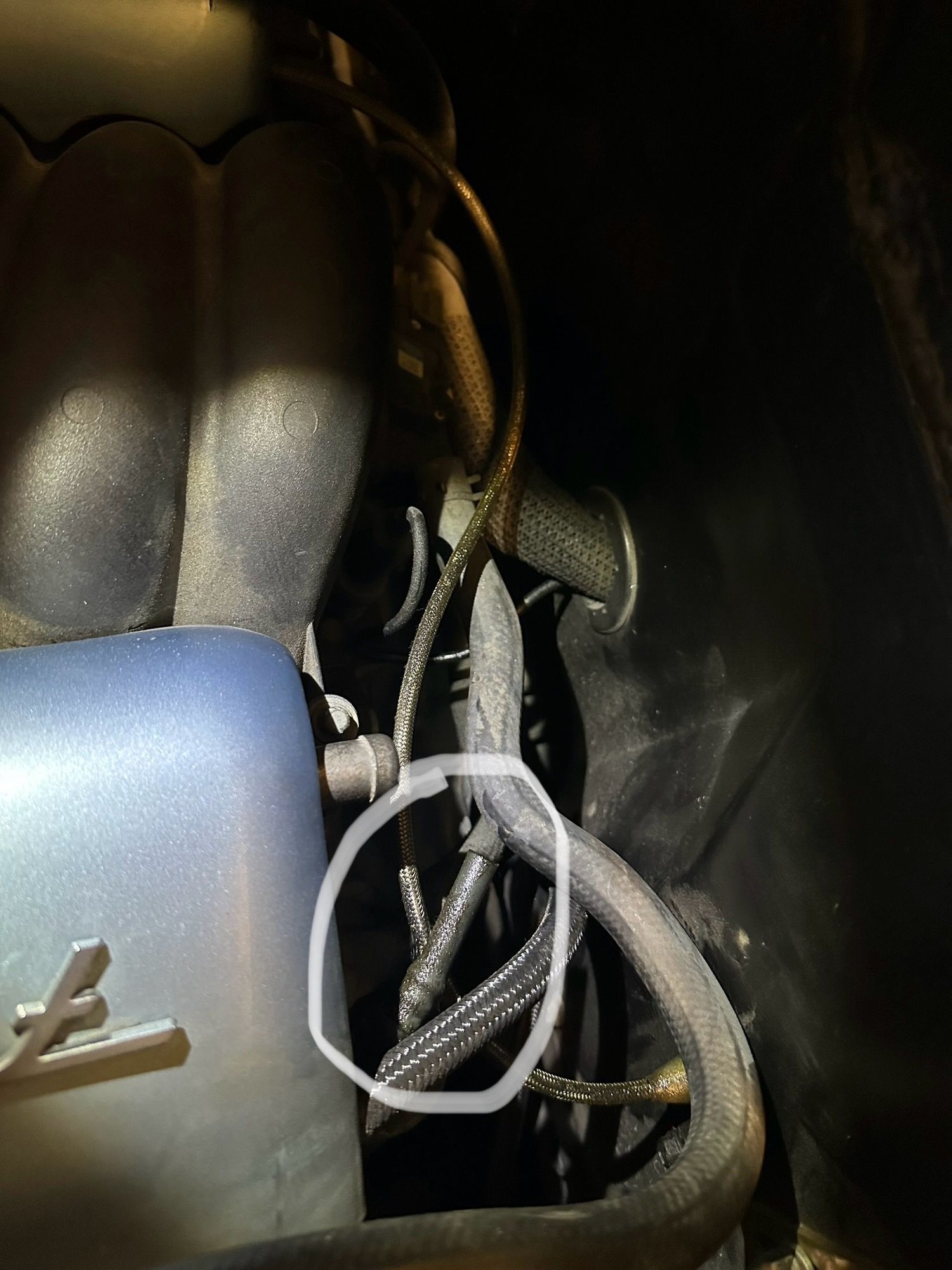

How’s it going guys, new member here. I just picked up a 64 Impala SS last week that has an LS swap. I was told its a 5.7 out of a 2002 Camaro SS.
I drove the car to work today to get to know her better, and realized I had some light smoke billowing in from the dash vents when stopped. Smelled like oil/fuel. Once I got home I popped the hood and saw there was smoke blowing out of this 3 inch-long open ended hose with the motor running.
If anyone could let me know what it is exactly and how I could remedy the issue I’d appreciate it! The motor runs perfectly, no rough idle or anything else besides the light smoke flowing out of the hose.

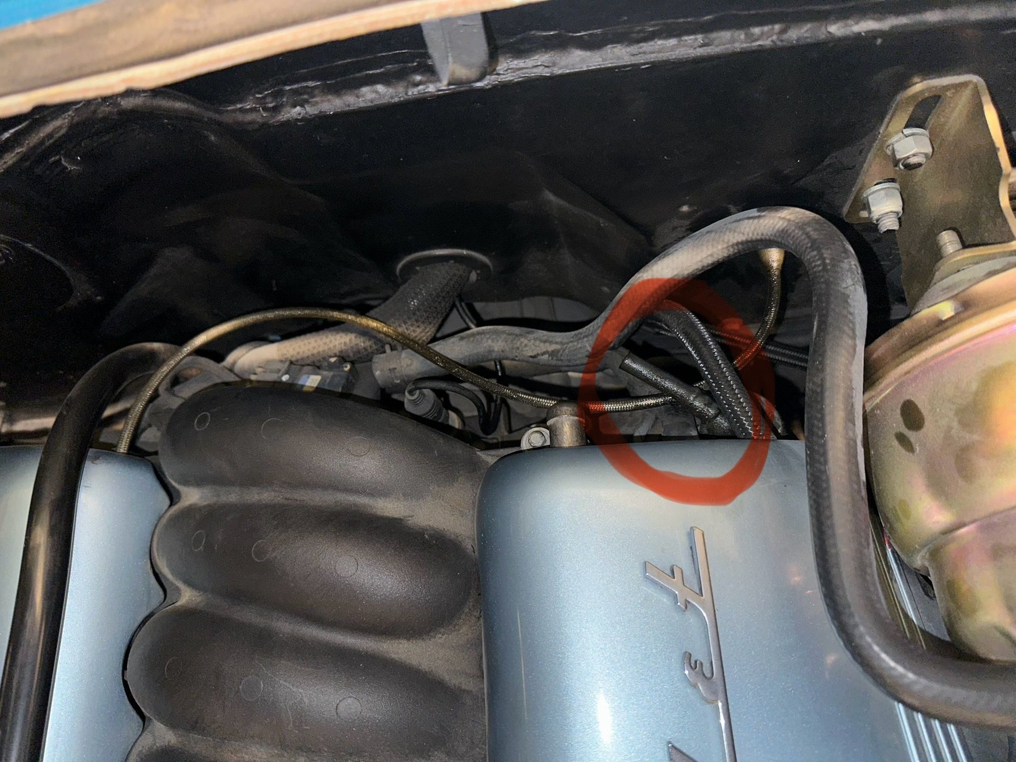

Thanks, here is a photo with the cover off.

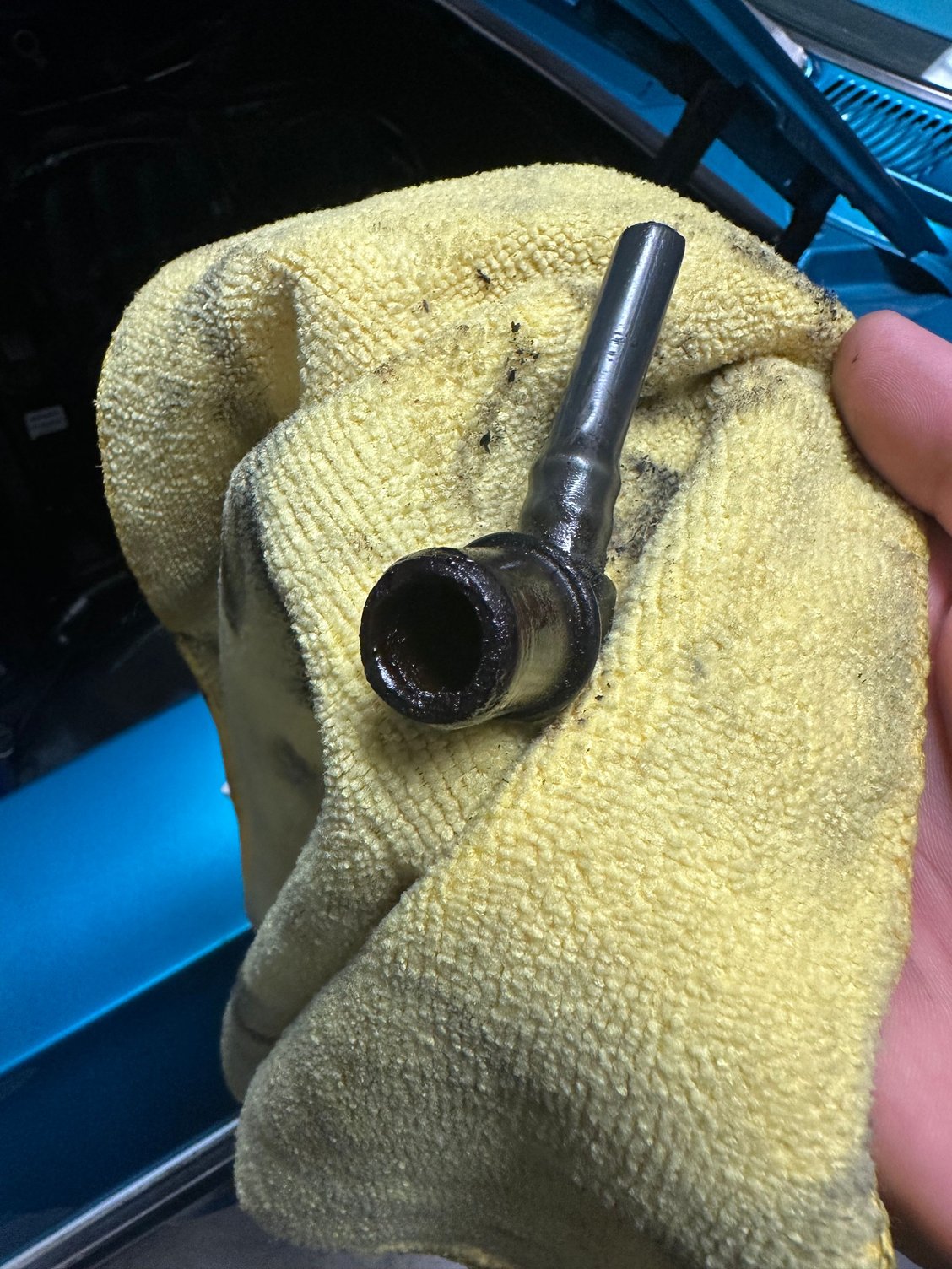

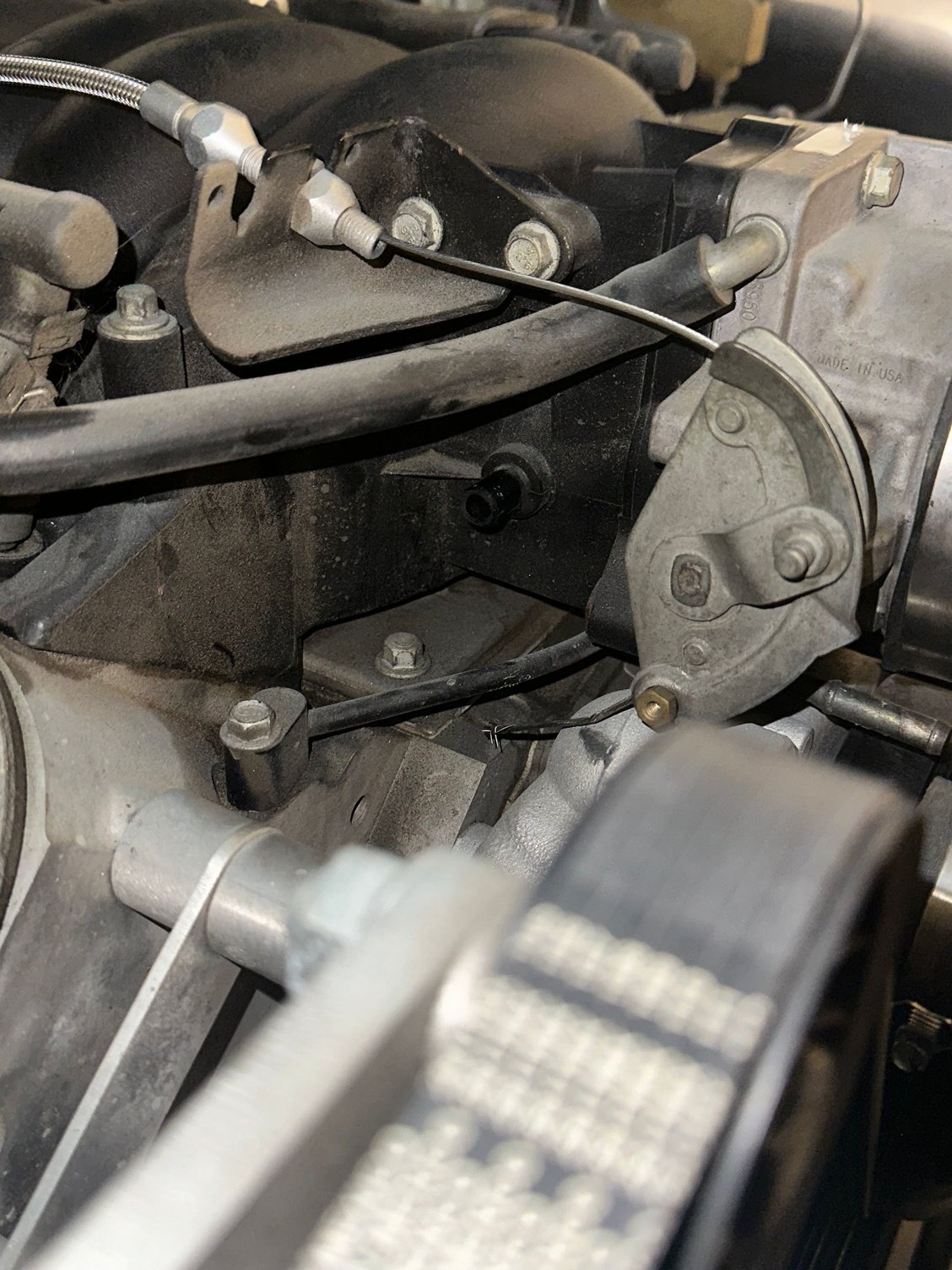

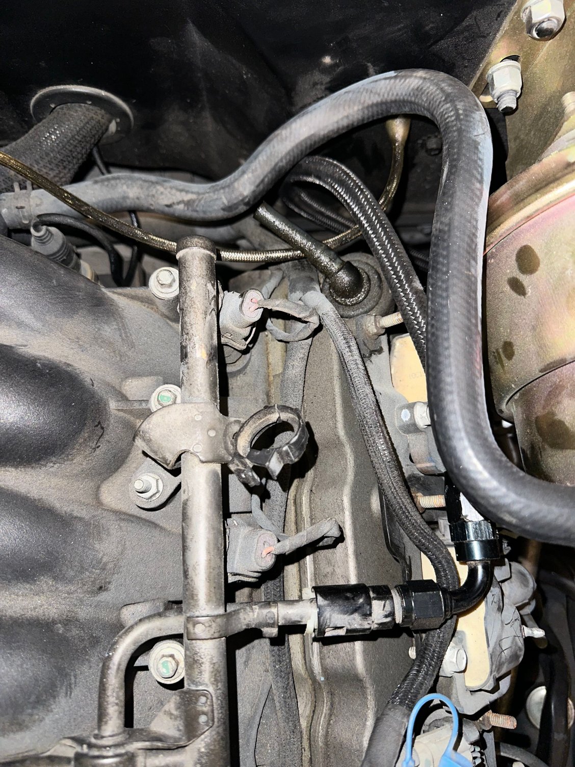

Thanks. It appears to be just a 90 degree fitting connected to a short plastic tube. So I would put a pcv valve in place of that fitting (or inline pcv), and run a hose from there to this port on the front/drivers side intake? It was capped. Also it’s a stock motor with headers and occasional driver, would I still need to add a catch can or can I get by with a direct hose?
Old Oct 12, 2023 | 10:44 AM
01CamaroSSTx's Avatar
Joined: Feb 2015
Posts: 6,020
Likes: 2,299
From: Conroe, Texas

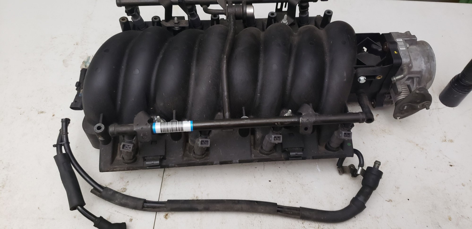

If it's just a stock engine then no real need for a catch can but certainly wouldn't hurt. I'd put that back onto the valve cover and run a hose off there towards the intake manifold with an in-line pcv valve just before the intake manifold. I've attached an image of what the 4th Gen Fbody lines look like. You'll notice the in-line pcv valve at the end of the line before going into the intake manifold.

Before you go and buy/build stuff to fix your issue, have you looked around the rear of the engine (including under) to see if there a hose/connector where that open ended hose might connect? Maybe the whole set-up is here and that hose just came loose, or broke off. If you are lucky, the hose for that 90° fittings is just hanging somewhere...
