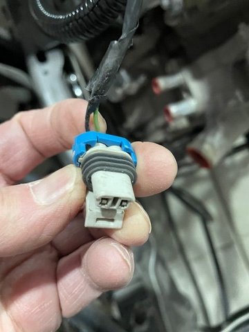

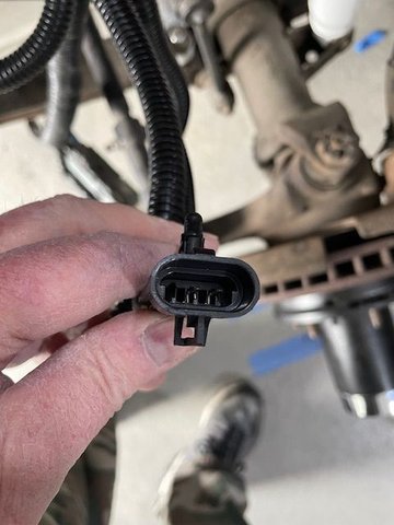

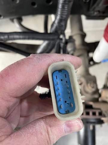

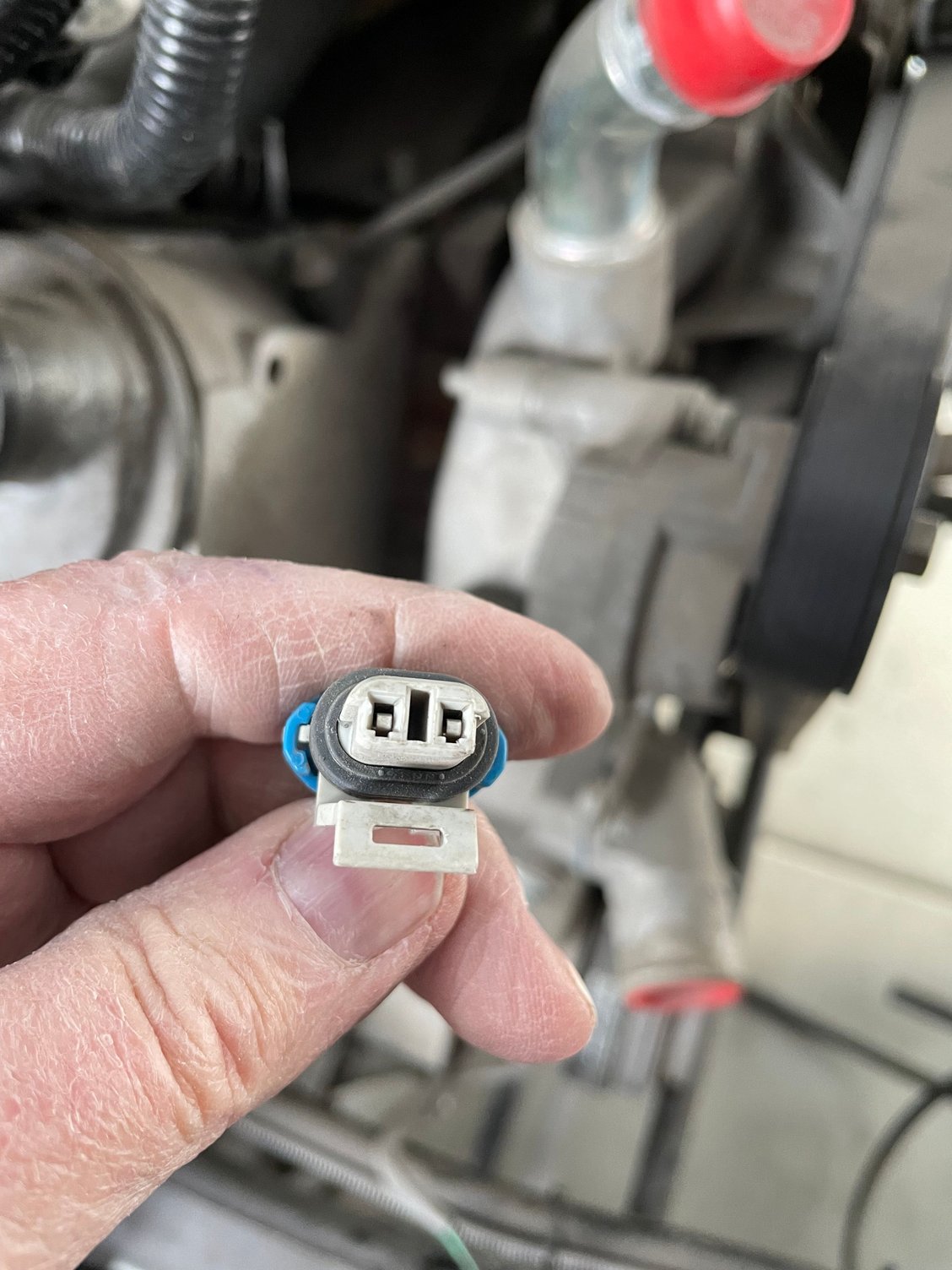

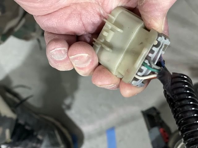

I found some extra connectors. One looks like a knock sensor connector. First pic is my knock sensors plugged into a connector which is also shown in the second pic, from my harness. Third pic is an extra connector on the other side of the engine. Just leave this hanging there?

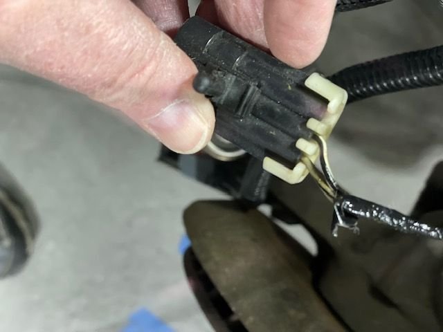

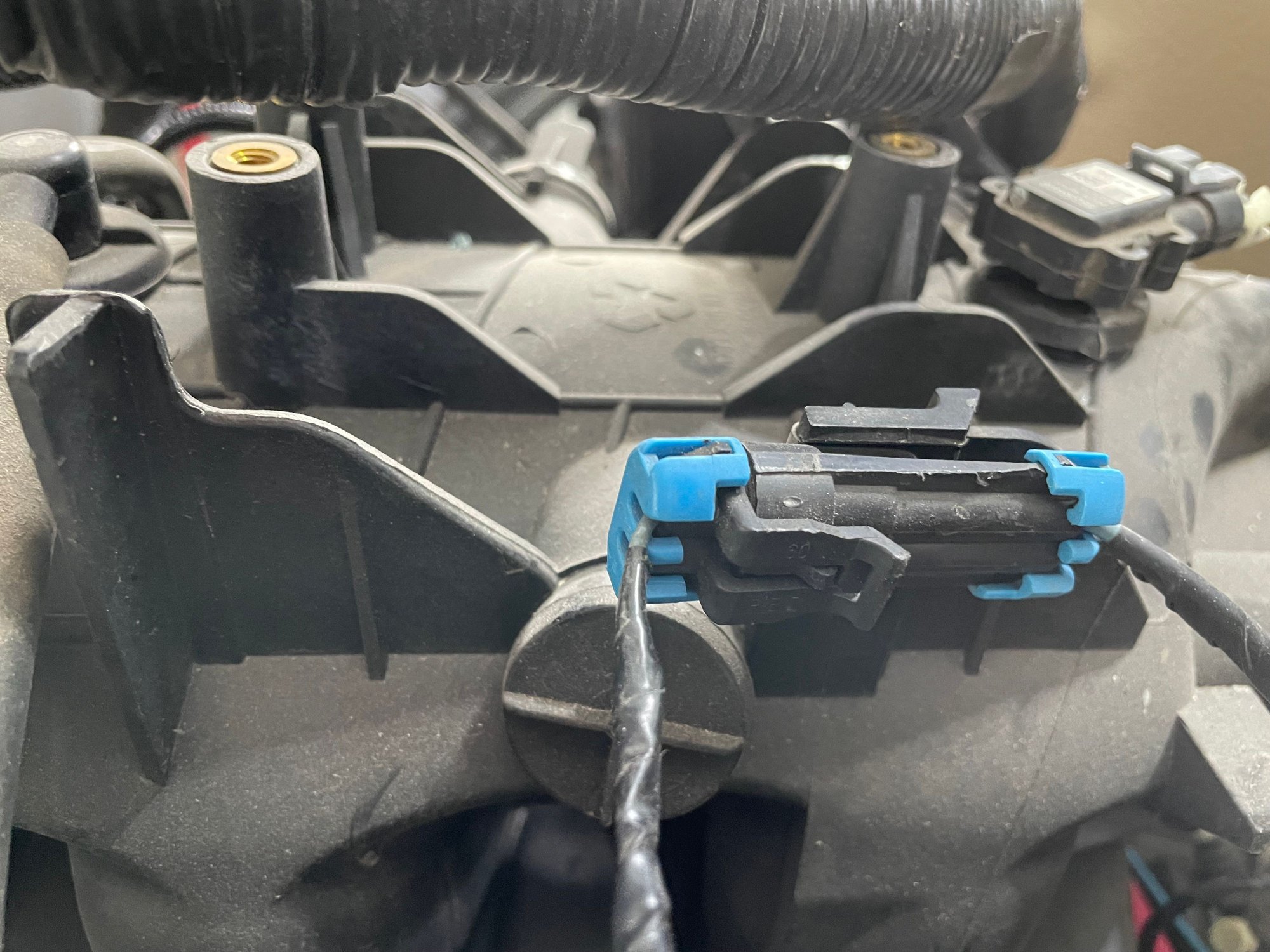

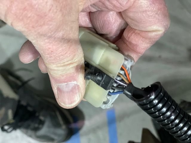

Here’s three others I can’t find pics of anywhere yet. Again, Gen 3 stand-alone harness for an 2004 Tahoe. Anyone have any idea what these might be?

There's some good info here: https://www.ictbillet.com/swap-guide...e.html#cat-576

Thank you! Yes - good info. I have those connector pic sheets printed out and still can’t figure these out. Anyone have any idea what these connectors are?
any reason I would have two knock sensor connectors and does it matter?
thanks!

Wire colors going to the connectors would help.
Old Jan 7, 2024 | 10:16 PM
Scott5006's Avatar
Joined: Jan 2017
Posts: 8
Default Extra connectors
Green and black wires
Old Jan 7, 2024 | 10:18 PM
Scott5006's Avatar
Joined: Jan 2017
Posts: 8
Default Extra Connectors
These looks like black and white striped wires
Dirty wires and sticky tape make the color hard to see.
Old Jan 7, 2024 | 10:27 PM
Scott5006's Avatar
Joined: Jan 2017
Posts: 8
Blue, black, white & black striped, brown, orange, white, green, gray

The big 12 pin white connector might be C152.
You can go the the GM upfitter site to find factory diagrams. They are helpful for this kind of thing.
Old Jan 11, 2024 | 12:03 PM
clay68c10's Avatar
Joined: May 2019
Posts: 46
Likes: 12
The upfitter site has changed since I used it in the past couple years and I’m not sure where to find the connector index.
Here’s C100, 152 and 153
https://www.lt1swap.com/vortecharnessconnectors.htm
