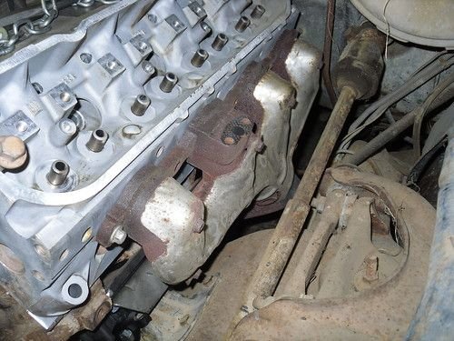

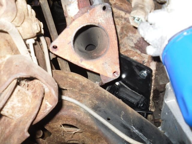

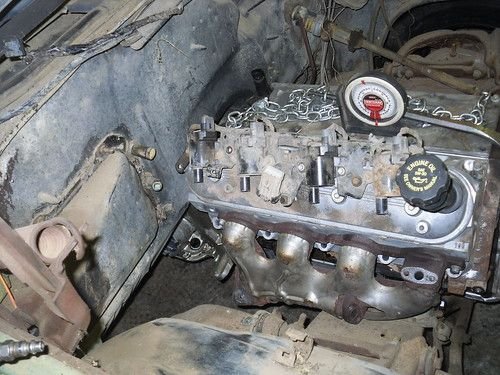

Originally Posted by 67California
Are you talking about these?
Won't the big triangular flange interfer with the frame?
F-body manifold drivers side 72 A-body wagon
in my sig...
Passenger side...
