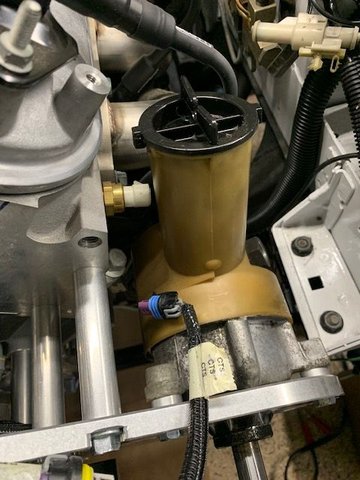

pdsq, I have my ECT sensor located in the rear of the passenger side head. You're saying that the actual coolant temperature will be higher at the front of the driver's side head because the coolant will have picked up additional heat from the heads, right?
This is why I couldn't run the ECT sensor in the front of the driver's side head, (LS376/480, Tremec T56 Magnum swapped, 1991 Foxbody coupe):
I'm running a Fox power steering pump with ICT Billet front end accessory brackets.  You can see the pump was right up against the ECT sensor.
Im running a Fox power steering pump with ICT Billet front end accessory brackets.  You can see the pump was right up against the ECT sensor.
I would bet your actual outlet temp that the thermostat is seeing is 10-20* warmer than your gauge is showing. What’s your gauge usually sit at? 190*?
