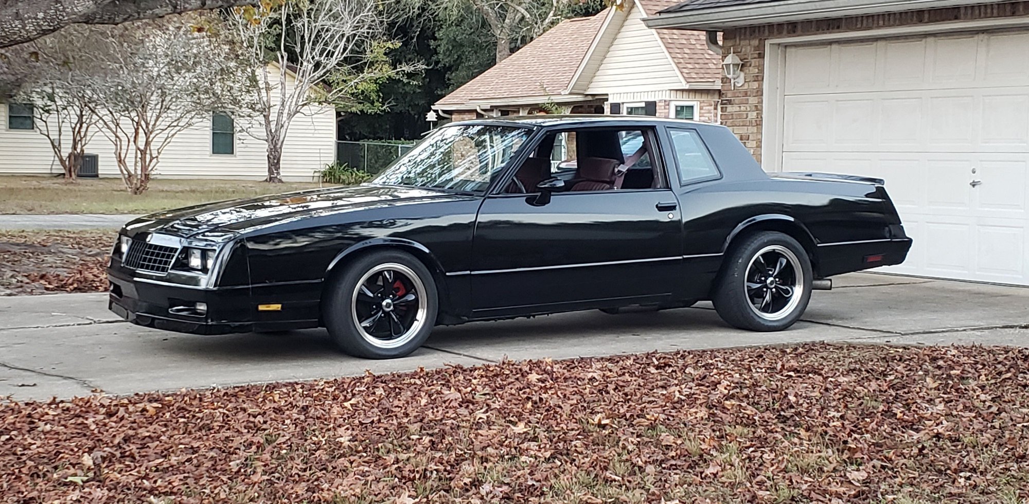

The setup I built for my MCSS is a 2006 6.0l LQ4, 243 Heads from a 2006 GTO, LS6 Intake, Thunder Racing 230/236 Cam. Under Drive Pulley, 1 7/8" Long Tube Headers, 3" Dual Exhaust.
Car is 3500lbs full tank of gas without me in it. T56 6spd Manual car, 1/8 mile 7.9x, 87mph, 1.93 60ft on street tires. Never put it on a Dyno but it makes power.

MCSS = Monte Carlo SS. One of these..

The look of your MCSS never gets old. It is, to me, a classic look!
