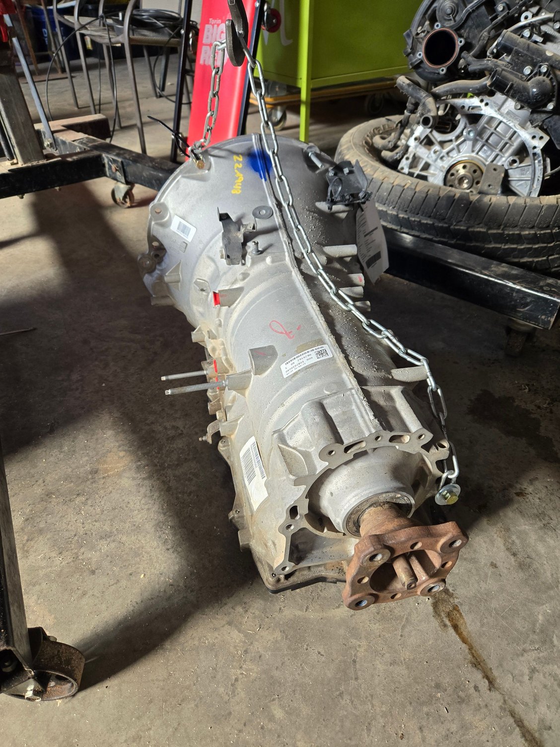

If you are looking for an auto that's fun check out the ZF 8HP70 or maybe the 90 for your power goals. I have a 6 speed car currently and love rowing the gears but I want to do something new, un-sprung twin disk was also not fun in the city. . . I'm swapping over to a 8HP70 and an iron 5.3. The controller i plan to use gives you different modes and one is for lack of a better description a clutchless manual (100% locked converter) shifted via paddles or dct style shifter. If you go with a Turbolamic controller you can have a clutch with you auto. . . Just figured I would toss that out there.
What PCM would you have to run for it? One for an auto car or one for a Manual car and do you think a P59 would work in it?
Also would it fit in the transmission tunnel of an F-Body without modification?
What are you doing for a Manual mode shifter?

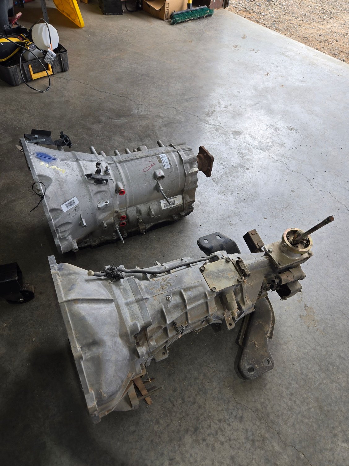

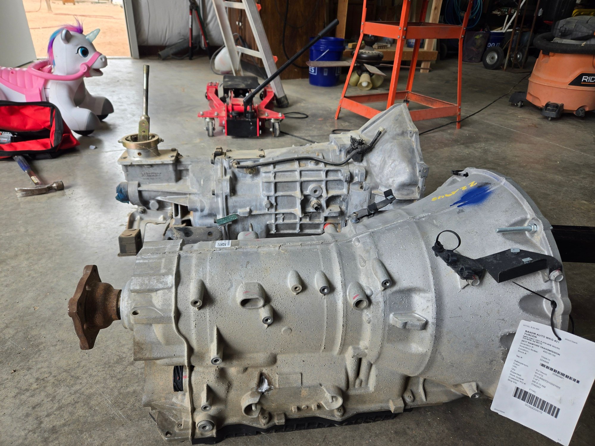

I plan to run a 411 PCM, I'm not sure if you run a manual or auto OS. The trans controller will send torque reductions requests to the PCM from what I understand. They have the ability to do throttle blip for rev matching but I'm not sure if that will work with a stock PCM. Sorry I'm not too familiar with the LS stuff. I'm currently a OBD1 LT1 T56 car, and I just started going down this rabbit hole. But its been done and is possible.
If you want a clutch Turbolamik is the only controller I know of that offers that.
I plan to use a MaxxECU mini because of the price.
For a manual mode shifter I will probably go with a DCT style shifter, you can use factory Dodge or BMW shifters but I don't like the look. Plan is to make my stock style shifter and make it a DCT.
Size wise the 8HP looks very compact! Here is a picture of it next to my T56. Haven't been able to get it under the car yet. I'm a ways off from that, but I can take better pics and measurements. The 8HP has a bit of a belly, but the the output shaft to top of the case actually looks less. I have seen some posts about it being about the same size as a 4L60.
