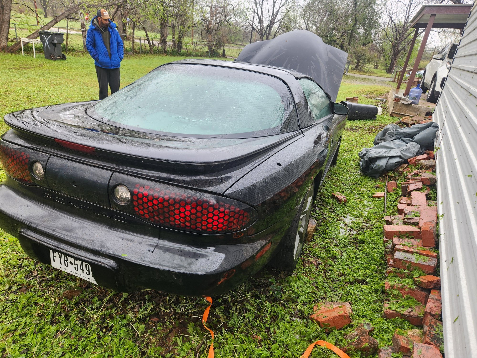

I'm finishing up my 99 Z28 LS3 Magnacharger Build and every bit of me wondered what it would have been like to turbo it instead. I knew Turbos were more effective but I really wanted that Supercharger wine. I haven't even cranked the Maggie Built Z28 and the bug has been itching me to buy another 4th Gen F-Body and build an appropriate LS and TT ... So I purchased me a car to restore (my 99 Z28 has also been heavily restored) ... a beat up used V6 that has seen better days waiting for alittle bit of magic. (PICS at bottom of post.)
I know most of ya'll wouldnt do a V6 to LS swap but there are a few reasons I'm doing this.
- I had the opportunity to attempt this back when I was in college but due to finances the project flopped and I had to sell the car. It also happened to be a Firebird
- Just about everything on my 99 Z28 drivetrain wise is non-factory.
- I want a project car to restore and build from the ground up (again)
- Money wasn't an object
I have the title and keys. I am going to tow it (it doesn't run) on Monday. Im not sure if I should start with the body and interior or if I should start with the LS Swap and TT. Thoughts?
Additionally, what motor choice would you go with?

If you start with the body, you will scrape it up working on the mechanicals. It might not be a bad idea to gut the interior first, but I would not put anything back together until the powertrain is sorted. Between vac/boost hoses and various wiring the build will be easier with the interior mostly bare.

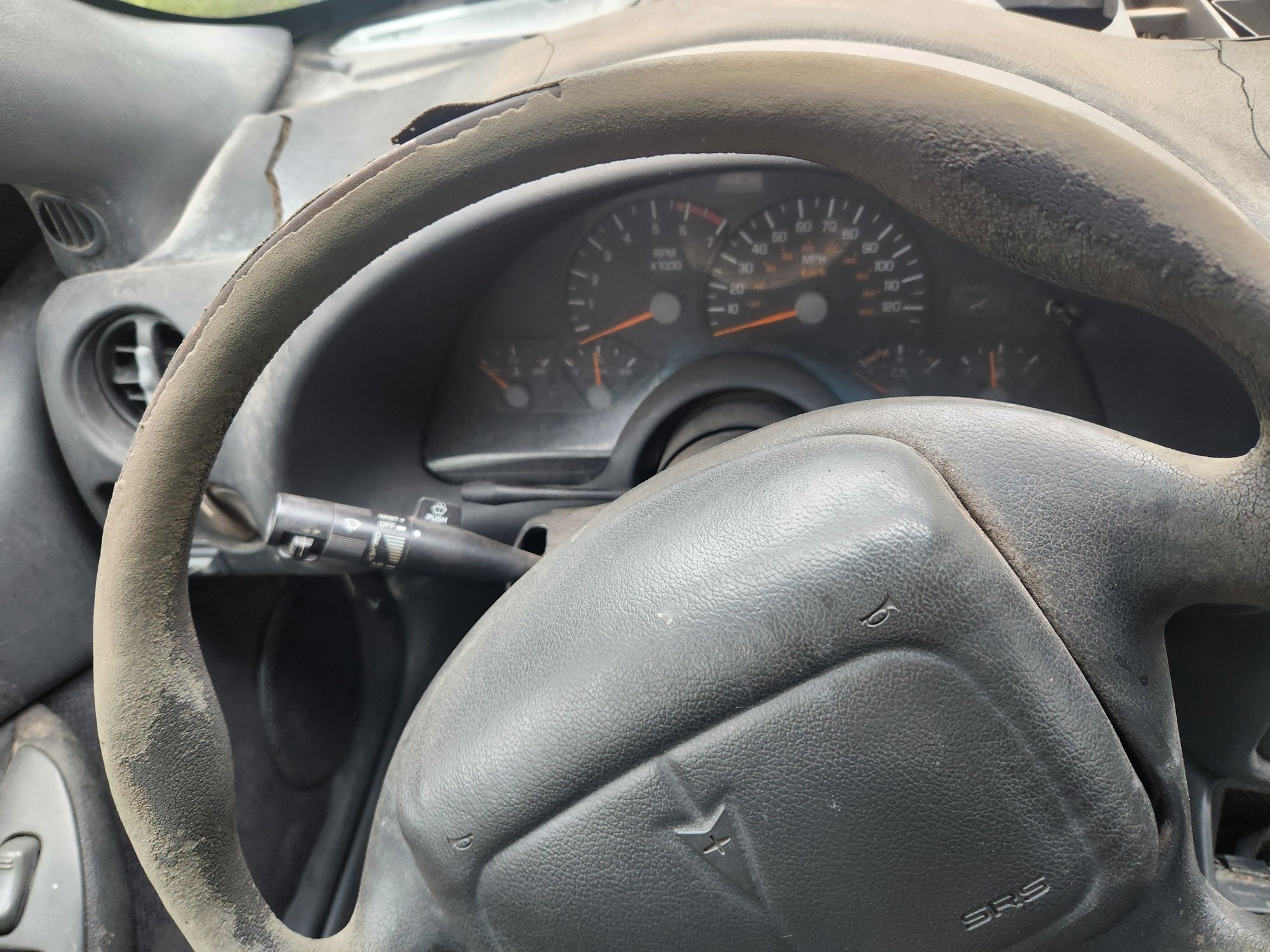

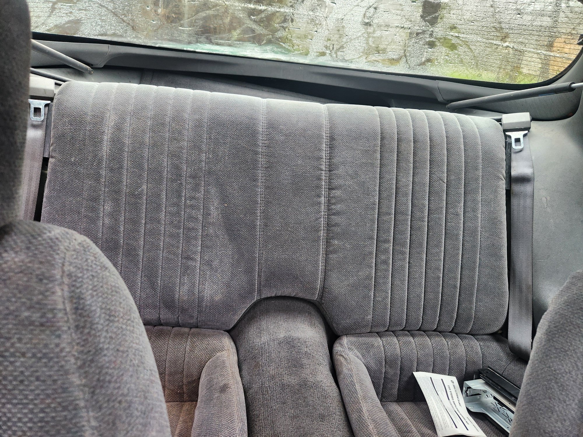

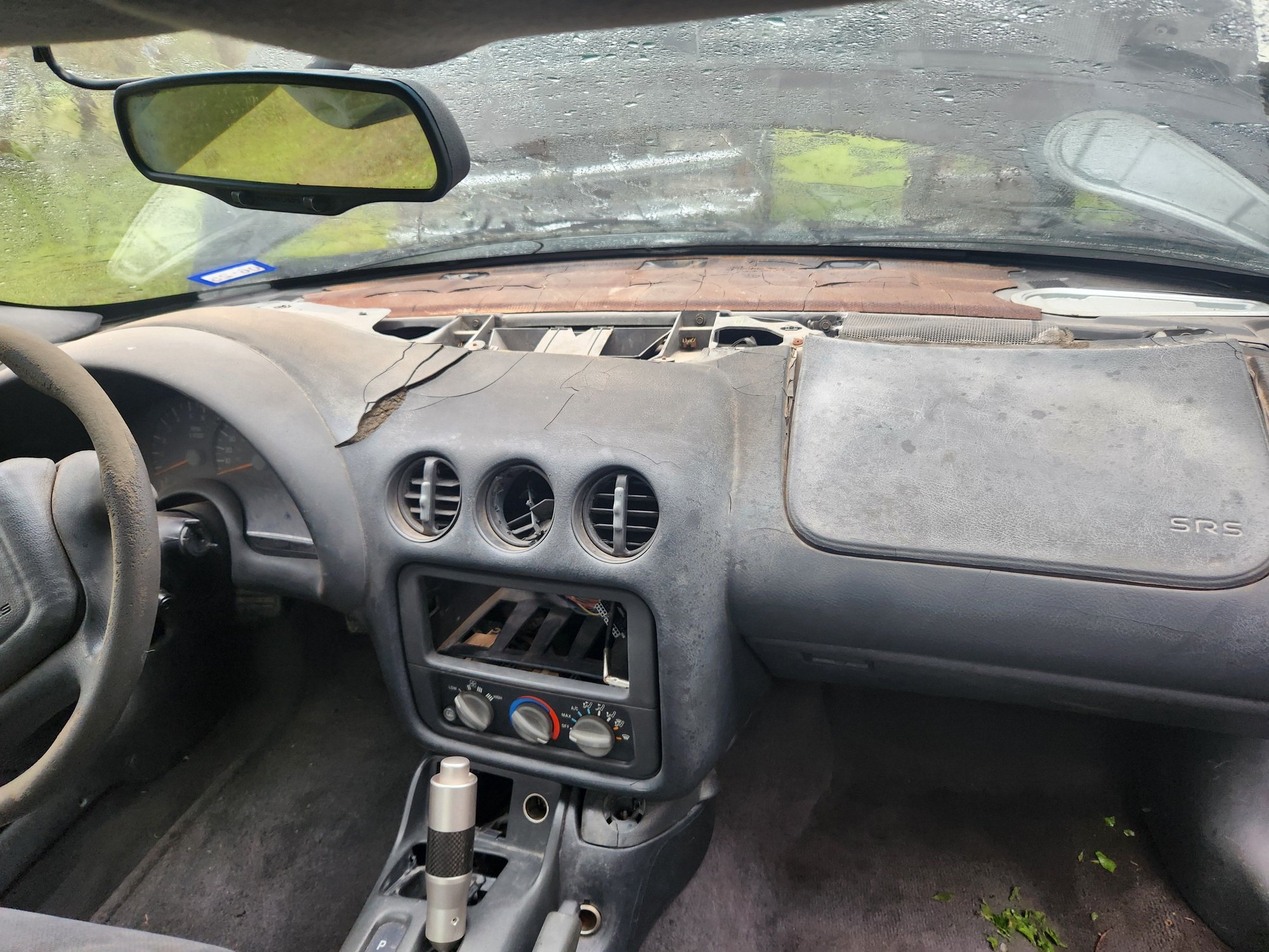

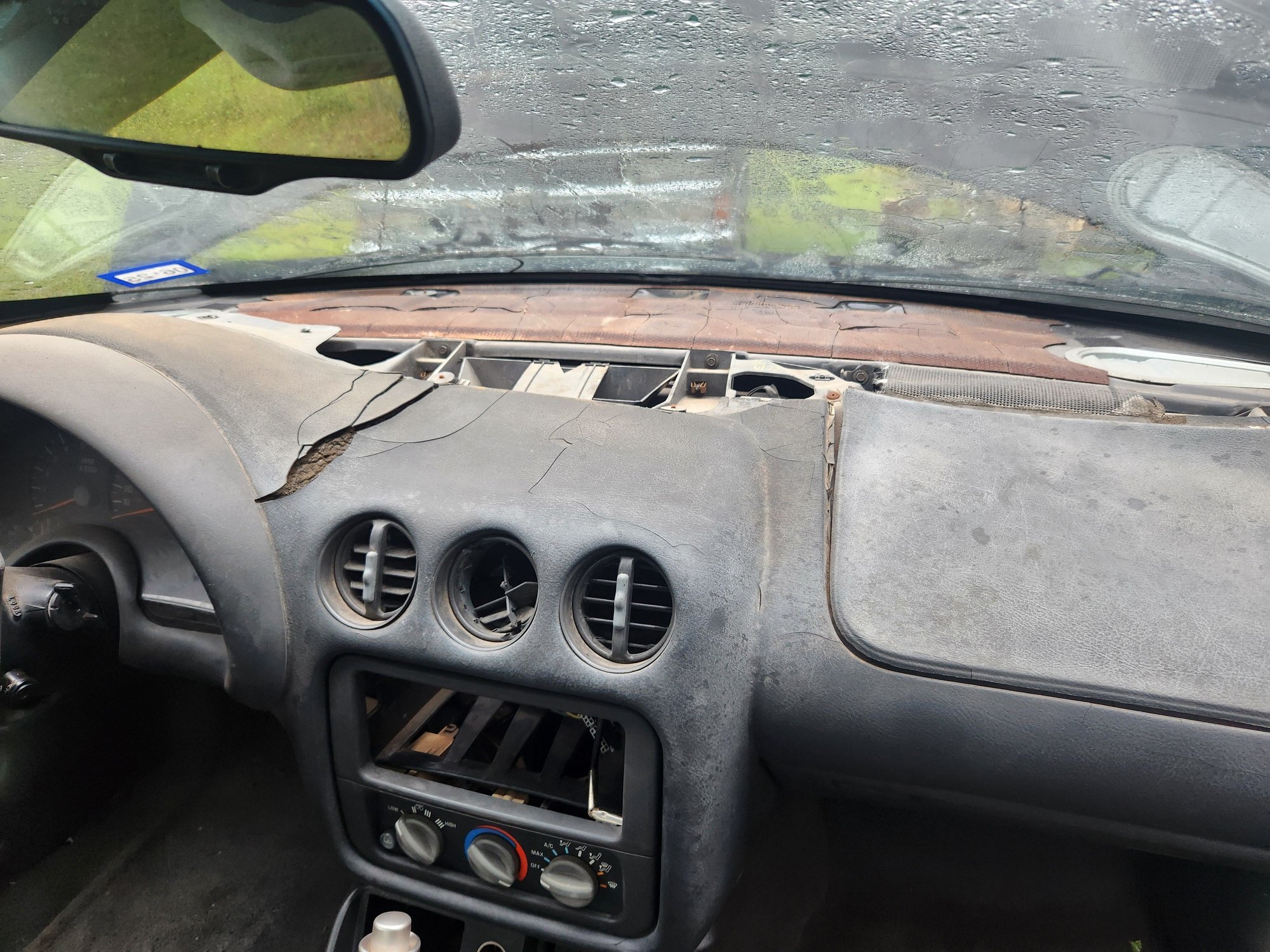

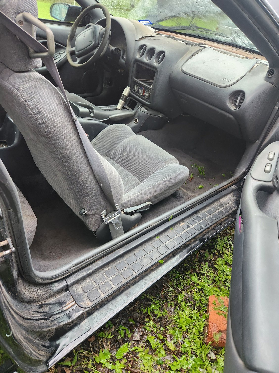

To me it looks like the interior need gutted anyway. yowza that thing is rough, is there any interior panel that isn't broken
As long as the chassis is solid, you can tear into that car to turn it into whatever you want without feeling bad. Anything is better than it is now!
