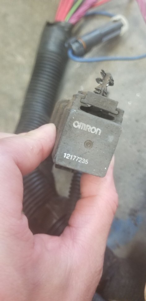

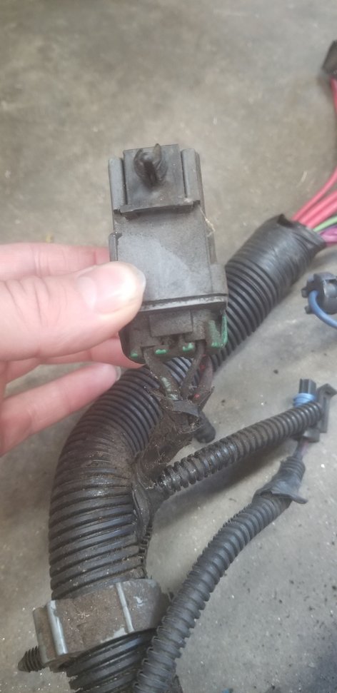

I jacked the car up. On jack stands, no fuel pump. I moved the wires around the relay / harness and the fuel pump began to work. I couldn't get it to fail again (wife in car cycling key on and off). I pulled the relay and noticed the hot wire looks like it had gotten pretty hot. I have 10 gauge wire run all the way to the battery. It's run through a Waytech fusebox with a 25a fuse. The relay itself is a 40amp. It seems Racetronix printing their own part number on it. I hoping I can find a regular part number that will fit into the same harness connector. Given the burn marks on the connector, I'm going to replace the relay. The wires themselves don't seem to have any problems that I can detect.

That relay socket ( connector ) is ROASTED.
You NEED to replace BOTH the Relay and the socket. You'll probably find the wires leading up TO the socket have been hot, and are shitty as well.

With 10 gauge wire all the way back and fused, what could have caused the socket to overheat like that?
Old Apr 30, 2025 | 08:18 PM
Bbknucks's Avatar
Joined: Dec 2022
Posts: 441
Likes: 157
Poor pin contact will do that

OK, thanks. I'll cut out the RaceT stuff and splice in new things. The problem I'm having is that RaceT puts their own part number on the relay so I can't go find the part somewhere else. I called Waytek and they weren't able to find it either. I'll start a separate thread for this question to increase visibility, but I'll also ask it here. Does anyone have a manufacturer part number for the Relay and connector below:
Relay Connector Kit (SPDT) MP280S-ISOThis relay is used in most current-production Racetronix harnesses.) FEATURES:
  • Plastic dust cover, shrouded, steel mounting bracket, epoxy sealed
  • Supression resistor = safe for use with solid-state drivers
  • P.B.T. Polyester enclosure
  • ISO/TS 16949, ISO9001, ISO 14000
  • Tested in accordance with SAE J2544
COIL DATA:
  • Configuartion: S.P.S.T. 4-Terminal (1 Form A)
  • Voltage DC: 12
  • Resistance Ohms: 109 (+/- 10%)
  • Suppression Resistor: 680 Ohms, 1/2 Watt
  • Combined Resistance Ohms: 93.9
CONTACT DATA:
  • Material: Silver tin oxide
  • Max. switched power: 560 W (SPST), 560 W (N.O.), 420 W (N.C.)
  • Max. switched current: 40 A (SPST), 40 A (N.O.), 30 A (N.C.)
Ambient Temperature (Operating): -55°C (-67°F) to 125°C (257°F)
Terminals:Tinned copper alloy
Life Expectancy (Minimum operations):
  • Mechanical 1 x 107
  • Electrical 1 x 105 at 40 A 14 VDC Res.

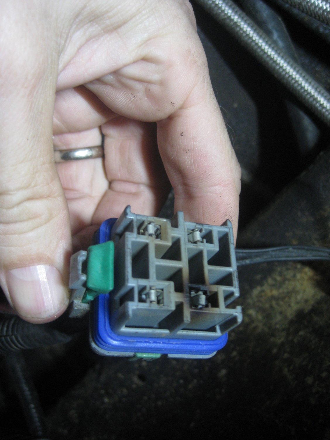

looks an awful lot like this inline relay setup that seems to be in every gmt800 vehicle that i've parted out:
happy to send you one for the cost of shipping if it helps, i've got a bunch kicking around.

Yea those are delphi metri-pack 280 5 way connectors
