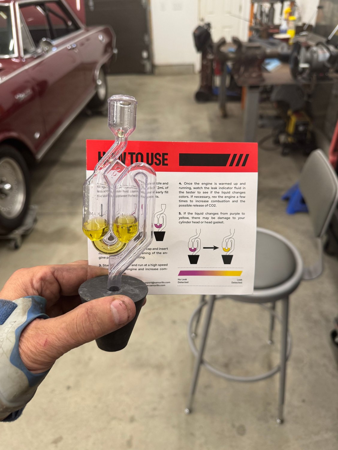

Less than 1000 miles since I got it out of the machine shop… it’s been going on a long time, like 400-500 miles. I’ve been chasing it as a leak. Also been checking the oil frequently (because it’s a new build) nothing extra on the stick.
This however tells a different story… She’s coming apart, again.. Note the car in the pic has a different issue and already has the heads off and in the shop.

MLS headgaskets simply don’t fail that easy. I’d look at a head being cracked or even a sleeve issue. A lot of times you can see a crack in a sleeve better from the water jacket side (behind the sleeve) than if you’re looking directly at the cylinders. Use a good LED penlight and carefully examine all the water jackets down around the cylinders. The aluminum shows bulges or cracks pretty well. Maybe this thing was previously hurt and you weren’t told about it…I hope I’m wrong about it all for your sake.

Long story short, head gasket failure. #4 hole was very clean when I got her apart. Thought the head might be an issue so I had both of them tested by the shop that did the work on them to start with.... about 1000 miles ago.
NOPE, not the head... wasn't sure how I felt about that BUT when I brought the heads to the shop I brought the gaskets and despite the fact he might as well be blind the guy was convinced there was a head gasket issue. So I threw the heads back on a BLOCK that went thru the shop 1000 miles ago with half of me (the old half) thinking this is a stupid idea and the other half (you know what half this is) telling my to send it...
Truck fired right up and went striaght to 220 on a 180 t-stat... WTAF is going on?? I had her on a hill and burped her like I do... TRY IT AGAIN.... Are you shitting me, right to 220 again. Oddly enough the cooling system does not test for combustion gas nor is the oil level rising... BUT THIS HAS TO BE THE BLOCK RIGHT... CRAP!!! So I go to bed, don't sleep great, decide to do everything except deal with the truck all day.
Okay it's the next day late afternoon and I'm finally convinced I'm buying a long block from TSP with expidited build/shipping.added in and yeah I was still was ready to pull the trigger and buy my way out of this frigging disaster... so at this point I figure I have nothing to lose and try burping/testing her one more time. HEY.... She's holding at 185 with no combustion gas detected, take her for a short drive, 192 max.. let her idle for 10 minutes, 185... HOLY CRAP
WHAT CHANGED, the hill I used to burp her on... I couldn't use my "go to hill" due to some workers were in the way so I used a hill in my field instead.That resulted in roughly 24 hours of anger, not great. So to the guy saying I should buy another "suitcase tool" (I have like 20 of them and was not keen on another) to vacume fill the coolant you are right, ordered it before I wrote this.
