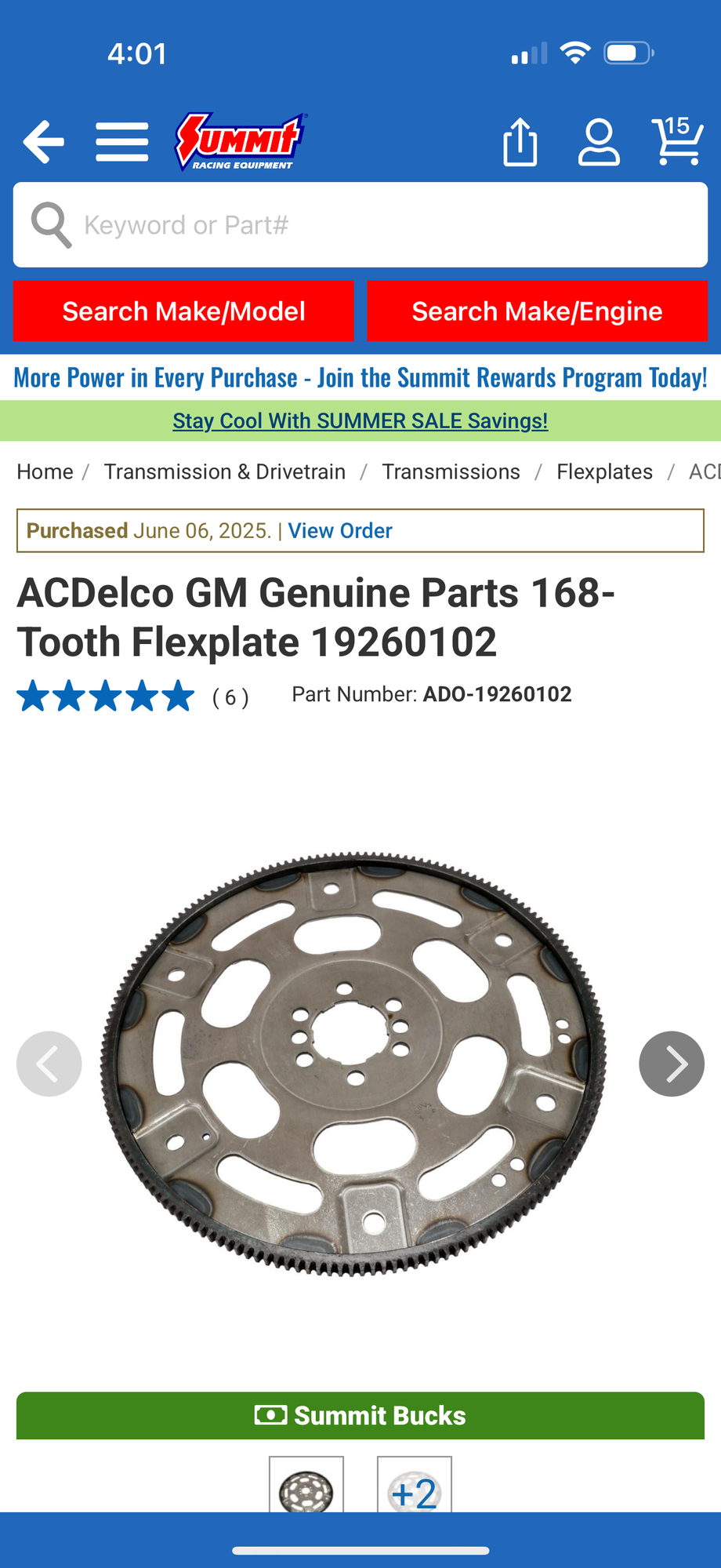

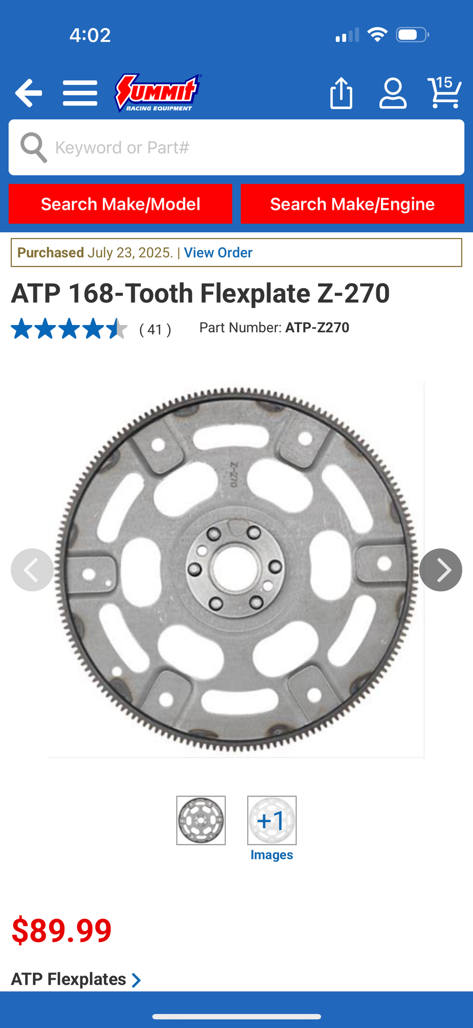

Originally I got the flat ac delco flexplate. Didn’t fit right. I ordered atp-z270 that has the spacer built in and it’s all good from the flexplate standpoint.

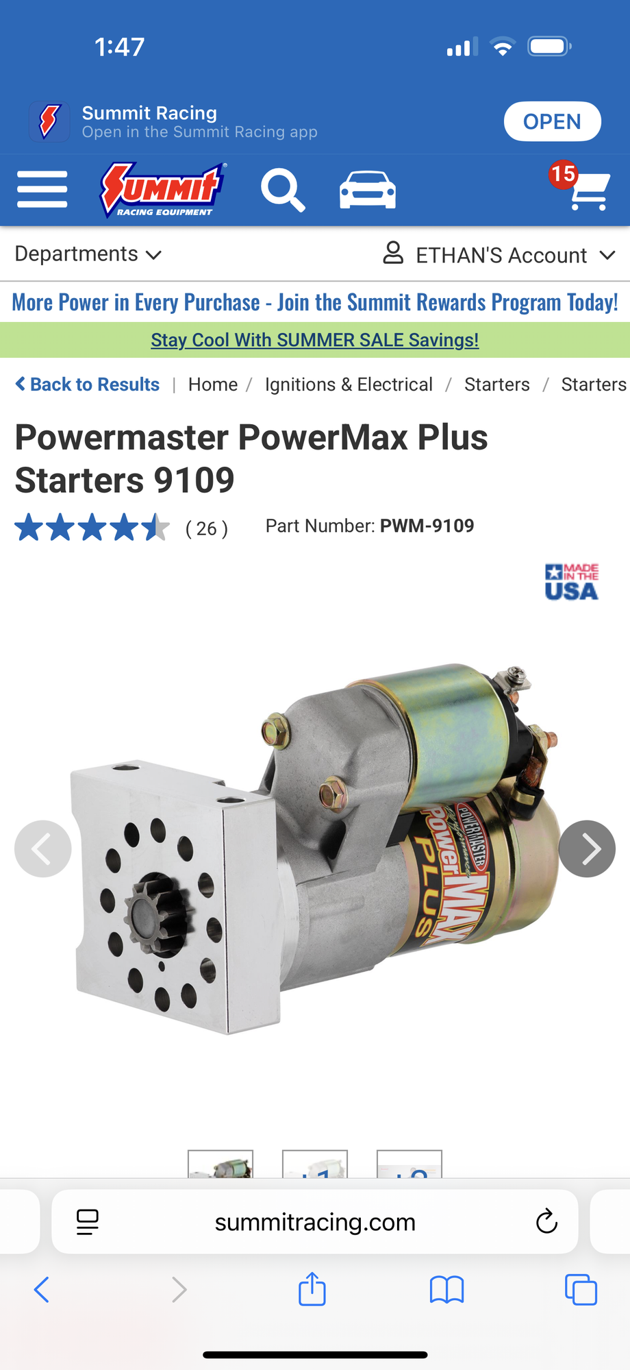

Now the issue is the starter doesn’t sit right with the flexplate. The starter needs about a 3/8” spacer. Summit advised on the flexplate and starter. The starter is a power master 9109.

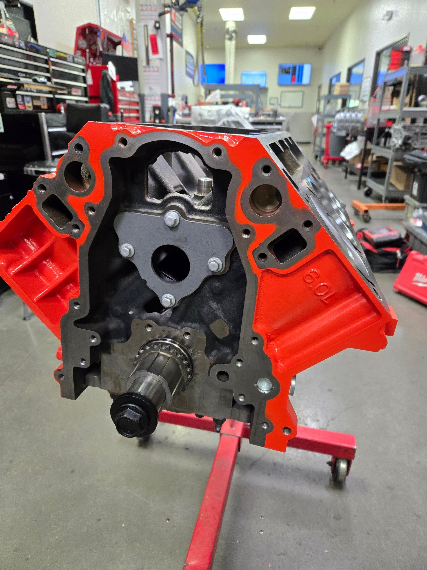

A pic at rear of the crank where the flywheel bolts (without flywheel) will show if it is a long or regular crank. In my experience, all gen 3 starters I've had were interchangeable.

unfortunately no pics of the crank. I only have front side pictures. I’m handling this remote from Seattle while a friend in Kansas does the swap.

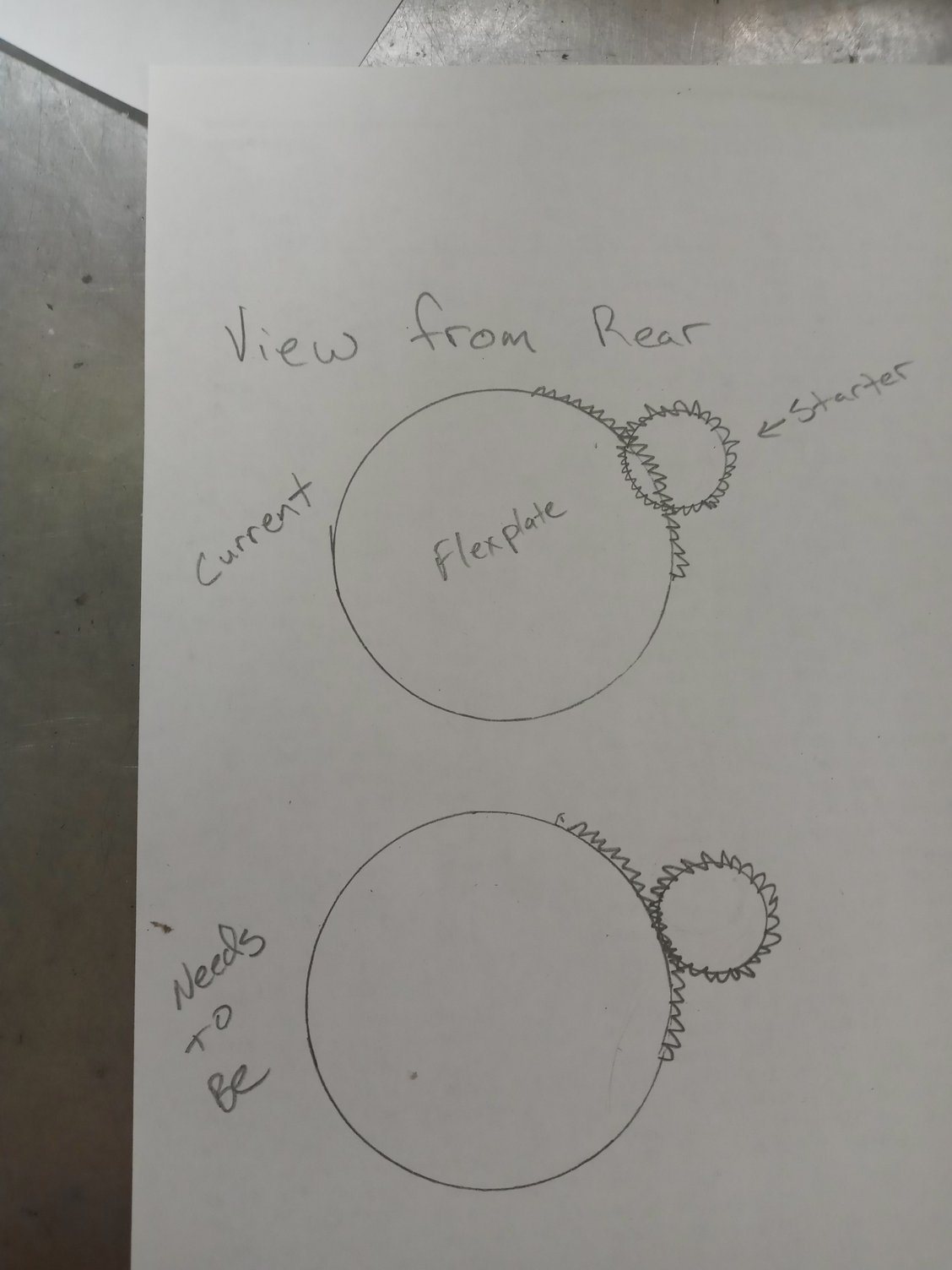

Verified proper flywheel again. 14” as it should be. Got this picture from my friend doing the swap.

I'd grab the cheapest parts store Silverado starter and have him try it on there. That will tell you if the problem is in the starter or on the engine side. Return when done.

did that today. Not the starter. Can someone link me the right flexplate since I’m getting it doing?

Mark a tooth on the ring gear and count them to verify it is 168. If it is more, then that would be the issue and could have been mis-packaged.
My initial thought is you got a 153 tooth starter, but the stock starter would indicate a ring gear diameter issue (unless it was boxed wrong). LS engines only came with 142 (LS4) and 168 (all others) tooth ring gears.

I think one of the issues is the starter and depending on what crankshaft you have it could be the problem. In the Gen III 6.0 block I built for the 99 car I used the crankshaft from my 01 car which has a standard length crank flange. I purchased a TCI 399754 flexplate with an OEM starter for 2003 Silverado 1500HD truck. That flexplate is designed to be used with TH400 converters and for 4L80E transmissions.
Most LS engines have a standard-length crankshaft flange. These engines use a dished flexplate with an adapter to connect with older-style transmissions (non-LS). For modern LS-style transmissions, a flat flexplate is used, with no spacer needed. The longer crank flange is found only on 1999–2000 6.0L LS engines. It is approximately 0.400–0.550 inches longer than the standard flange and when mating a long-crank 6.0L to an older (non-LS) transmission, you use a flat flexplate with no spacer. Using a standard (dished) flexplate on this engine will result in the starter not engaging properly, or other fitment issues.

Notice the difference in crank flange thickness.

I have the short crank hence needing the spacer.
