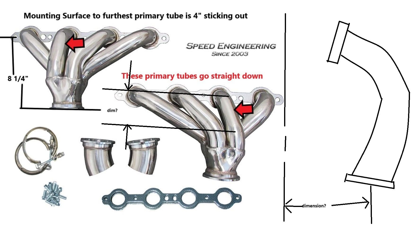

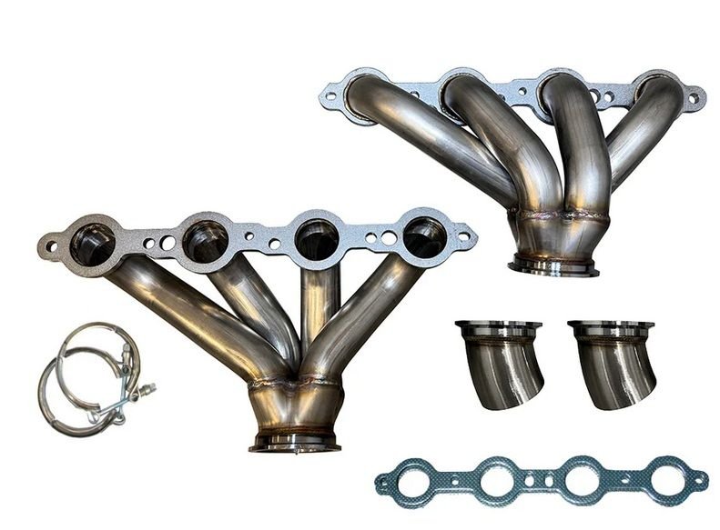

looking at these shorty headers as a starting point
https://speed-engineering.com/produc...s2-ls3-ls6-lsa
1-3/4" primaries, supposed to be block huggers
concern is most likely wont fit as is in the Fiat, the front A-arms are mounted really close to the block and I think that the upper A-arm tabs and the headers want to occupy the same location, and this is with the front suspension 4" forward from where it would normally be.
Anyone on here have a set? Mounted? that you can post some pics and maybe take some measurements. or anyone have a 3D scan of a set?

Without CAD of the actual header, or a few more dims, cant make a determination. however Speed Engineering gave me one dimension, just not the remainder I asked for.
if I ASSUME that the furthest point is 4" out from the flange and that is the collector, I may be able to lower the motor a bit and get the header to just come under the upper A-arm mount.
but that puts me into really shallow oil pan territory. I cant move the motor more than another 1/2" forward or aft because I run into the rack in the front and the firewall behind the motor.
Its close enough it may be worthwhile to buy a set and scan them. going to take the pics and approximate some dimensions to make a model over lunch sometime.

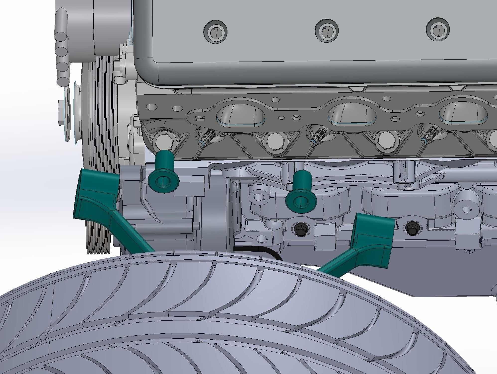

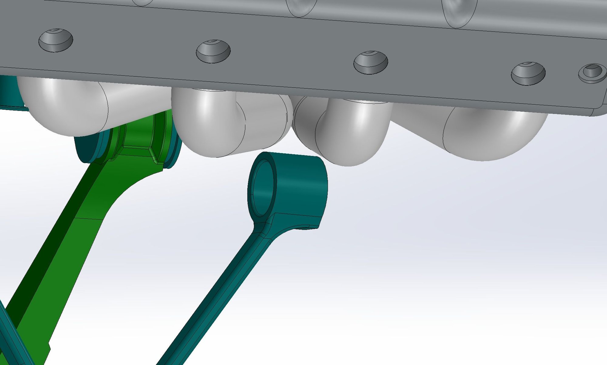

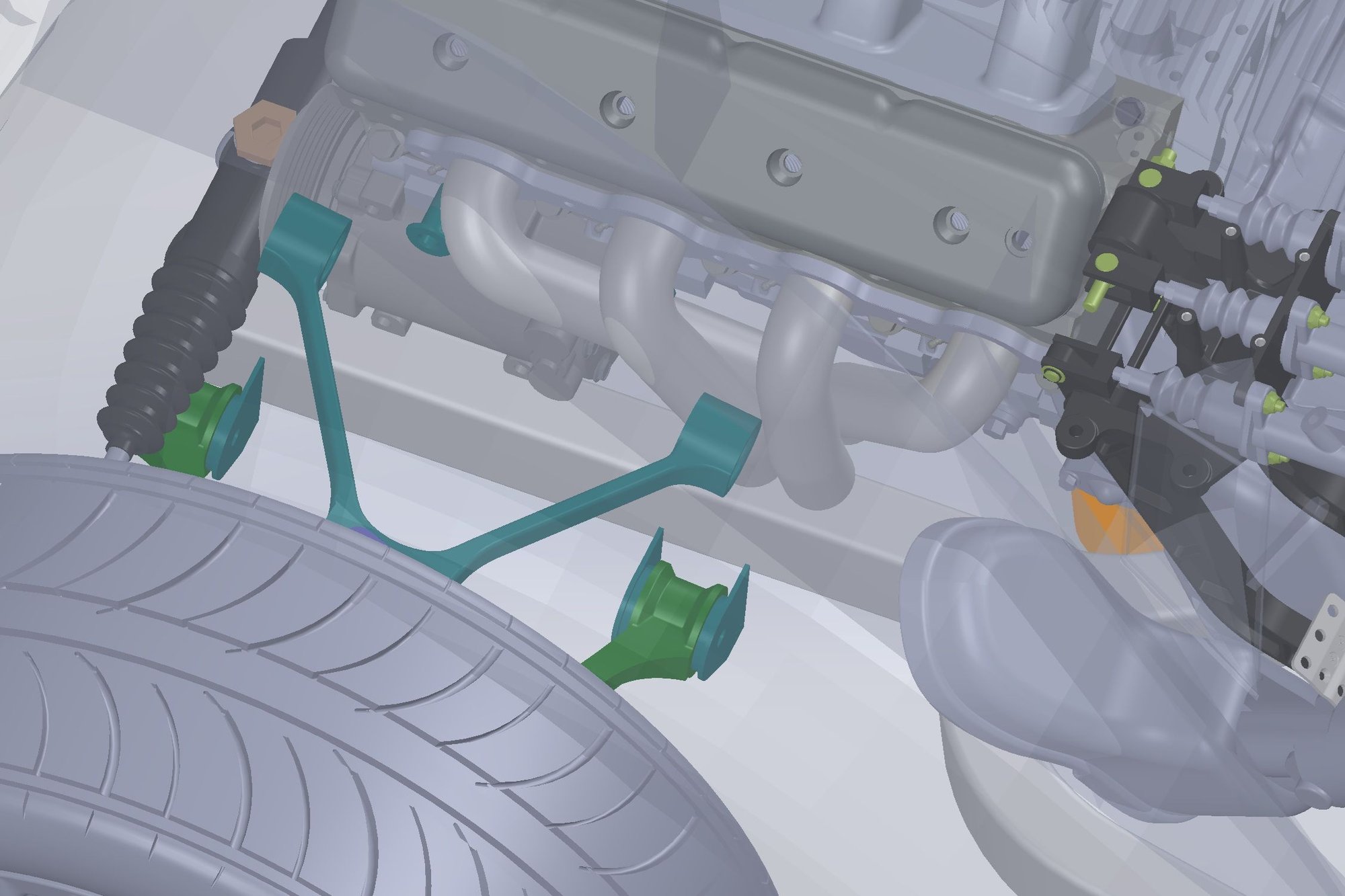

I took the pictures from Speed Engineering along with some of the conversations and approximating some of the dimensions on the images..... and made some assumptions. i then modeled the header on the left side. (right side coming soon)
with moving the motor aft 1/2" (requiring relocating some of the items inside the cabin, I can nearly clear everything with just about 3mm of clearance of the stock corvette upper a-arm. Really tight, however will allow me to get them and do a slight tweak to the flange to tube joint to get them to fit.
