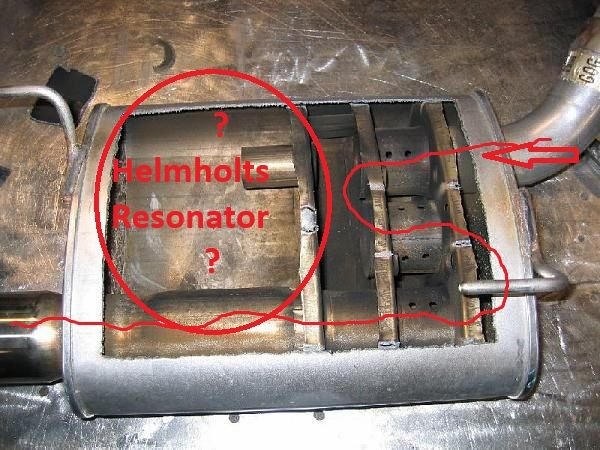

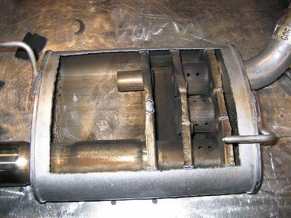

These mufflers are from a 2007 Mustang GT. 2.5" ins and outs. All Stainless Steel. I welded on straight nipples and mounted them under the back seat with tail pipes to the rear bumper. They sound great, no drone, great cruise sound, and great bark when you jump on the throttle. They're on my LS powered street rod with no cats, shorty headers, and an H pipe. Love them. Great choice for your wagon. I've found over the years, the aftermarket performance mufflers are way too loud, drone, and rattle your brains out.
This looks interesting.
What dimensions does it have?
Is it four chambers?
I try to understand the flow.
/Christian

Mufflers housings are 14" long and you got the flow and built in resonator right. I would use them again in a heart beat. A friend of mine took them off his car with less than 10,000 miles. He put on a cat back system with ridiculous abbreviated mufflers. I rode in the car and it made the car absolutely miserable. The Drone was the worst I ever experienced. It felt like somebody was beating on your chest with a baseball bat. He wanted the original mufflers back. Too late, there're on my car. I will give Ford a lot of credit for this muffler design. The built in Helmholts Resonator Chamber makes it work. Sound great and perform. I found the cut away picture on the Internet. Click on Below and scroll down to the Walker Daily Driver Stainless Steel Units for the available replacements:
