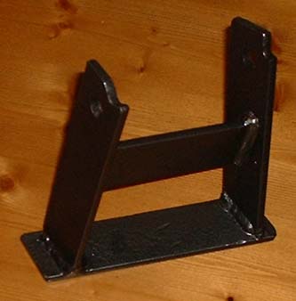

My Dad threw these mock motor mounts together, and then copied them.
Here's more pics. . .
http://www.chitownsyty.com/bg/pics/1/tn/DCP_0485.JPG
http://www.chitownsyty.com/bg/pics/1/tn/DCP_0486.JPG
http://www.chitownsyty.com/bg/pics/1/tn/DCP_0513.JPG
http://www.chitownsyty.com/bg/pics/1/tn/DCP_0529.JPG
http://www.chitownsyty.com/bg/pics/1/tn/DCP_0519.JPG

mgreen what kind of car is that? Looks like you took a f-body mount and then made an attachment to the frame. I ordered the f-body mounts yesterday and will probably do something similar. Mine is a 66 nova with a tube front end (alston).
