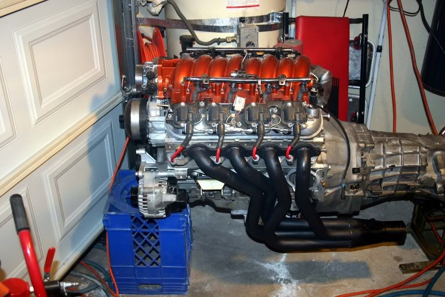

be sure to post up with results if you do do that..
olly
Old Dec 23, 2005 | 01:12 AM
67RSCamaroVette's Avatar
iTrader: (63)
Joined: Aug 2005
Posts: 1,959
From: The trailer park
here's some photographios...
Here're the new hookers..
Here is the f-body pacesetters, drivers side in foreground, passenger in back..
Here's them on my engine...
Here's it in my car.. note i bent collector inwards, the hookers are already the proper angle...
Couldn't be better fit if they were made for the car.
Got about 1 1/2 inches from the floor, 1" from the subframe..
Oh yeah, i'm running the S&p style mounts, too..
