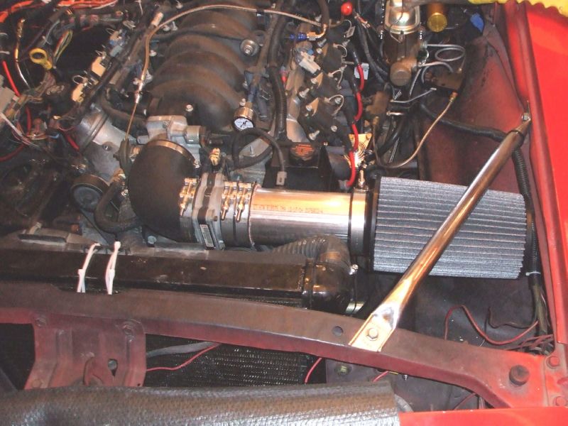

I got mine from intakehoses.com, part # 90HL40R35 Reducing Elbow 90 Degree 4inch ID to 3.5inch ID $16.70. The setup pictured below is temporary until I figure out where I'm going to get cold air from... my current thinking is cutting a big hole in the core support, adding another bend at the filter, and creating an air box for the filter. I'd really like to come up with something slick using the cowl induction though.
