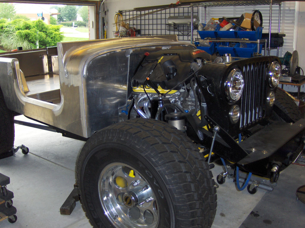

Nice project. What headers are those?
Originally Posted by TomH
Big tires, big axles, big lifts, and the added weight of cages / body armor will bring the suck to fuel economy. I wouldn't try to justify an LSx swap by fuel savings.
Old Mar 6, 2008 | 07:10 PM
TomH's Avatar
Joined: Nov 2004
Posts: 101
Thanks.
They are the Advance Adapter Slik Fit block hugger headers. I added 3-Bolt flanges and then had them ceramic coated at Jet-Hot.
Additional random pix of the build http://www.hachiya.us/Jeep/WTF-J%20Update/index.htm
It's about 85% complete and almost ready to go-kart. Next week I have to take it to the BMV to plate it so that I can call it a Jeep. Fired the motor by accident (kinda) earlier this week. Sounds good with the GMPP "Hot Cam," but I need to finish the plumbing before letting it run.
