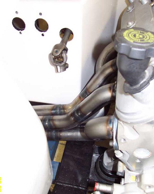

Early Corvette manifolds tuck in nicely and they are cheap. They are also made from pressed steel so they are dead easy to modify. I cut down a pair to make an underbody system for my Cobra. I had to run an underbody system one to get thru registration. The headers and side pipes went on when I got it home with plates and rego label in hand.
Here's a pic of one of my modified Corvette manifolds.
It's not that hard to build you own headers though. I just bought a box of mandrel bends and pieced mine together. Cut the tubes and tack them together. It's like building a jigsaw. I've got soem step by step pics of how I did it somewhere.
Here they are all HPC coated.
With the bolt up flanges inside the guard you can swap the sidepipes round for all ocasions. I built these for the drag strip
Cheers
Michael
