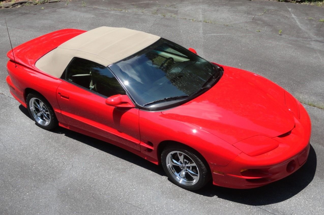

Original top. Photo from July 2023
May 2022. Original top 2007 GT
Oct 2023. Original top 2014 GT

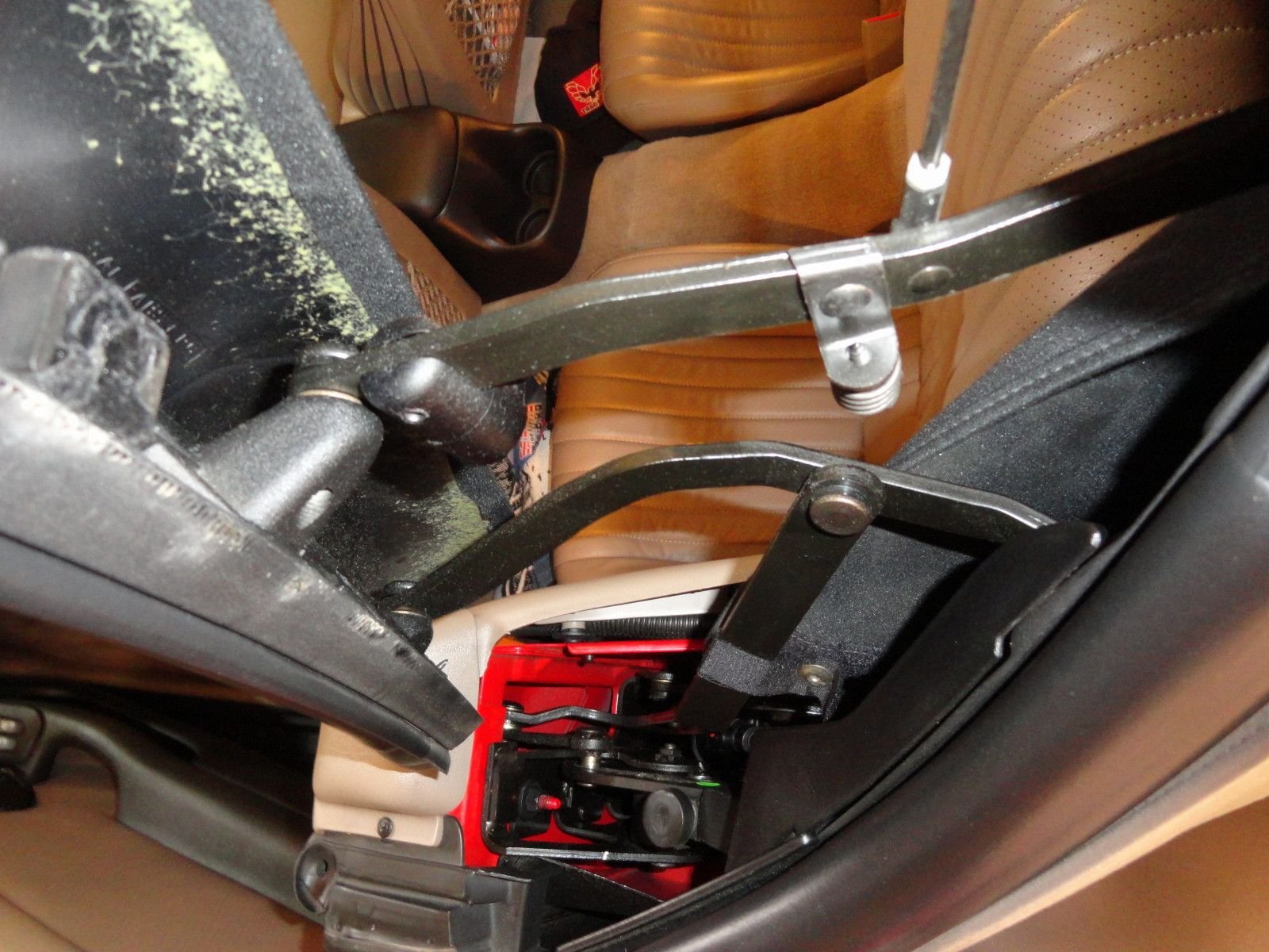

Great information, I have never even thought about oiling the mechanism. Would you please post a picture of the area to oil?
Look at the 3rd photo in this older thread of mine. This area has many of the moving parts. Look for other parts too. I stress to put a towel underneath each part to be oiled to catch any excess oil drops or spray. No frustration this way. Close and open the top a few times to get the oil lubed well in there. Turn the car 'on' so you don't drain the battery too much.
https://ls1tech.com/forums/convertib...ear-again.html

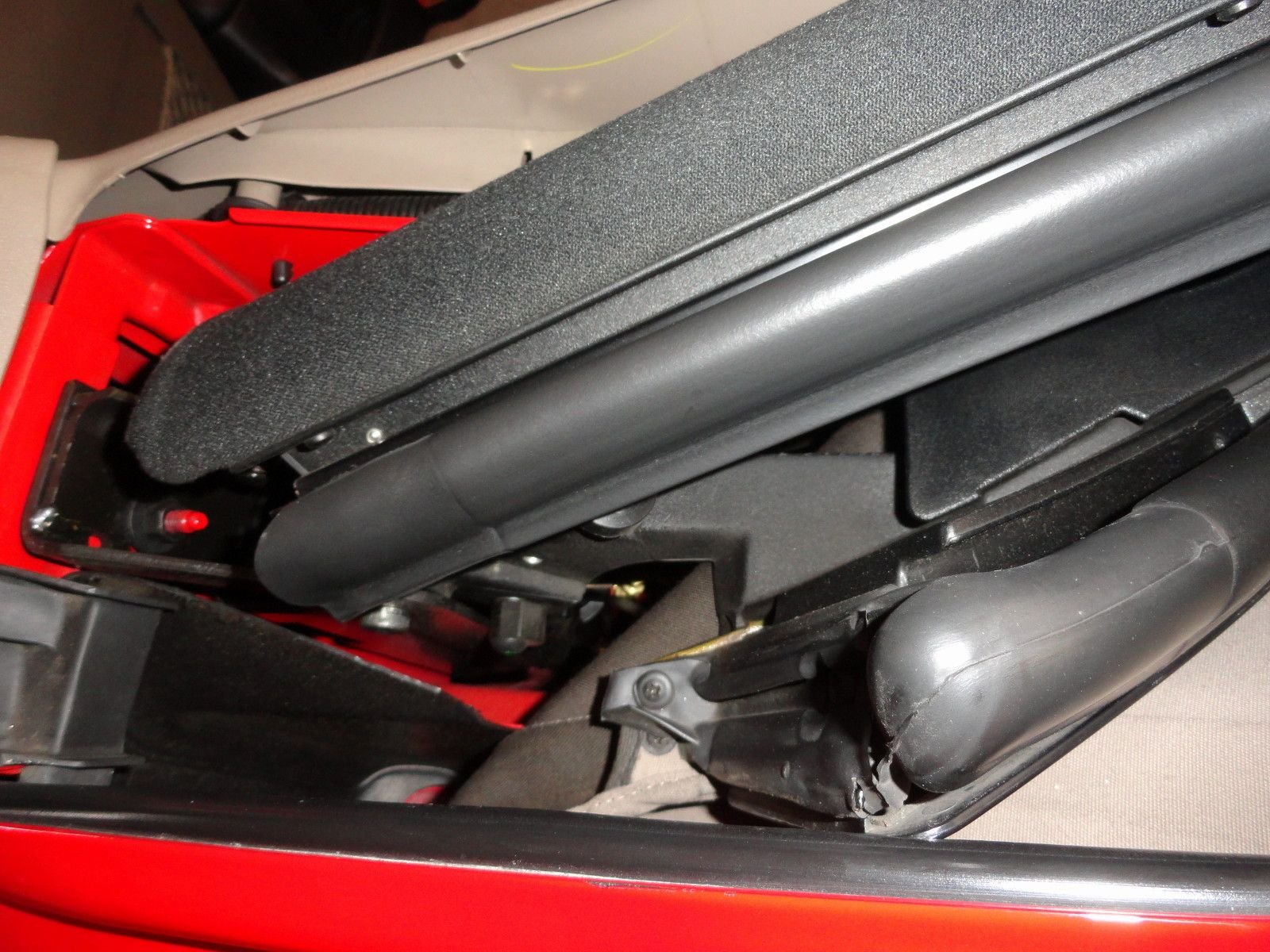

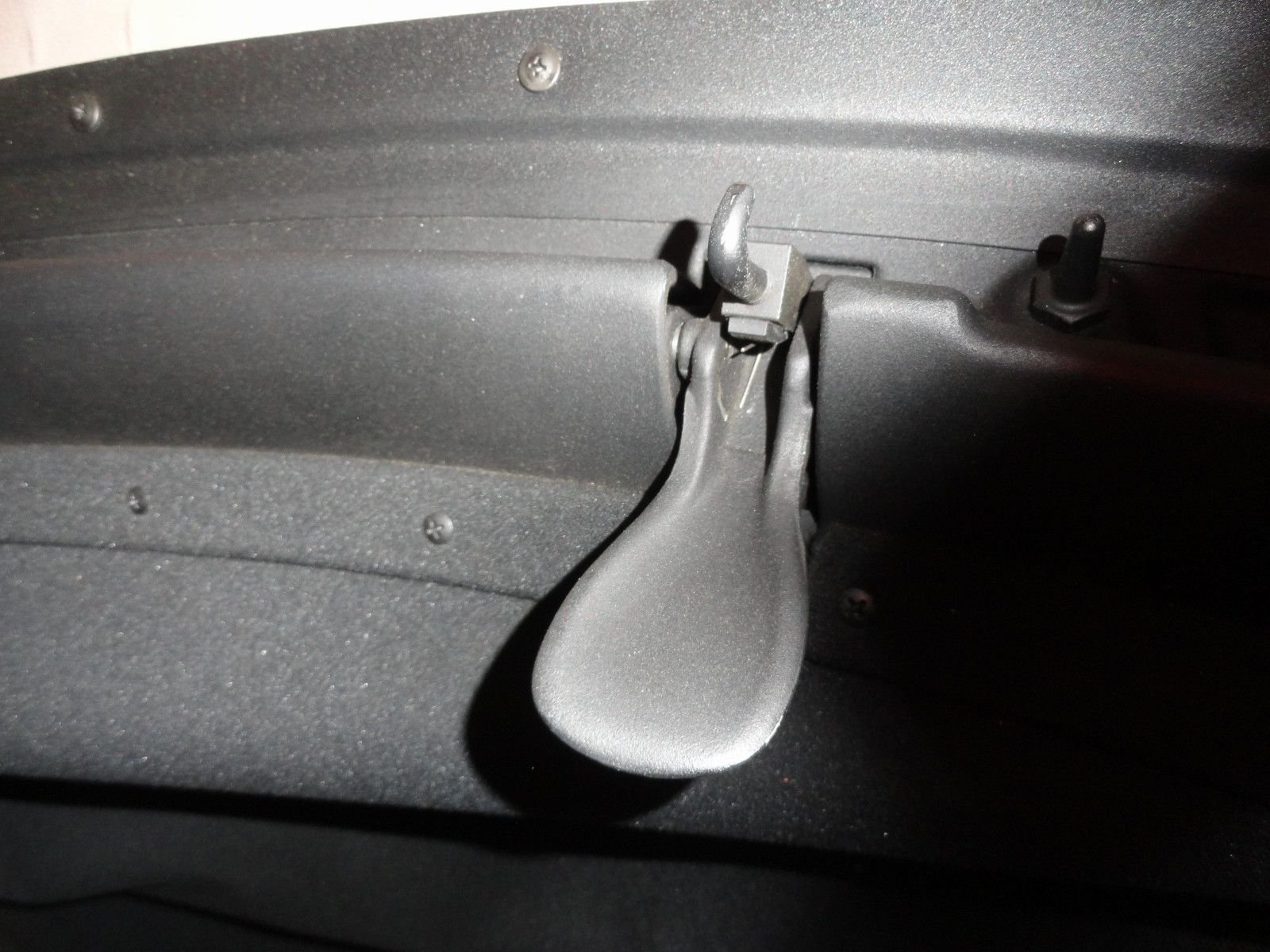

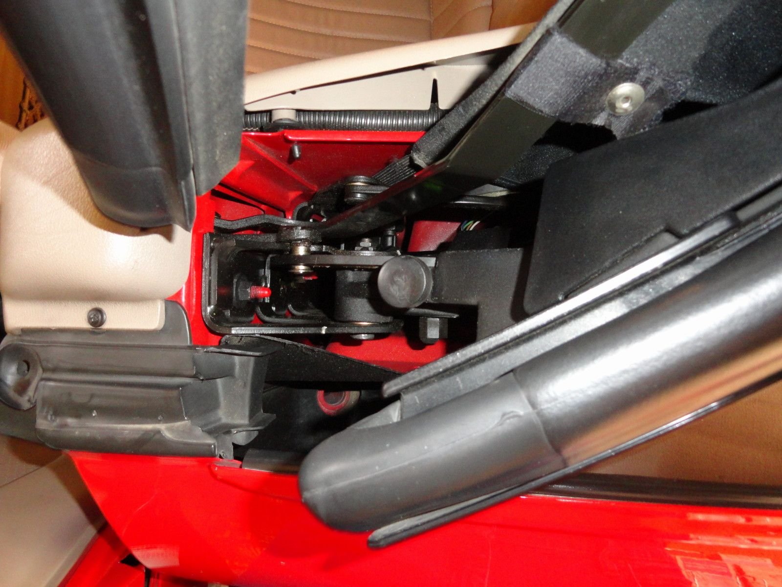

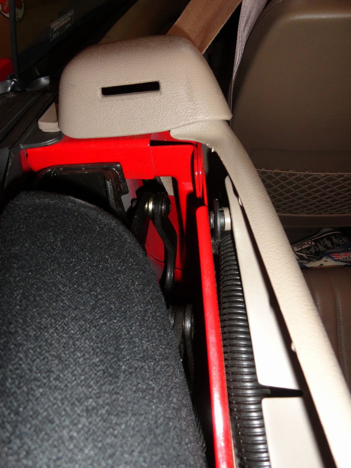

If you forget I'll remind you in the spring.
I figured I better do it now as I'm having some health issues. Who knows. I'm sure this may assist others as well. I wrote a little under each photo.
Perhaps start with both latches up front.
This area is hidden a bit but you can access with a long spout oil can or spray.
You can see all the moving parts and where they need to be oiled.
Another angle
This is with the top partially 'up'. It won't hurt the mechanism for a short period. You can see more areas to oil.
See the paper towel underneath? Easy to place there and catch the extra oil drops. The car still smells a bit afterwards but will air out.
