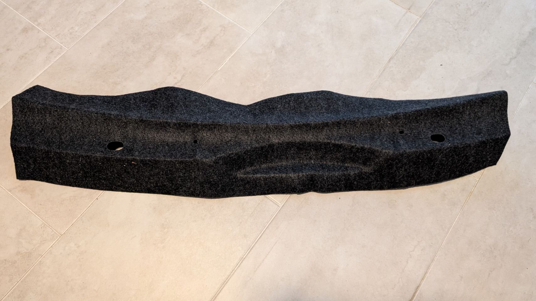

Hello everyone. I bought a used 1999 Trans Am about 2 months ago. Nice shape, but needs some work. 60k miles on it. 6 speed, and convertible. While replacing the shocks in the back, I found THIS piece and I am wondering where it goes?!

Could this be where it goes?!

Yep, this is where the piece goes. I just installed it, confirmed. Strange...

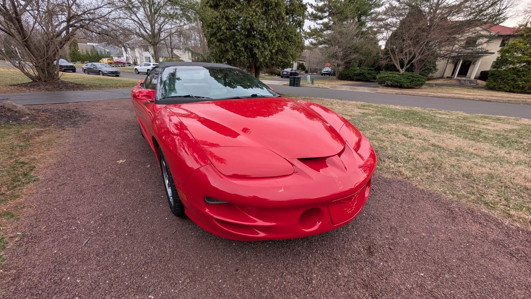

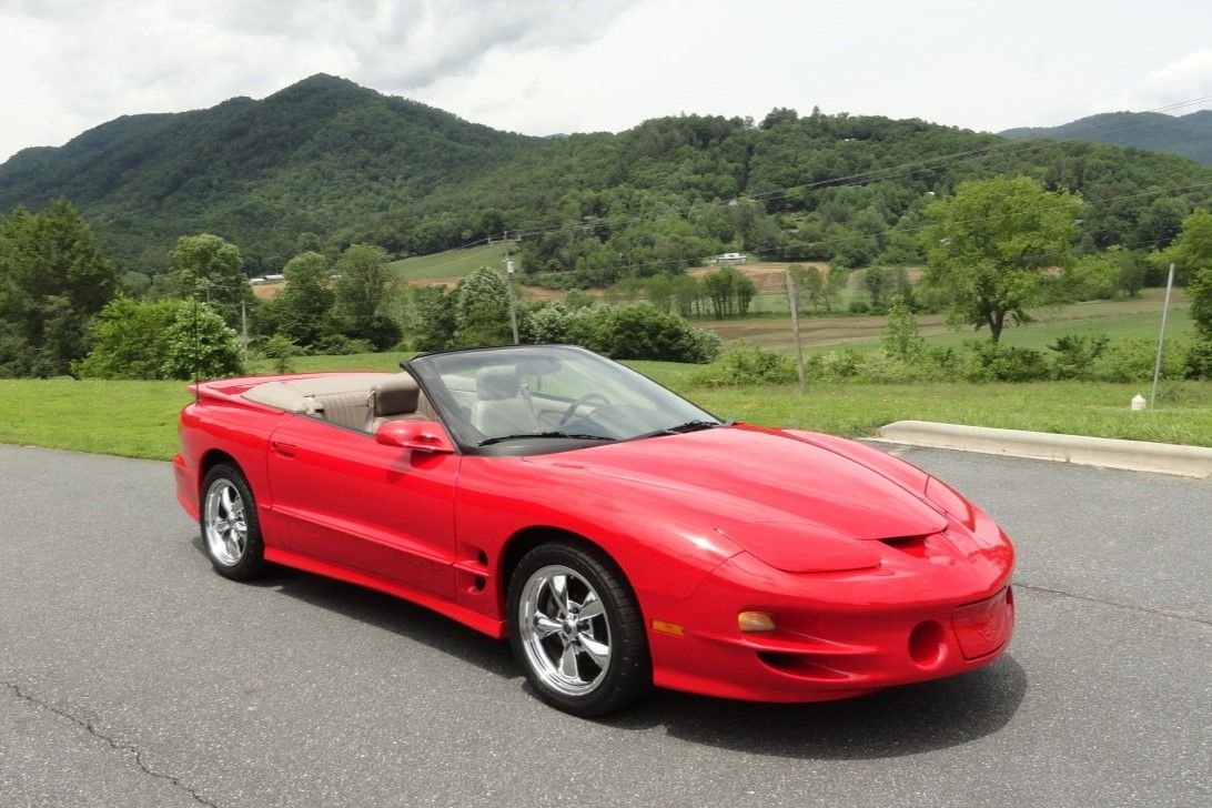

Some clear coat peeling on the front bumper, and a tiny bit on the rear bumper. I will get it fixed eventually.

Thanks for posting the photos. Looks like we have relatives, yours being the older one by two years. It's worth doing the bumpers too. I was tired of seeing the rock chips that accumulated on my front bumper over the many years. It looks so nice now.
