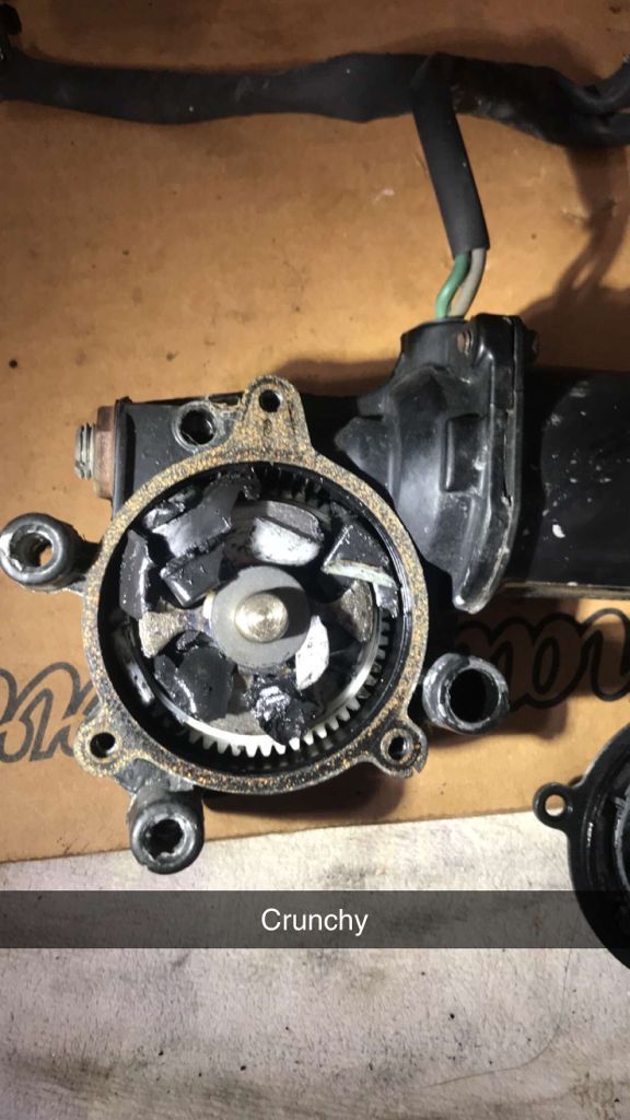

Someone will use this. I used 80% infill PLA and printed at a 45 deg angle. I do not recommend printing at a 45 degree angle. Print it flat it shrinks more evenly. This gear eliminates the vibration damper and needs to be used with the provided spacer.
https://grabcad.com/library/c5-corve...adlight-gear-2
I'm sure yall are ballers and don't need this budget fix but as the prices of these cars fall there may be someone else out there looking to not spend 50$ for a new brass gear and/or not wanting to wait for shipping for the 25$ Nylon replacement/rebuild kit. Mine works by the way. I only have 20 cycles on it so far. Seems to work better as it is broken in.

So I actually initially 3d printed it to last as long as the new one was coming in the mail. Welp, I got the new one in the mail and since this one was working I didn't swap it until it failed
I printed it at a 45 degree angle so it wouldn't be weak amongst the layer lines but the problem with this is it expended/shrunk non uniformly. It was tight on one side and loose on the other
It wound up working for 2 to 3 months before I swapped the one I got in the mail. If you print with it flat I would imagine you would have it last longer than that.
