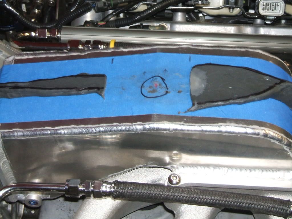

Here's the short elbow, as you can clearly see it hits the hood, circled and that's clay for fitting. Also, as you can see the elbow hits the intake, yes in contact, so rumors about machining of the intake to lower the elbow will do no good, as it will just make the elbow gouge into the intake even worse. Aaron at the link above makes a quality product with beautiful welds and we are going to have him make me a less restrictive quality unit, and am going with a add on Z 28 style scoop to existing hood. Jegs or Summit has a nice bolt on scoop. Maybe Aaron could do a nice custom below the hood elbow for you that isn't so restrictive? Stick with the pros that do it for a living.
I have pics farther along but not ready to post.
Robert

Does anyone know if the gm performance parts intake fits with an elbow under the stock hood?
Old Jul 6, 2008 | 08:43 PM
Robert56's Avatar
Joined: Aug 2003
Posts: 9,557
From: Tacoma, WA
GMPP intake has the exact same issues, sorry. Check out Edelbrock they have a short wide cast elbow but don't know if it will work.
Robert

Will the intake fit without the spacer or does it still hit?
Old Jul 11, 2008 | 09:40 PM
Robert56's Avatar
Joined: Aug 2003
Posts: 9,557
From: Tacoma, WA
No, all test fitment for the hood clearance was done without the spacer. After I found it wouldn't work I chose to use a 1 1/4 spacer for added plenum volume (tuning) and blow off disc for the spray. Actually the elbow hits the intake with no spacer, not very well made as it has a twist in it.
