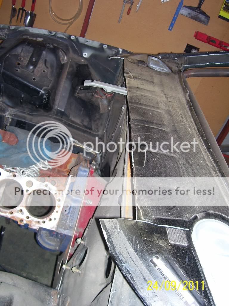

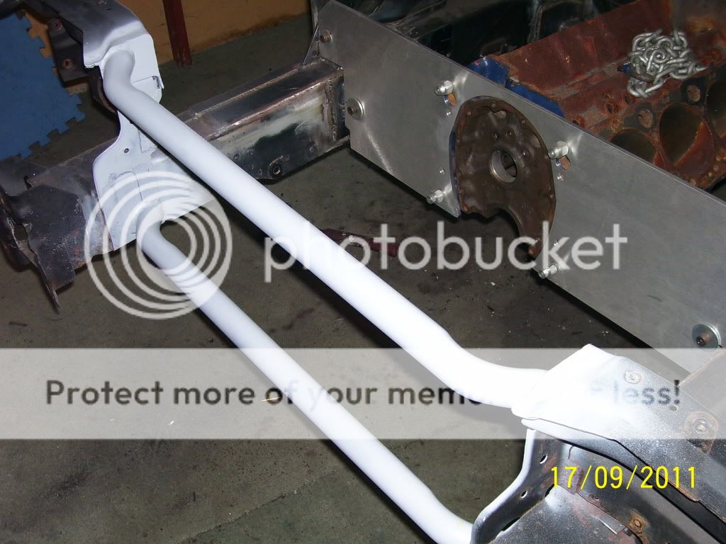

Hey Dennis, yeah still waiting for the mig guide rollers to weld the windshield cowl back up.... have the steel sheet, new wire everything. Just cant do it yet, it is bothering me!!!! I cut my cowl back to here

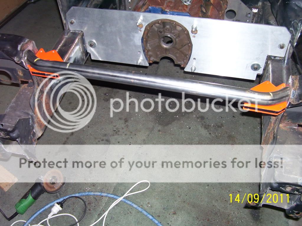

I have the lower rad support fully trimmed now, I will tig the tubes in hopefully tonight... this is the top one ready to weld. Man it changes the appearence of the car!!!

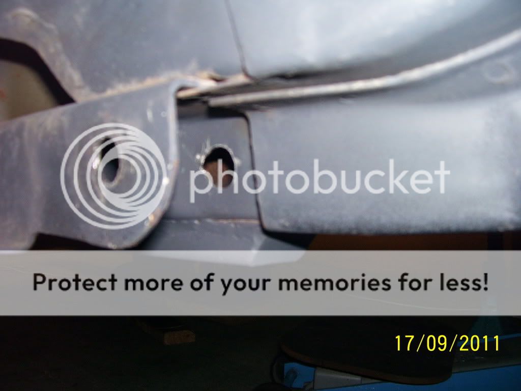

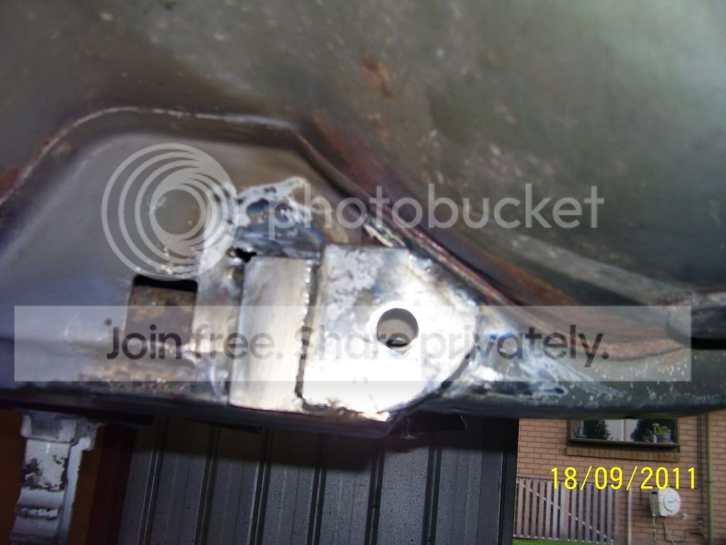

Ok got some things done on the car. Have the radsupport finished for now minus the radiator mounting tabs.
Started to relocate my lower controll arms, got some bushing to make and one tab still to weld, but this is where I sit...
This will give me plenty of room.
My rollers should be here today, but thanks Dennis not sure if im going to cut more of the windshield away, so I may hang off and finish the lower controll arms!!
Thanks for looking, catch ya.

It is well worth the effort!!! They are not quite finished yet, tabs are in but im looking at buying a lathe to turn down some 20mm steel, to suit my new 18 mm hole. Then I'll drill the bar out 1/2 inch and run it right through the rail, to gusset the entire job also will give me a flat seat on the rail side.
The job is well within your capabilities Dennis, if you have all the materials there is no reason that it couldn't all be done in a day!!!
You will also need to relocate your panhard rod, mine was already removed, to take full advantage.

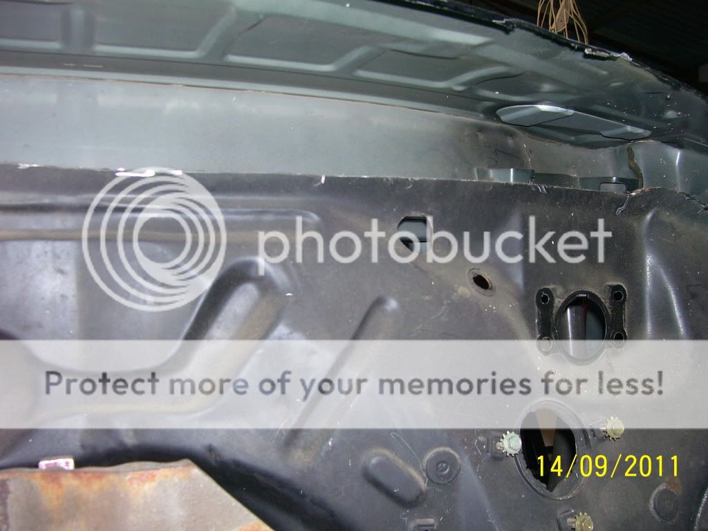

My mig rollers are here.... at last what and ordeal, anyway I think im going to go straight up the firewall, like you said. But I going to fill all the old spotwelds in the bay first. The 0.6 is much better to weld the thin sheet with, should make the job a whole lot easier.

Hey guys, got nearly all the spotwelds filled last night. Man the 0.6 welds nicer on the thin sheet, but fxxxxk it is a pain. It continues to gather up in the machine and you have to keep spoolin it up all the time, 4m of wire lost a time!!! Anyway hope to get the windshield cowl started today. Catch ya.

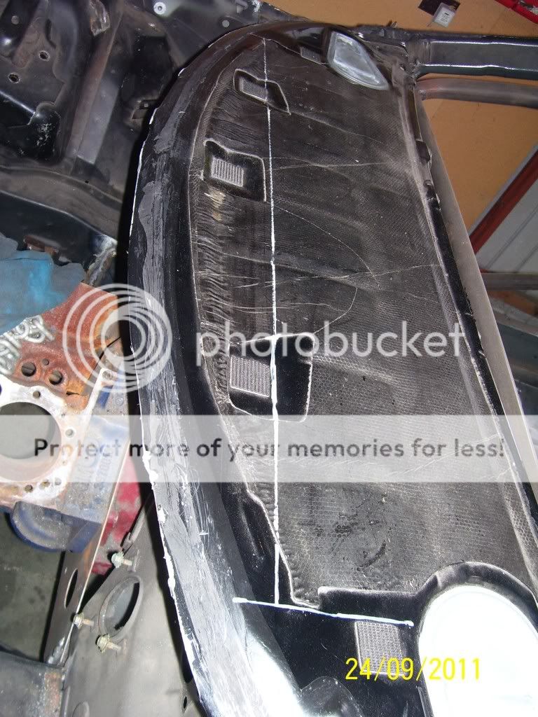

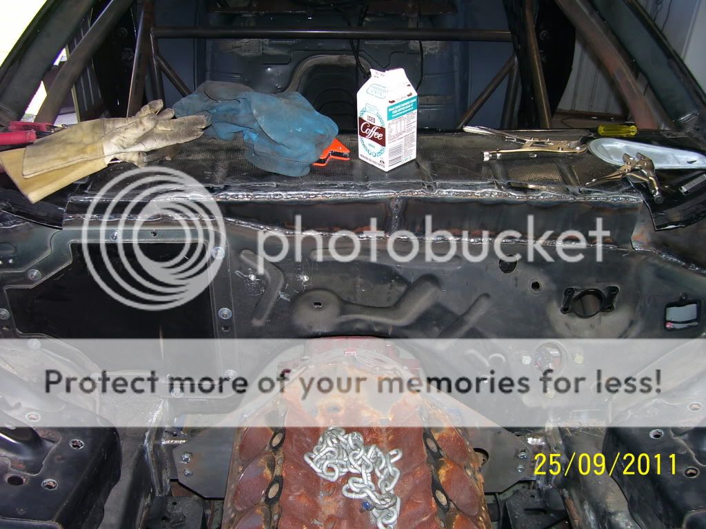

Hi guys, yeah got the winshield cowl nearly knocked off!!!
This is where im going to cut
The support that is left shows just how much was removed
By lunchtime I thought I was looking good
Still had the devil horns to fill in.... man that was probably the hardest part of the job!! I thought it suited the car, and gives it a more nasty finish than beig fully smoothe, like a show car bay.
This is the end result, still need to clean it all up.
Now I can easily remove the dizzy, and I could fit a nice 671
Anyway thanks for looking, catch ya.
