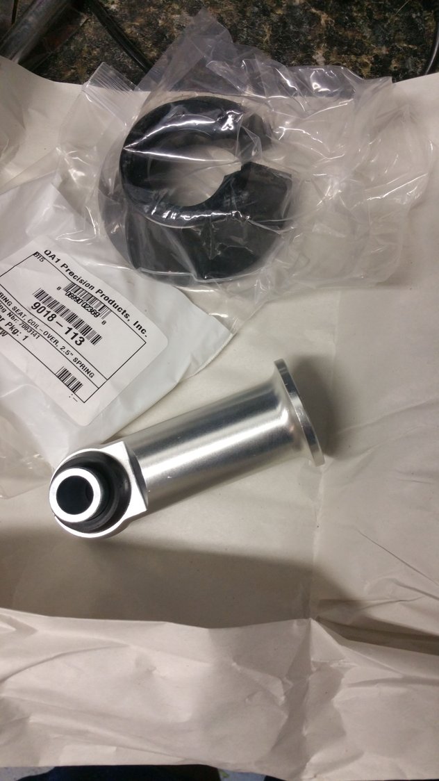

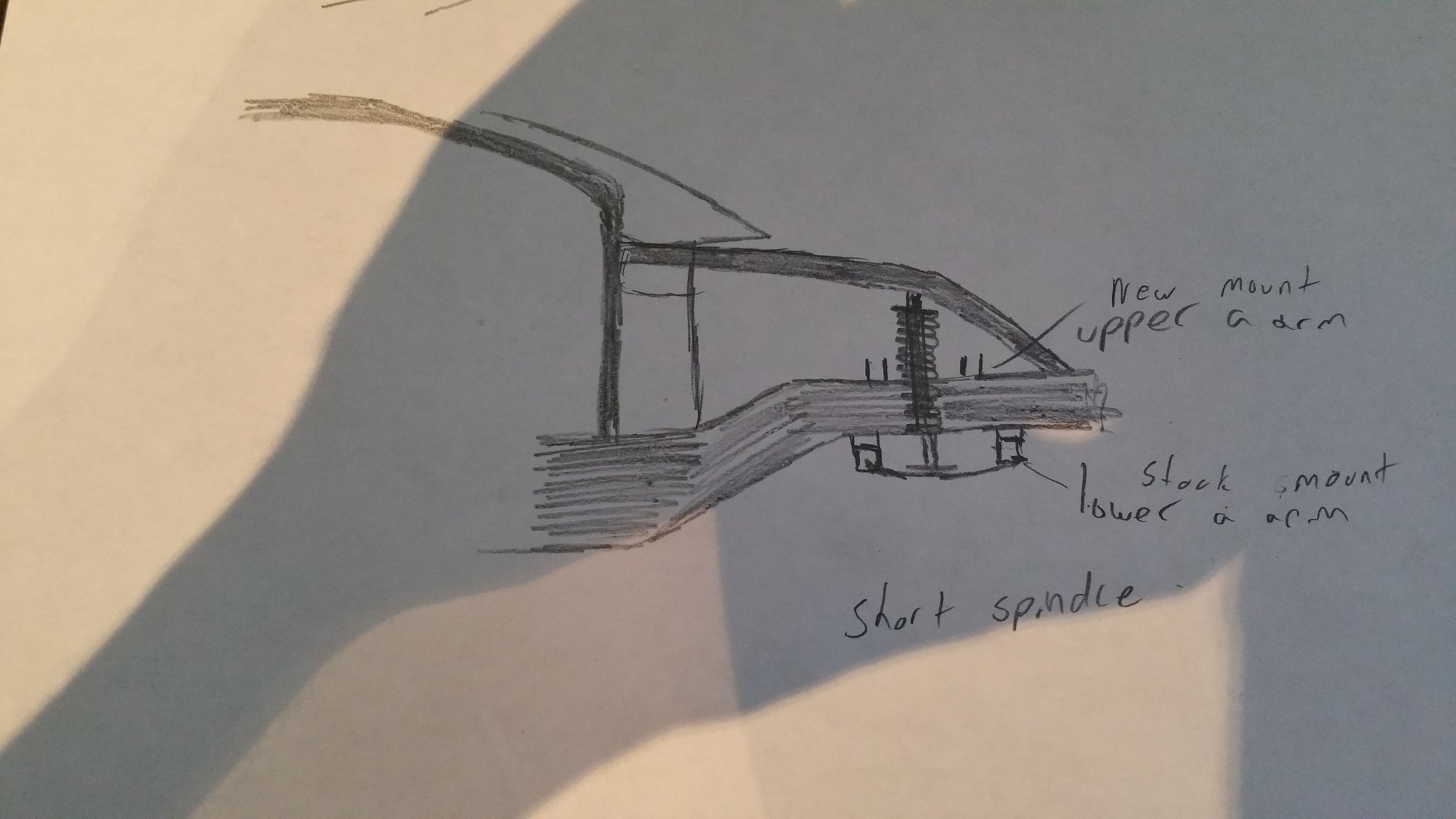

Ok I guess I am deviating from my original plan. I have decided to move the upper a arm down and convert to a C5 spindle and upper aarm. I took the spindle and a arm off my C6 Z51 to test fit and it seems like its going to work and I will loose some weight. I would love to convert to struts, but I don't want to spend all the money on all that goes along with it. I got the C5 parts off ebay for $300 and if I ever convert to a strut, it won't take much and I will be able to sell the C5 parts to recover my money. Also I will have parts from my car left to sell from this so it should come out pretty good.
I will get the weights for the C5 parts when they get here, but it should be pretty close as they are almost the same. I'm hoping the brake bracket from my LS1 brakes will work so I can use my same rotor or not have to make brackets for it.
C6 Aarms are 1lb each lighter than stock uppers

I think when the a arm gets mounted on top of the frame. It will be about right.
This is the angle on the stock upper a arm.
Weight of upper mounting plate for a arm. Not reusing this.
This is the shock angle with the lower a arm level.
This is another angle that the upper control arm is mounted at. So it slants out.
