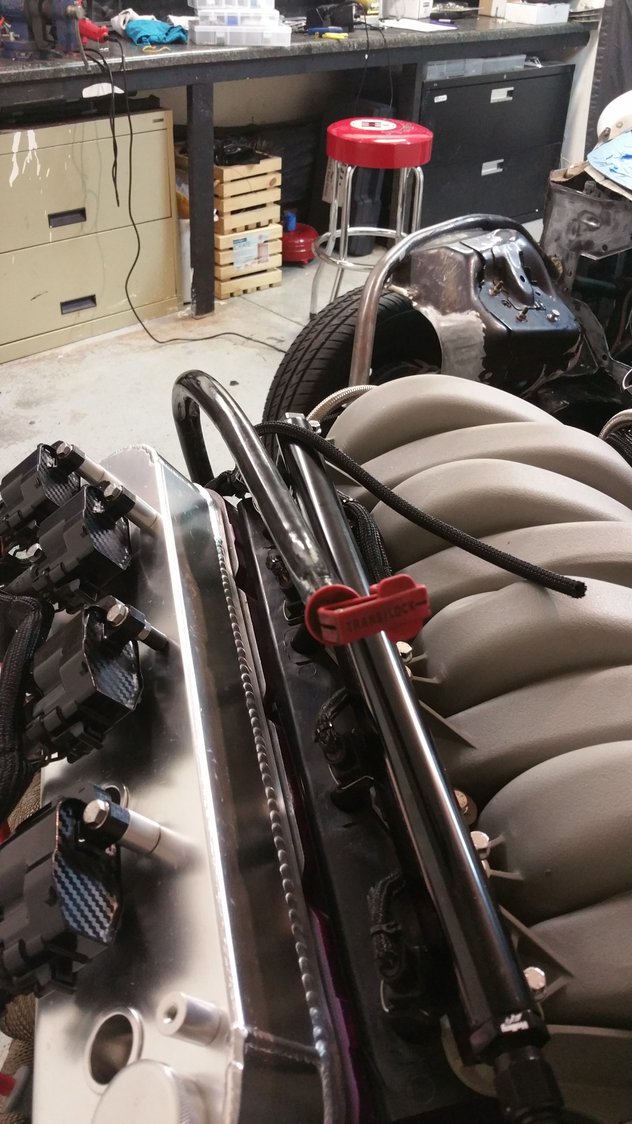

I've been racing this car for at least 12 years and have over 7500 passes on it. It has had a S&W cage with bars ran thru the shock towers. My motor blew a few weeks ago and since I had it apart I figured it would be a good time to do some upgrades on it.
Plan is to cut off all the factory front except the main frame and cut those front cage bars out and have it go strait from the top of the firewall and catch a plate that holds the shocks and then run another tube down behind the shock.
Make one piece front clip and make it easy to work on.
Rewire everything.
Add fuel cell.
I started a weight reduction thread and I guess this one will pick up where that one left off except I am not weighing every single thing I cut out. I am for sure taking it to the scales as soon as it is back together.

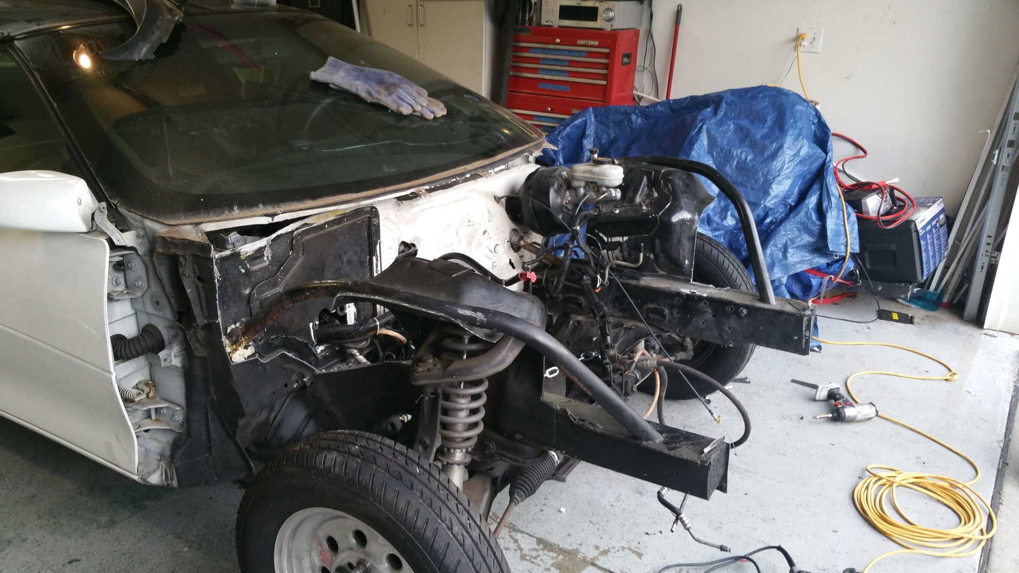

Here is my starting point. Not much left on the front anyway.

Getting started cutting the front off.
It ended up being about 60lbs that I cut out. Of course some will have to be added back. Still got more cutting to do. I want these shock towers out of there all the way. and those bars will be redone.

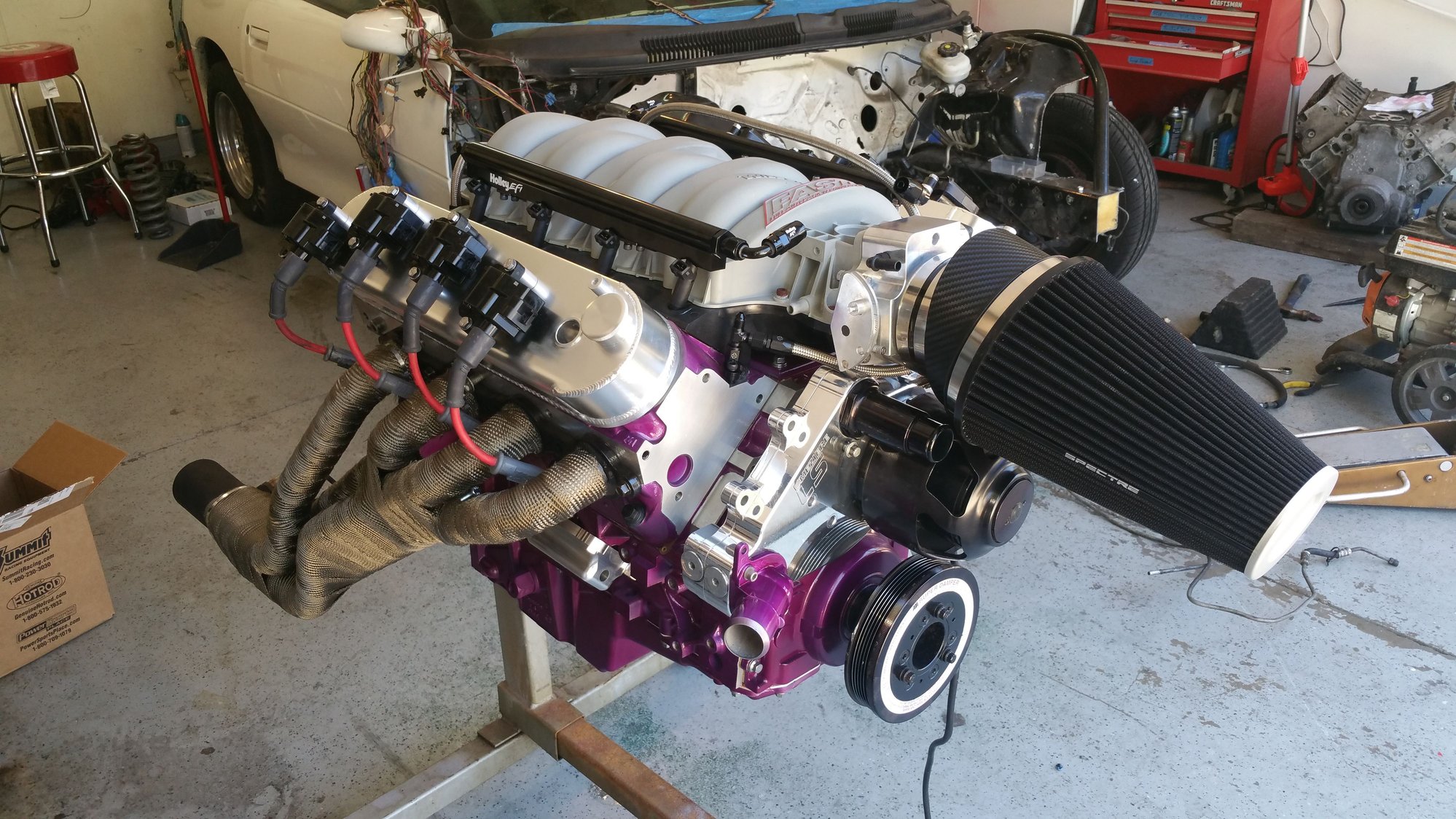

Stock LS1. Going to build something else later, but I'm just swapping over my old cam and valve train for now so I can get this thing back going for now.
ready to paint
Starting on engine harness.

getting ready to wrap headers and clean intake
intake clean and headers wrapped
valve springs being changed
new valve convers

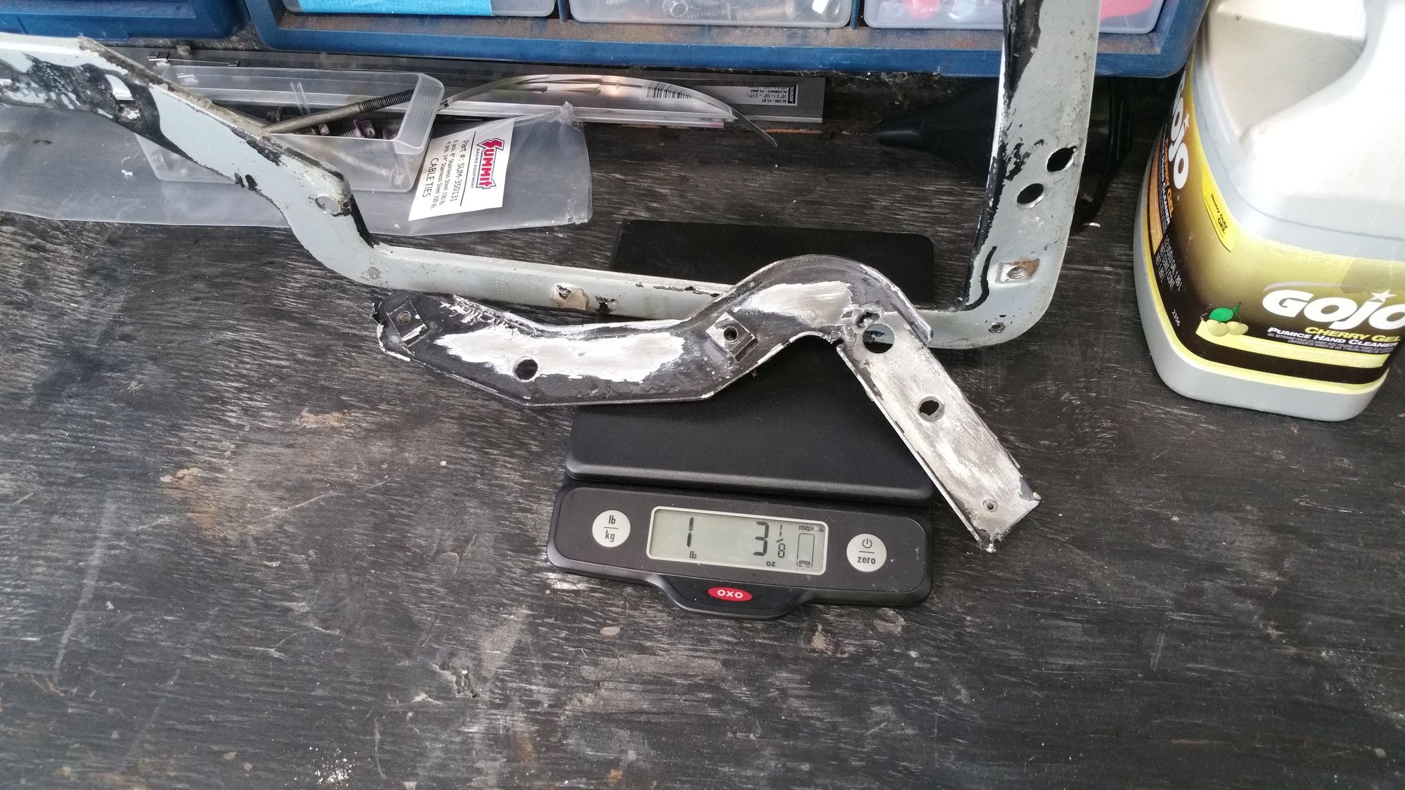

decided not to use coil brackets saved 2lbs.

saved 9lbs 175HT 14'' vs 315 15"

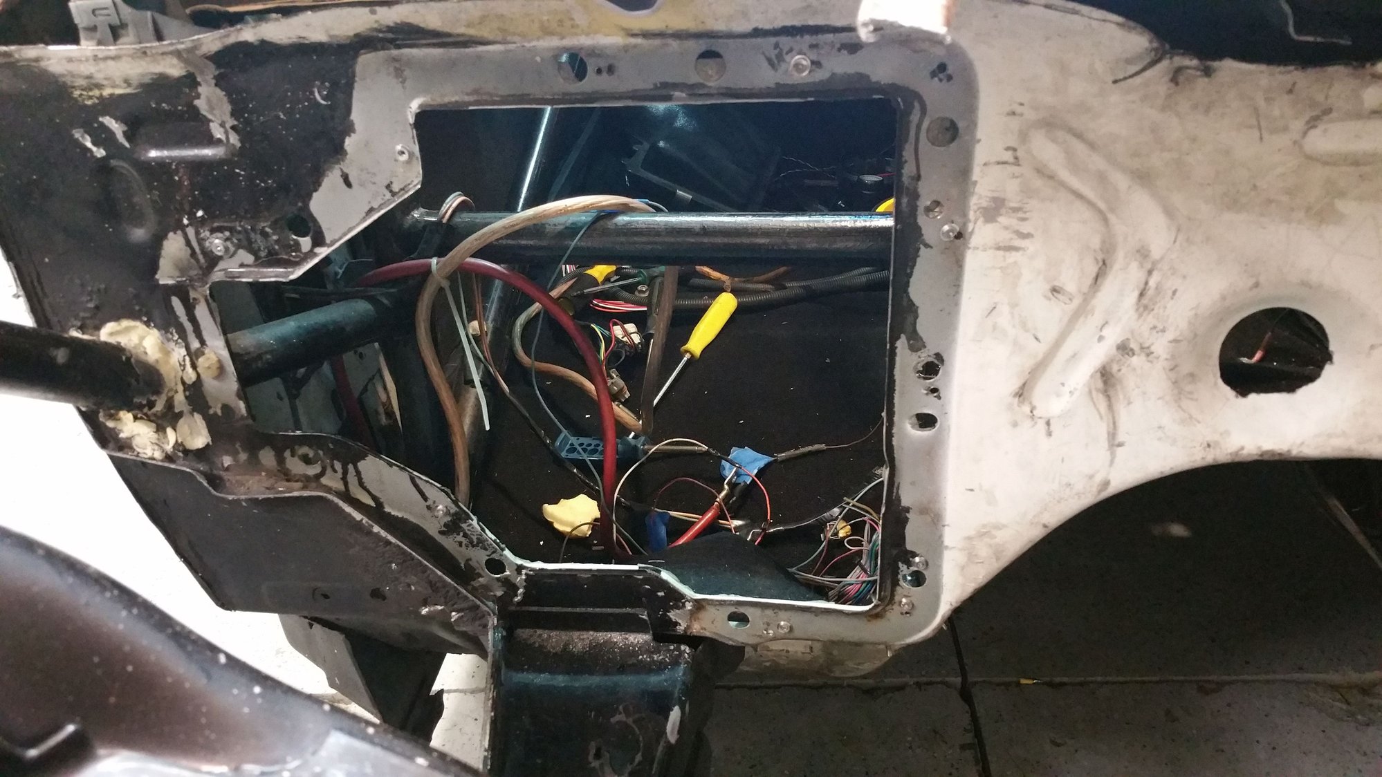

Working on wiring
Injector wires cleaned up. Fuel press gauge installed.

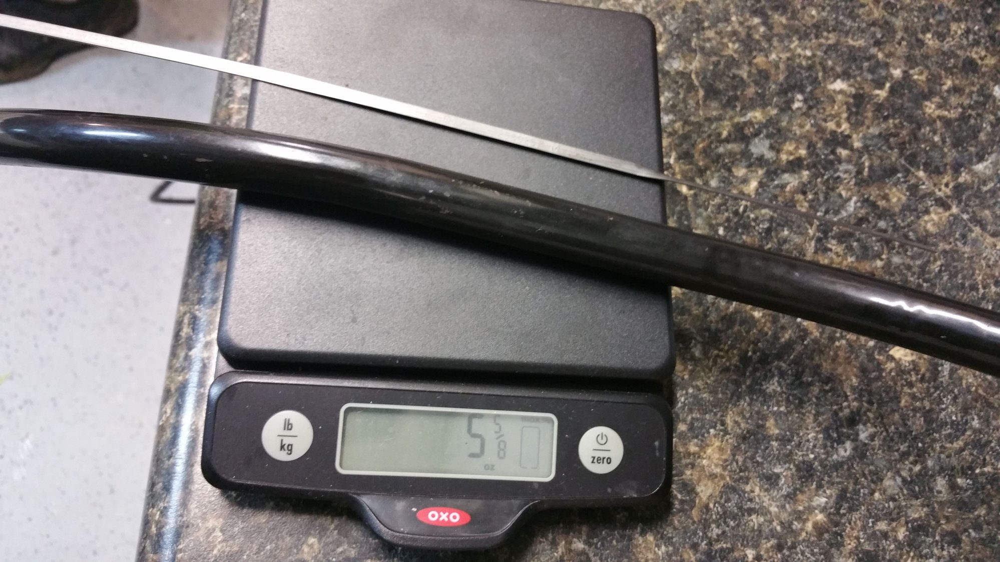

I decided to shorten the dipstick.
The left over parts were about 6 oz. There was anot her small piece not on the scale.
