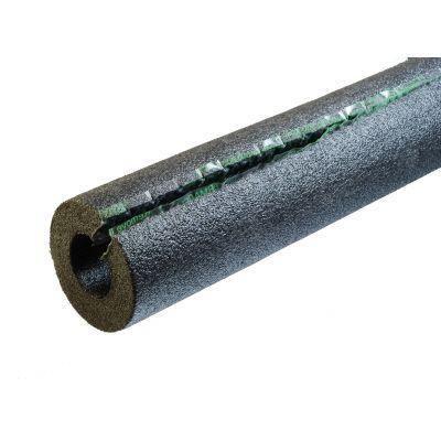

If you would like to snug it up in this situation you can go to any local home improvement store and pic up some Polyethylene Foam Pipe Insulation to wrap around the nose portion of the bumper support.
Other things to try with possible tight fitting bumper supports is to shim the top down if it is to tight.
I hope that helps and we appreciate all the feedback.

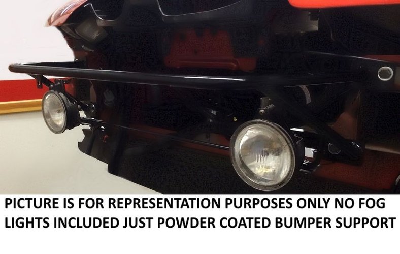

Picture of our 98-02 Trans Am fog light bumper support. Formula looks very simular minus the fog light brackets.
This is our 98-02 Camaro front bumper support. 93-97 Camaro is similar in shape and height.
Good example of a customer using our intercooler version to fit and mount their intercooler.
