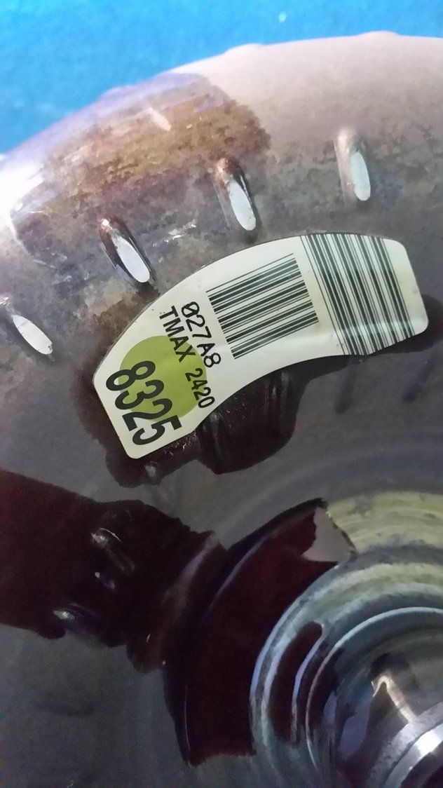

Trimmed up some of my excess wiring, ordered a ac delete plate and got my racestar 92s in, 15x5 and 15x8 set. The new wheels and tires should cut 100lbs from the total weight.

4L60e fresh rebuilt with a 2600 stall.
