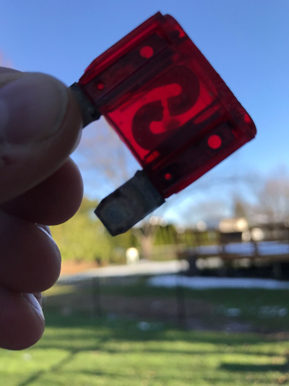

got it! last thing I was checking after replacing relays and ect it ended up being my ignition fuse
