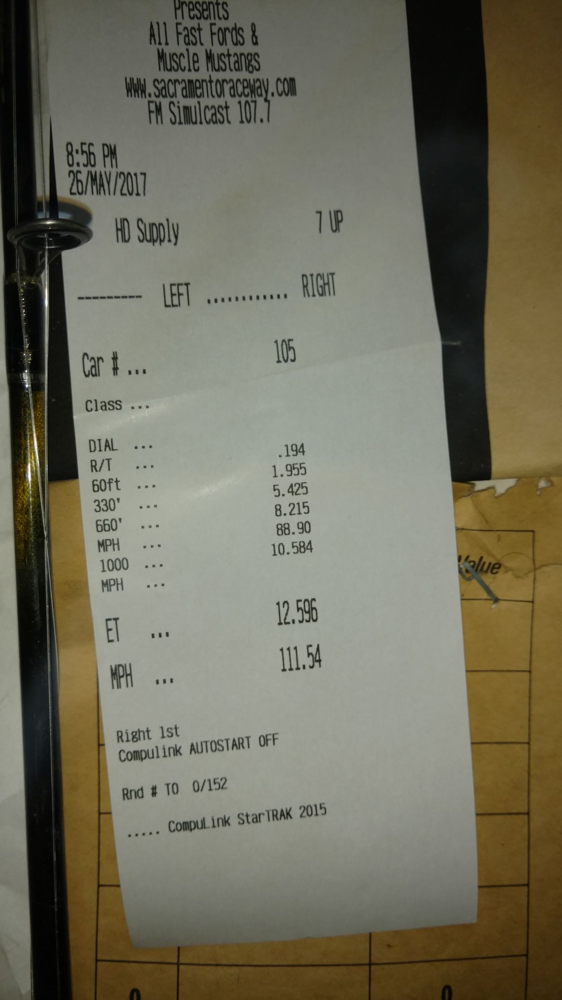

Well nitrous is going to be much harder on the rear end, but it's also the better choice for dipping into the 11's. What kind of 60ft do you pull?
Old Jun 13, 2017 | 01:57 PM
Allstock02's Avatar
Joined: Mar 2017
Posts: 134
Old Jun 13, 2017 | 02:00 PM
HCI2000SS's Avatar
Joined: Aug 2012
Posts: 11,137
Likes: 20
From: Howell & Fenton MI
Realistically I'm thinking a stickier tire and stall, or your current tire and a 100 shot will both get you high 11's

You will be more happy with the stall. It will be there every single time you drive the car. The nitrous, not so much. And this is coming from a HUGE nitrous fan! I think either one will put you in the 11's easily. Are those all your mods in your sig? Weight reduction? That et/mph is pretty crazy for what you have!

Bring down your short times(60 foot) and you'll be in the 11's. Get some better drag radials, Nitto's suck. Have fun.

You're a good 60' away from running 11's, you've got the mph to get there.
You may need better tires and/or suspension work to get it there though.
