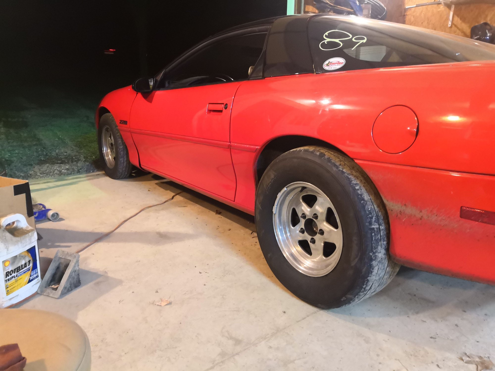

From: Arcade NY
Well I'm a bit of a dummy and forgot to measure where I was at before I started but did the heater hose mod. Driver side from bottom of 15" wheel to fender is 24" pass side is 24.75". Not sure if it ended up being a big difference but I can notice it for sure. And no issue with tq arm or anything all went together smooth.

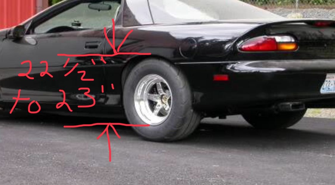

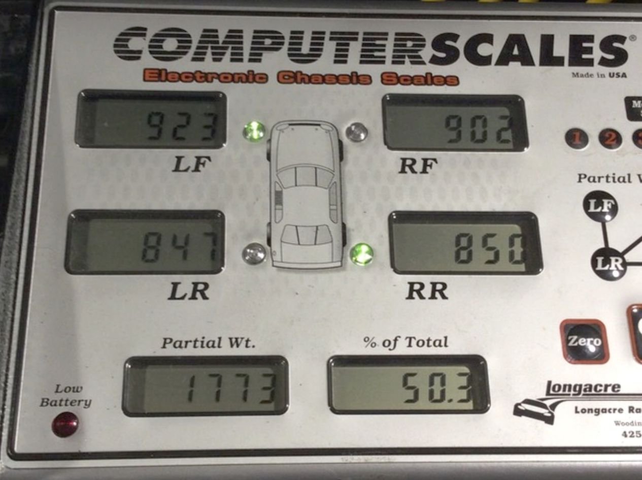

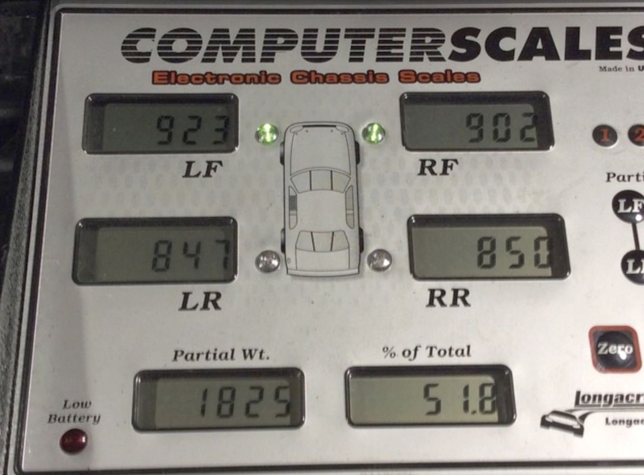

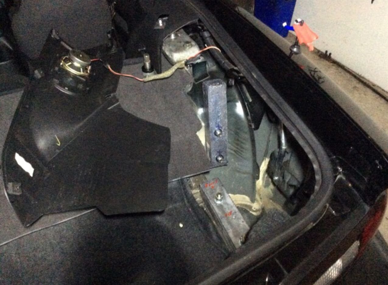

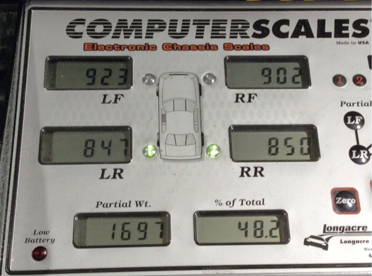

From: Woodinville, WA.

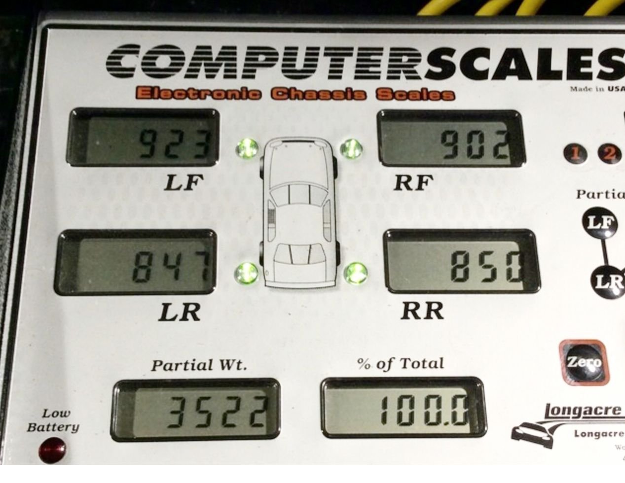

Scale the car. Very import piece of the puzzle. Moving the battery to the rear, worsens the balance. Leave it in the stock location. I didn’t take a picture of my baseline numbers prior to balancing. Here are my after numbers. Car reacts smoother and small chassis adjustments, when made are noticeable. My current final numbers.

From: Arcade NY
Actually just had the car on the scales, good bit lighter than I thought it would be. But numbers are all over, this is with out me in it obviously..
