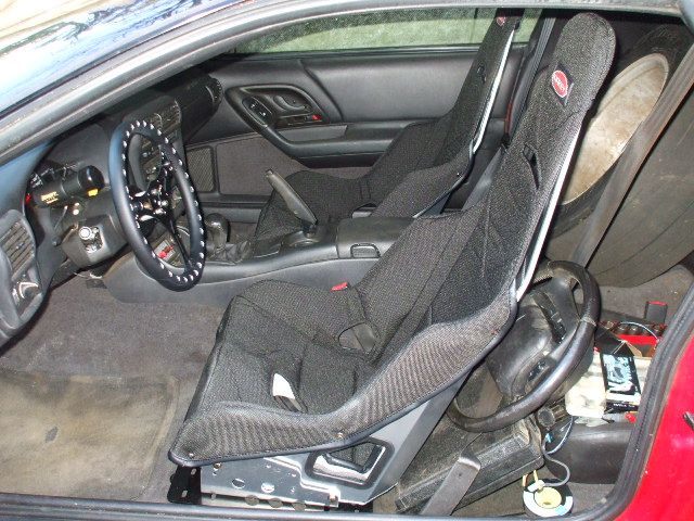

Default Kirkey Seat Install

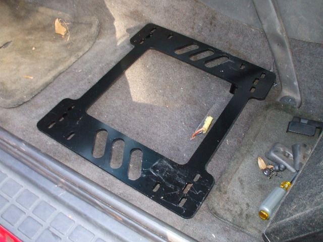

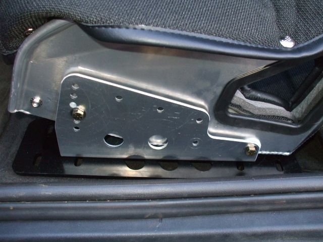

I purchased the seat brackets thru Amazon. These are made from steel so they are a little heavy, but the price was right $108.00. Fit was very good on driver side, but had to use 1/8 washers on front passenger side where they mount to floor. Passenger side was also a little warped and had to rebend by clamping them on picnic table to straiten.
https://www.amazon.com/gp/product/B00QI6TG4G/ref=ppx_yo_dt_b_asin_title_o00_s00?ie=UTF8&psc=1 https://www.amazon.com/gp/product/B00QI6TG4G/ref=ppx_yo_dt_b_asin_title_o00_s00?ie=UTF8&psc=1
Amazon Amazon
Seats are the 17" wide Kirkey Pro Street Series 55 part # 55170. I am 5'7" medium build and the 17" wide is snug, probably could have gone with the 18" wide version #55185. I also used Kirkies seat brackets to mount seats.

Mount seat close to driveshaft tunnel as possible. This will allow clearance for roll bar at door. Some say seats wider than 18.5" are difficult to fit between roll bar and tunnel?
After i get the riding position correct, i will probably trim down the Amazon bracket to make lighter.
