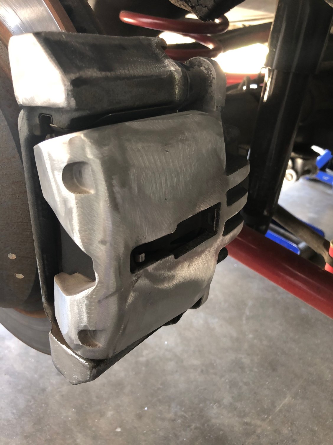

It wasn’t that bad to grind. I just did it this past weekend. I took a 60 grit sanding disc on a angle grinder and about 10f minutes per side and now the 15x10 fit nicely.
Before and after pics
